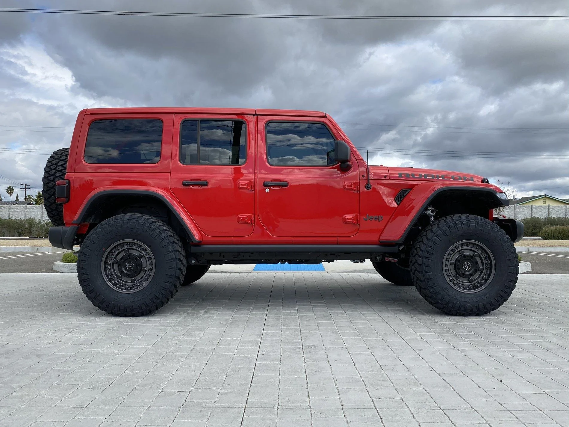

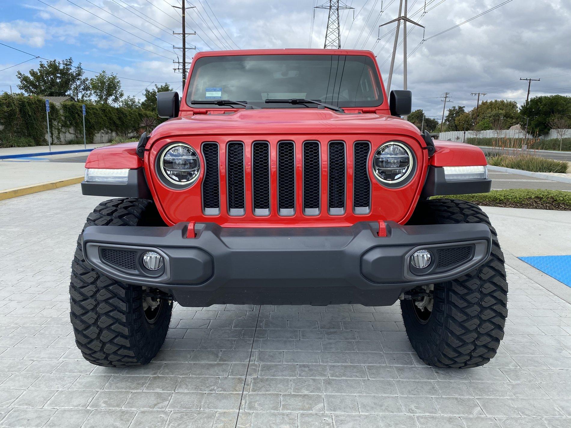

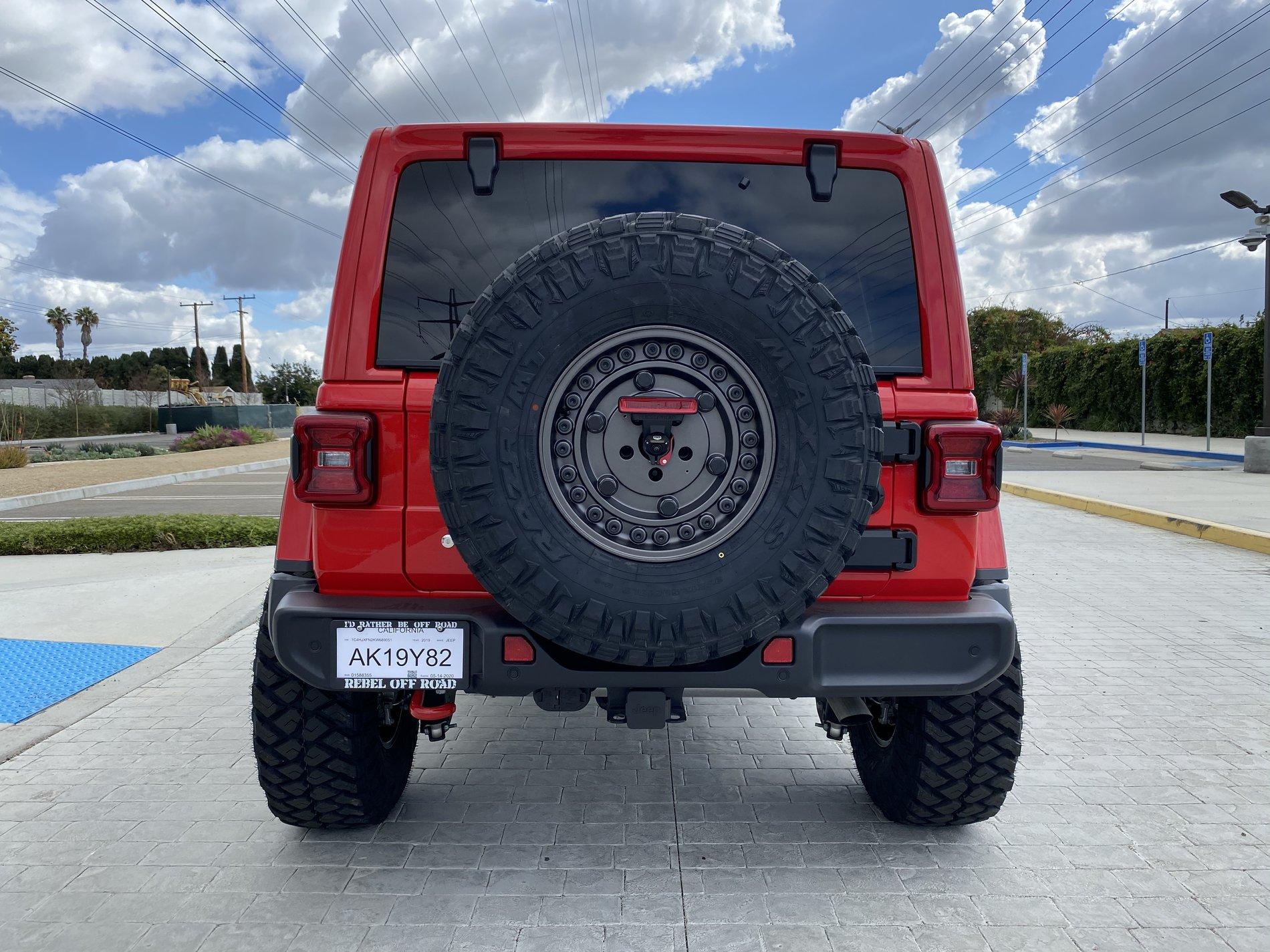

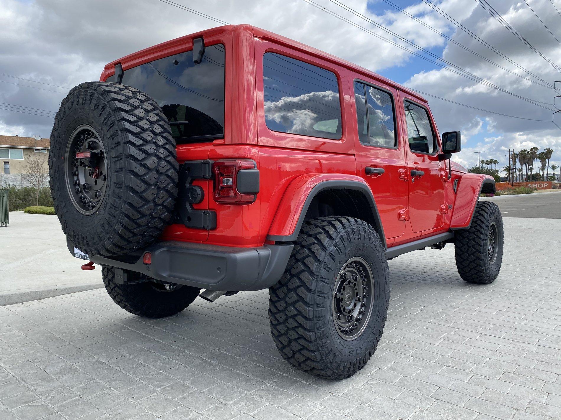

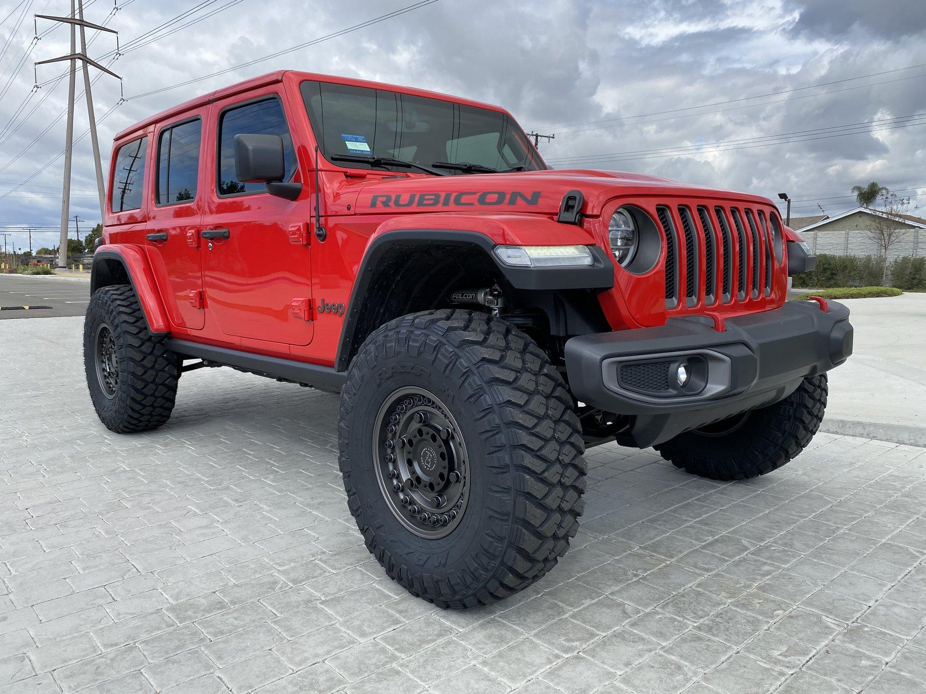

Had a few things installed at Rebel Offroad this week. Loving the way it turned out.
• Rugged Ridge Spartacus hinge casting
• Teraflex Alpha tire carrier

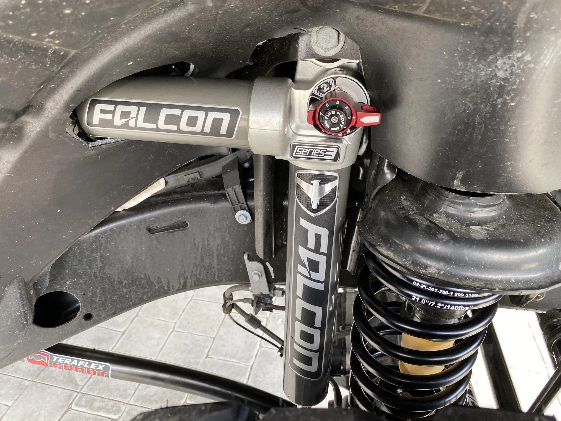

• Teraflex ST2 2.5” lift
• Falcon 3.3 adjustable shocks
• Falcon steering stabilizer

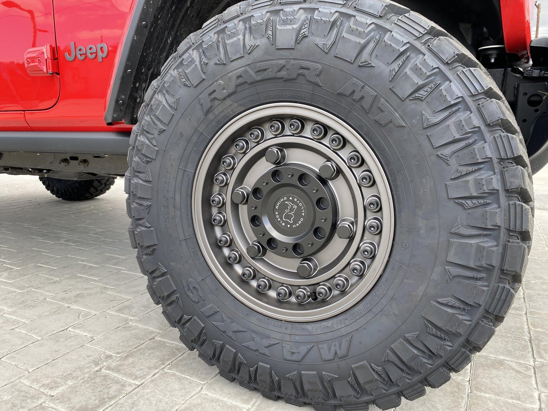

• Black Rhino Armory - 17x9.5
• Maxxis Razr 37x12.5R17

Looks great! I have a similar setup but with the 8 alpine IR arms. The quick adjustments on the shocks are great and simple, plus they look amazing.

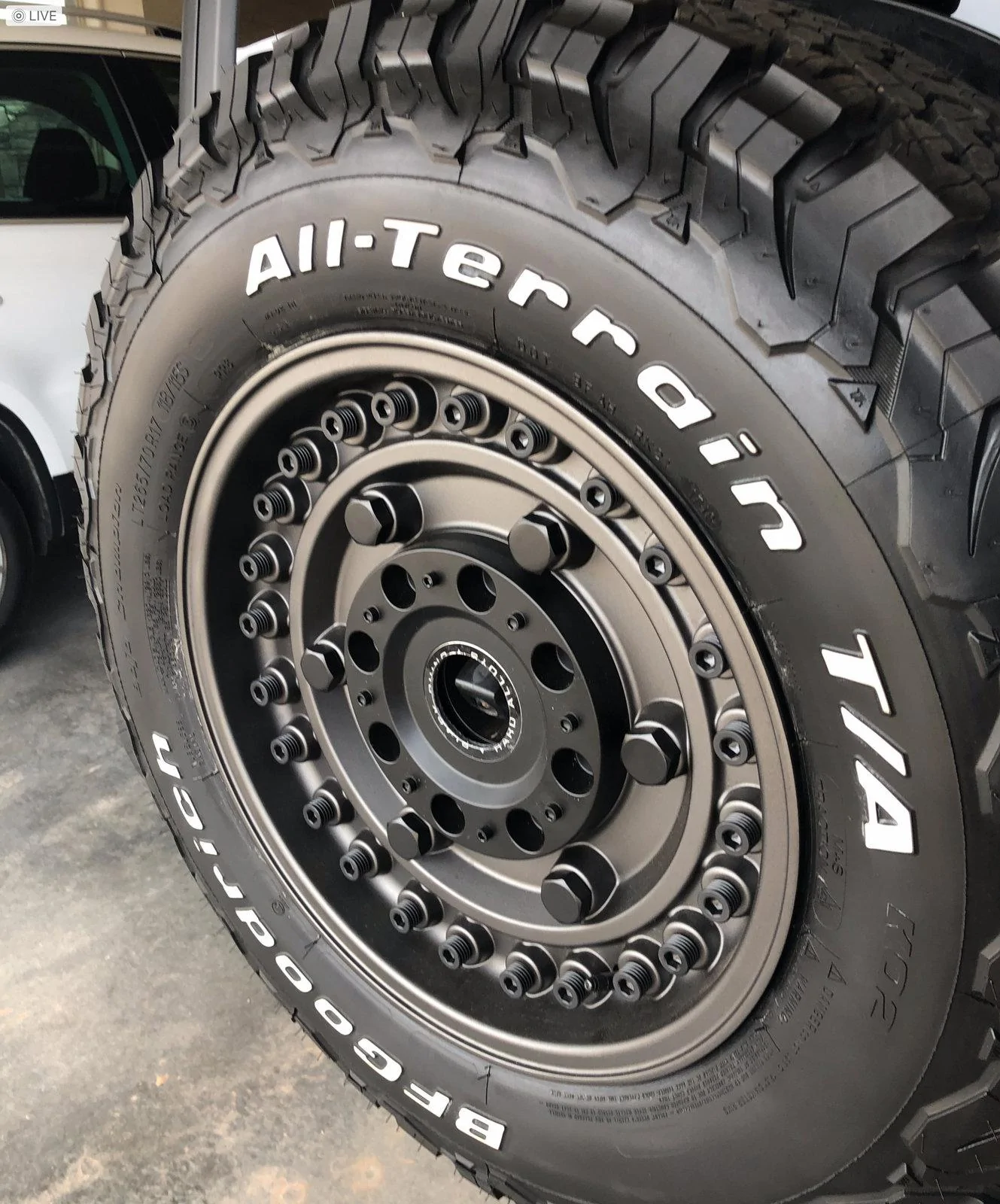

Looks great. I have the same wheels - I drilled the wheel cover for the camera- just a different look

Looks beautiful! The 37’s with those 17 look menacing! Overall, Initial impressions on how it handles after the lift?

The wheel / tire combo is SICK!!!!

Looks great. Might just be the angle of the picture, but that last picture makes it look like the front passenger spring has a slight bow causing the spring to not be centered around the jounce tube/upper bumpstop. This is typically caused when the new control arms rotate the axle and the mopar spring perch isn’t indexed correctly for it.
My metalcloak lift did the same (only passenger side) so I added the rock Krawler correction pads on both from springs and they stand perfect now. Hopefully you don’t need it, but if you do there is an easy fix.

It handles pretty well. Tires are not too loud for MTs. MPG took a pretty big hit though.

Keep us posted on the wear of those rims.... they are definitely one of the best looking but I had read reviews talking about color fade and so on.... your rig really looks good!

No issues yet
