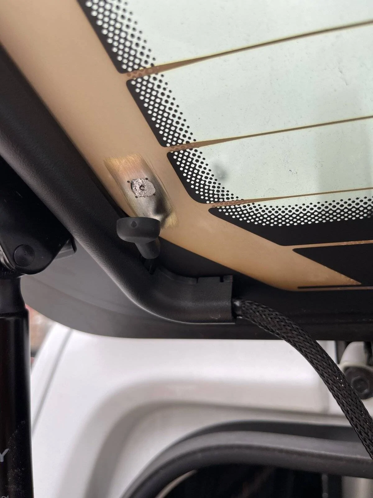

So this broke, window defroster hook up?

I just noticed this is broke. Does anyone know how it’s connected?
Some form of soldering is used to attach it. This has been a common problem, and full glass replacement seems to be the dealers go-to.

Mine broke loose as well. I took it into the dealer and they said the first attempt they have to try and resolder it back on and if it comes loose again, they get a replacement back glass. I’m unfortunately into the second attempt but have not taken it back in yet. Mine will all be covered by warranty
This has been an issue even back with the JK model. If you don't want to deal with the dealer you can try fixing it yourself using something from https://frostfighter.com/
However, if you are still covered by your warranty the dealer option is your best bet.

Hi, same thing happened to my hardtop defroster, I will message you

The cause? The poor connection, with low effective contact area, makes enough heat to soften the solder.
Solutions:
1. Still in warranty? It’s a dealer issue.
2. out of warranty pop the tab out of the connector and reattach with frost fighter silver epoxy. It’s a slow set epoxy that requires additional heat to cure. Read and follow the directions. There’s a decent video on the frost fighter website. Once it’s cured, I’d let it set a couple days before moving on to reattach the connector. You can improve the connection by trimming a sliver of the rubber boot around the tab area, cutting 3 or 4 circles of uncoated foil (copper if you can find it) to go between the tab and connector To tighten it up. A little dab of conducting copper antiseize , like used on spark plugs, in the boot helps conductivity.
3. Best. Change the connector and tab to the improved clip design sold by frost fighter. It’s a better connection and moves the hot spot a little further from the epoxy joint.

Broke on mine too, but I went a full winter in canada without it and didn’t bother me. I get it, factory defect, still in warranty etc but i don’t view it as something worth my time going into the dealership for.
