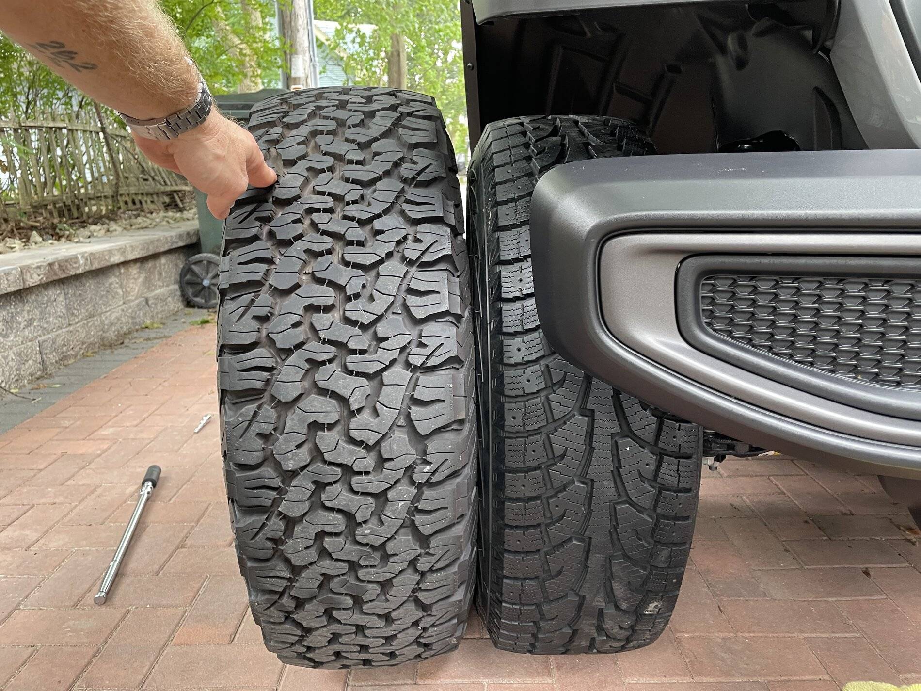

I had bought some Hankook iPike snow tires mounted on separate rims for my past JK Willys for the winter in Wisconsin. The rims came off an old Liberty (I think), so they were 255/17R18 paired with the LSD and a 6MT on my 2 door Willys. Not too much snow SE Wisconsin, but paired with icy roads and slushy conditions they were worth their weight in gold. Having separate rims saved me $ on mounting/balancing and made the swap a breeze.
Compared to any non-snow tire/all season I could definitely tell the difference in acceleration…..but the biggest difference was in the stopping power and turning like many of you have said. Deep snow was amazing. With the crazy amounts of road salt used it also made for slushy conditions most of the time. This is where they really did well with the extra siping. There was less of the “floating feeling” when driving around.
Obviously everyone has their unique driving conditions, but this was worth it every season. I usually keep them on for 3 1/2 mo max then switch back to my regular tires as it warms and snow melts more quickly. It also kept the mileage on them low. I only got snow 4 tires and threw a cover on the spare with factory rim during the winter time

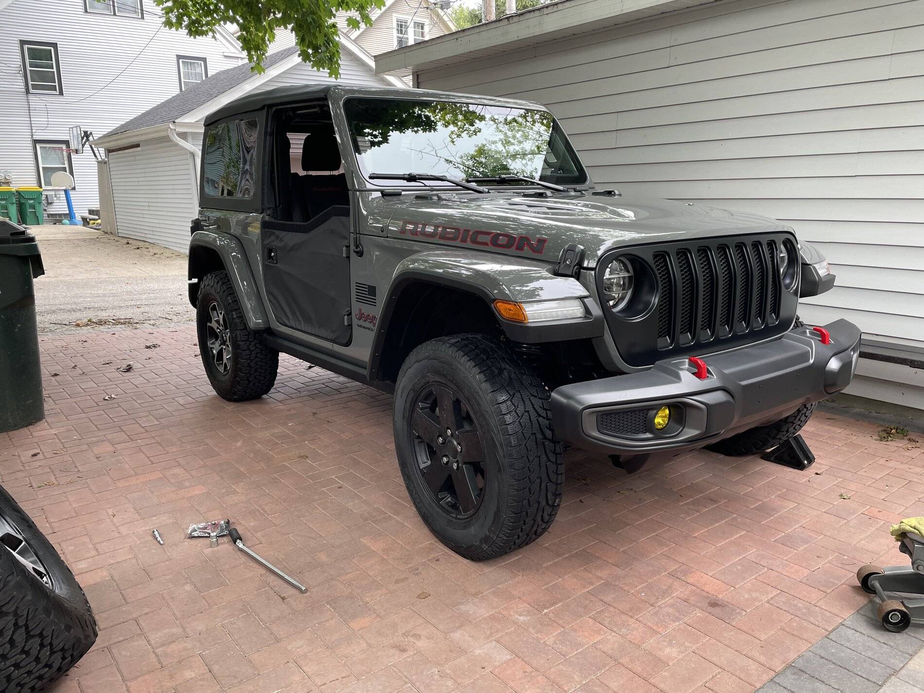

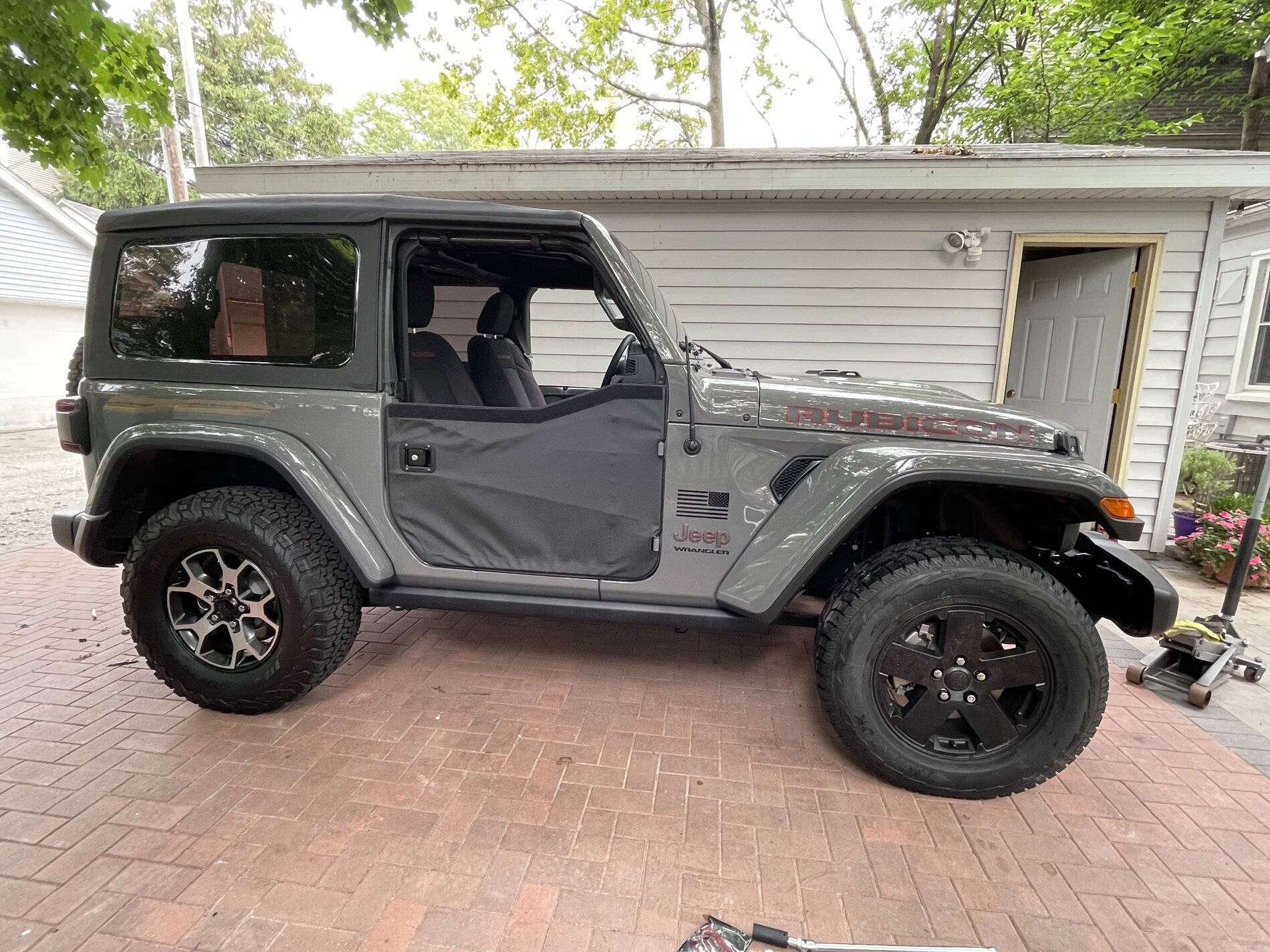

While were on the subject……… Now that I have my JLR with 33s and high fenders. I wanted to check if the rims and snow tires fit, which they do. But as the JK snow tires are 255/17R18 and my new JLR tires are 285/17R17 I was worried on how they aesthetically look on the vehicle with the high fenders. I think they work for a few years, but they do have a “pizza cutter” look (which Im fine with). They still have tread left, so I didnt want to get rid of them quite yet. The pics only have one mounted for fitting purposes.
