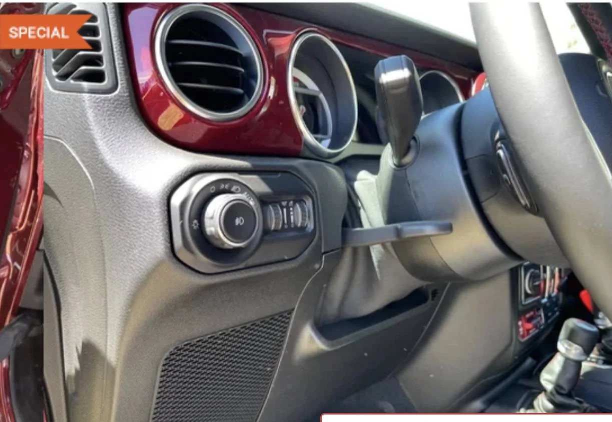

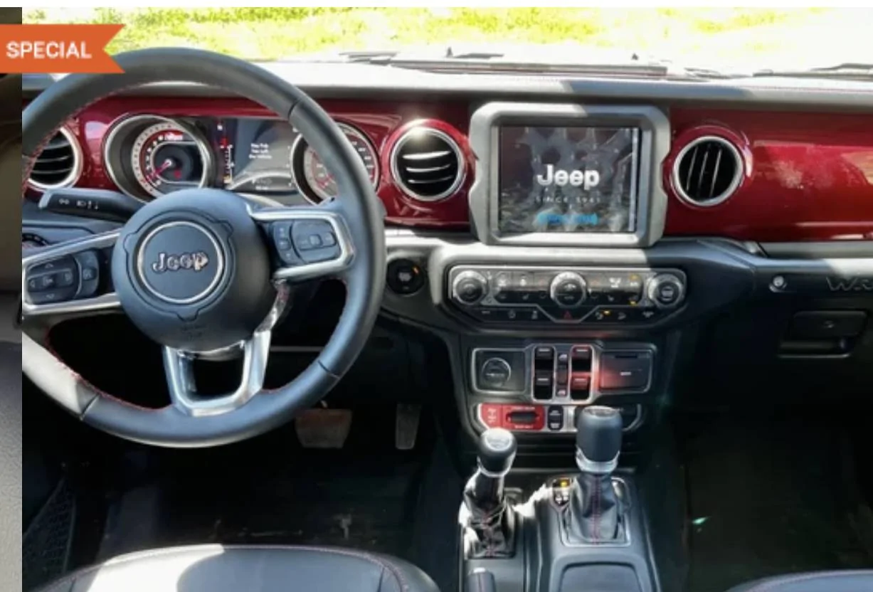

I know some (not all) Orileys auto parts stores can mix you up some paint in a spray can, you get more for your money this way. I’ve had very good luck with my local Orileys color matching paints. They can get the paint code off your door sticker. You can do single stage paint or a base coat with clear coat. I would ask them for a plastic adhesion promoter to spray on before you paint it.I know it's one of the hated colors but I'm thinking of doing color matched dash panels and wondering if it's possible to match Snazzberry.
Hmm, matte, I'll probably have a hard time deciding.I know some (not all) Orileys auto parts stores can mix you up some paint in a spray can, you get more for your money this way. I’ve had very good luck with my local Orileys color matching paints. They can get the paint code off your door sticker. You can do single stage paint or a base coat with clear coat. I would ask them for a plastic adhesion promoter to spray on before you paint it.
Also if you want it to look matte like the stock dash they can put an additive in there for that too. Not my Jeep in the picture, just came across it one day.
