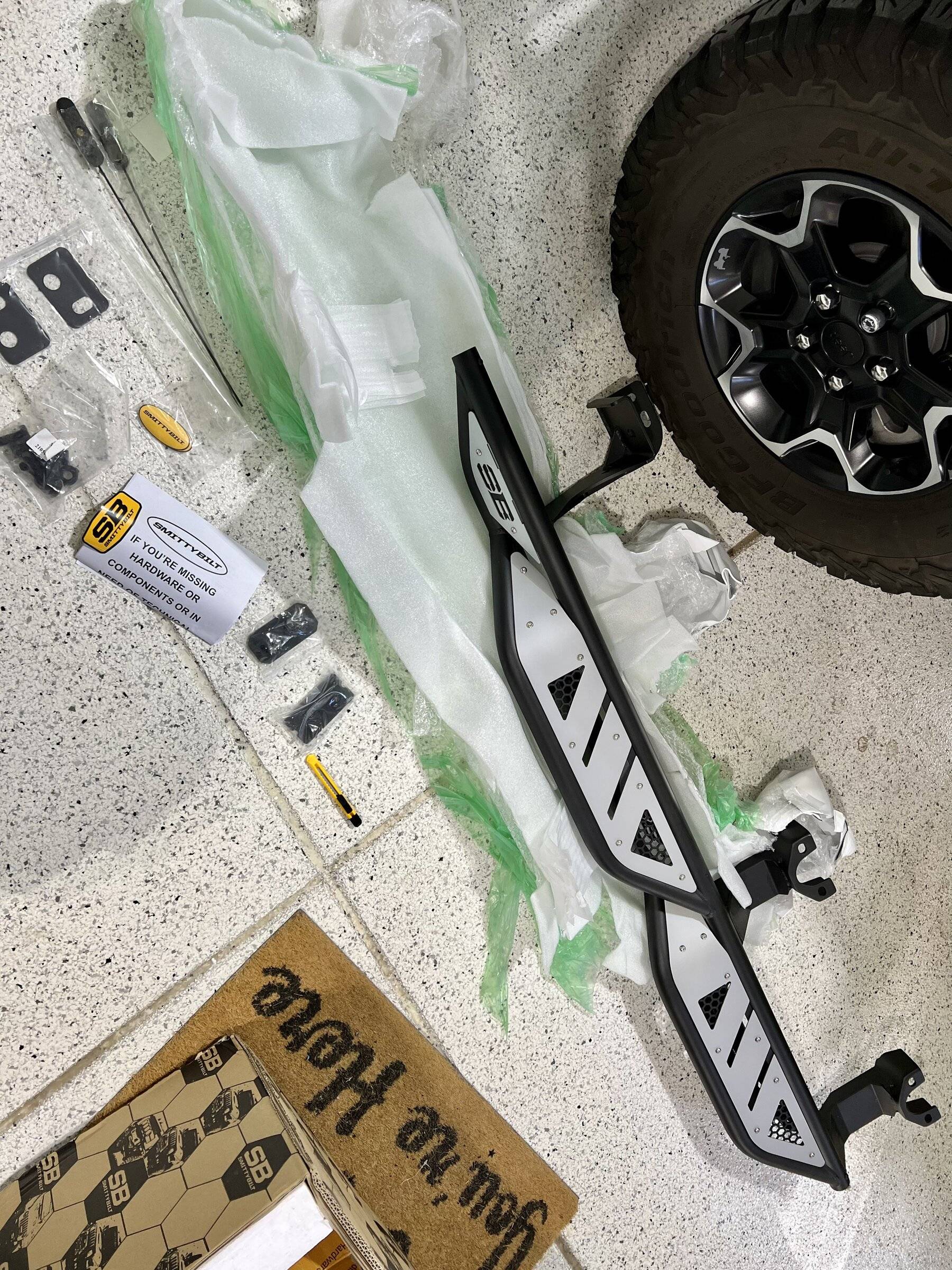

Anyway, enough with the rationalizations. Here’s what you need to know from my unboxing/install experience:

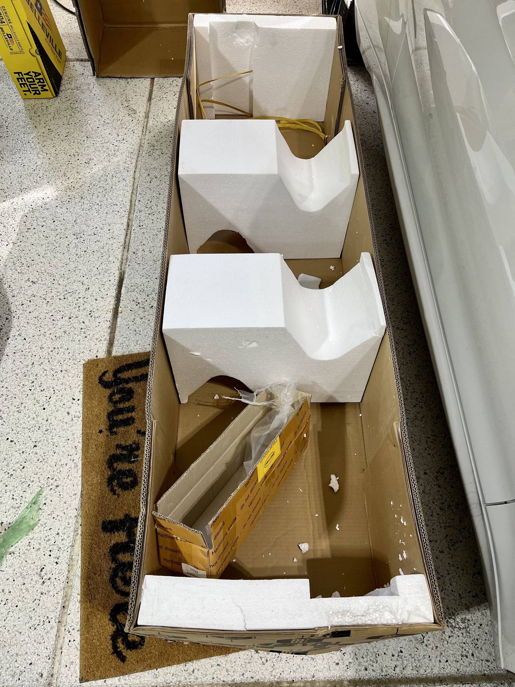

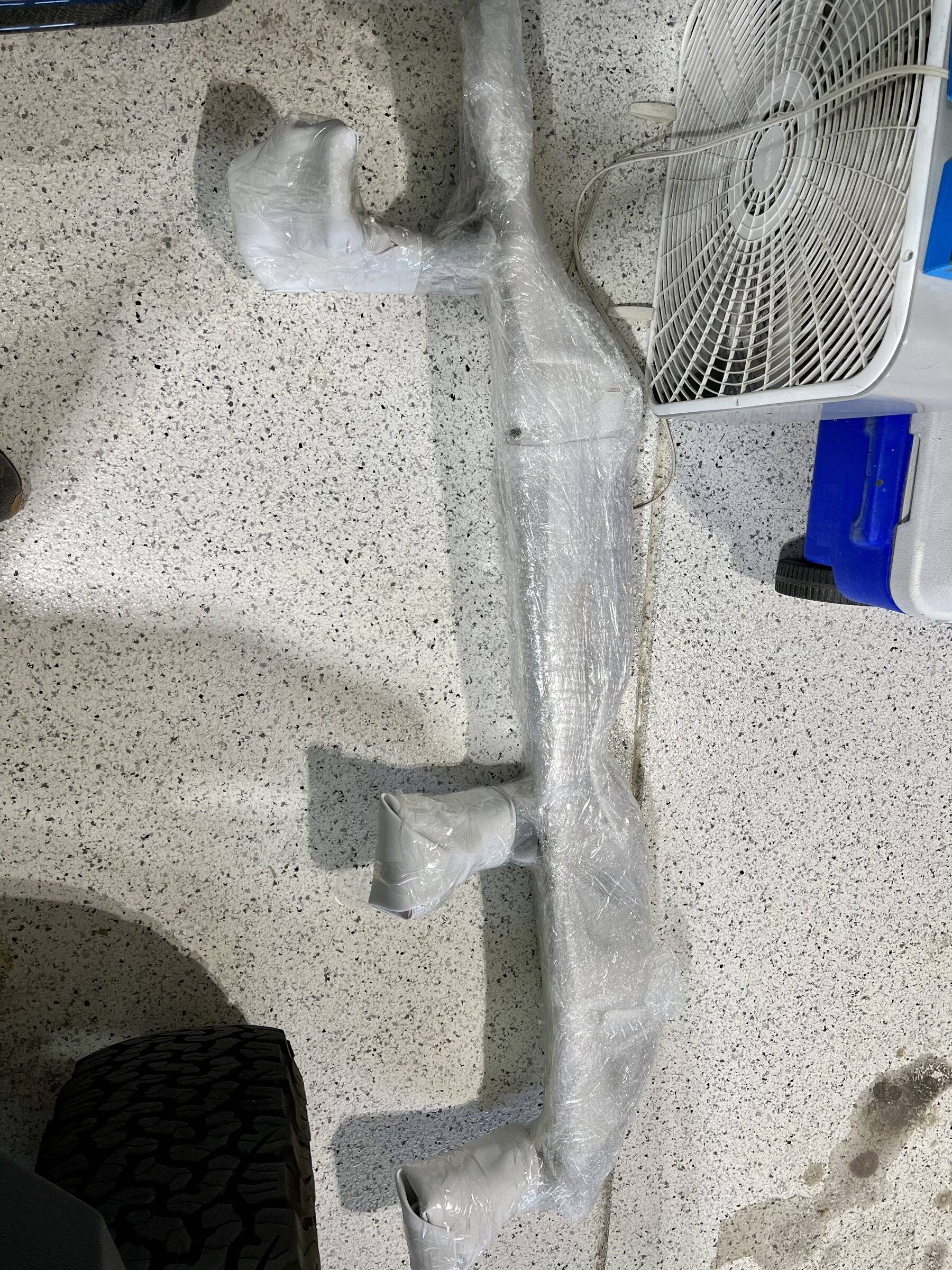

Packaging isn’t terrible. It’s actually pretty damn good considering how it all fits together.
Jeep Wrangler JL Smittybilt Apollo Slider/Steps 7A12C6B0-8C5E-40FF-90E8-F27698326E39
Something I want to draw attention to here is the fact that they actually give a damn enough to verify the parts in your order prior to finally packaging. Not too many companies these days going to this level of trouble to ensure a customer having a hassle free install.

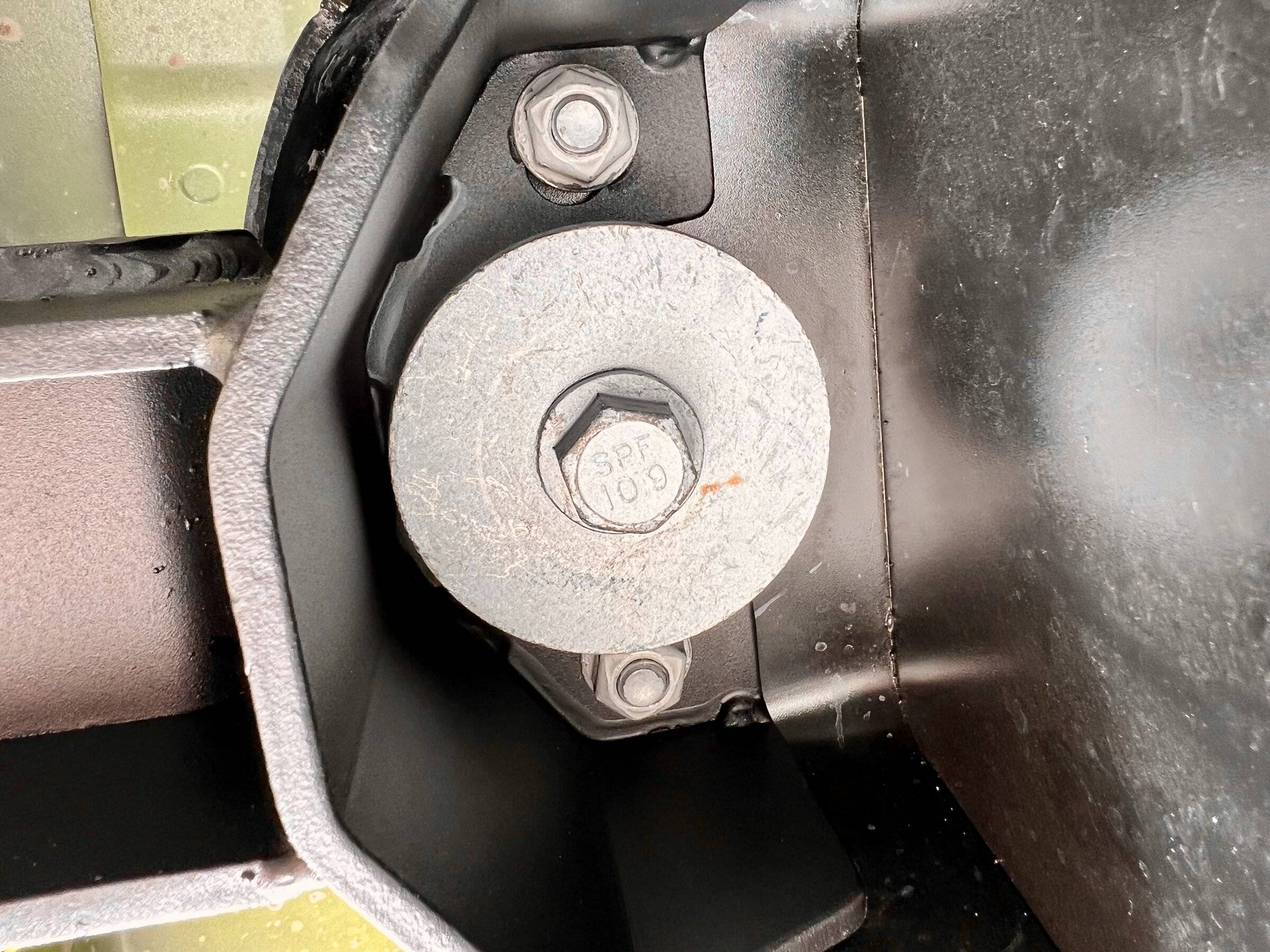

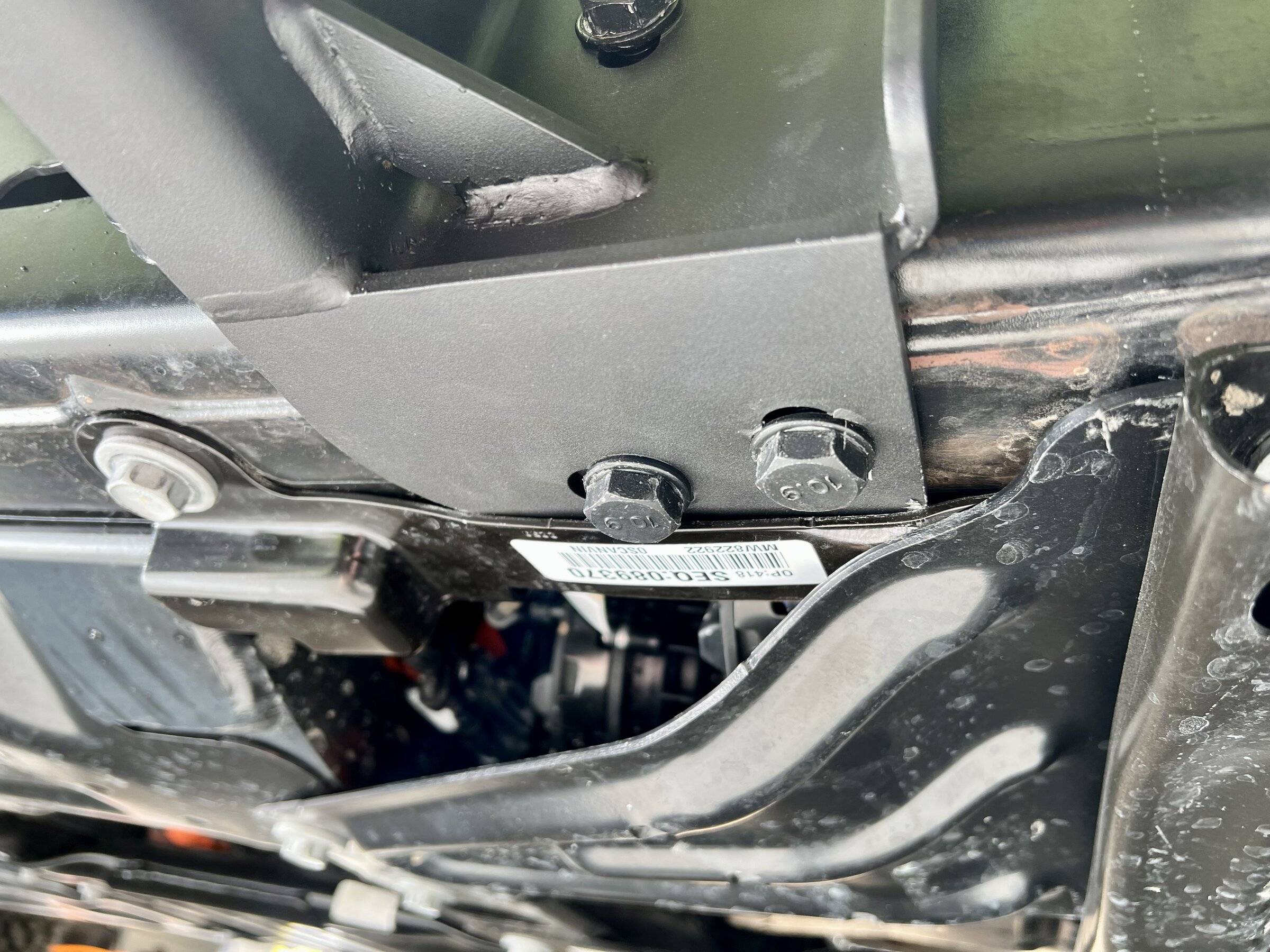

what you’re seeing here is 1 of 4 mounting points that use the factory body mounts. Not the primary bolt but the secondary ones with 16mm nuts to secure them. The aft and center mounting points are like this on both sides. The forward mounts use supplied hardware plates, spacers, nut plates, and 3/4 inch bolts with washers. Very simple to figure out overall.

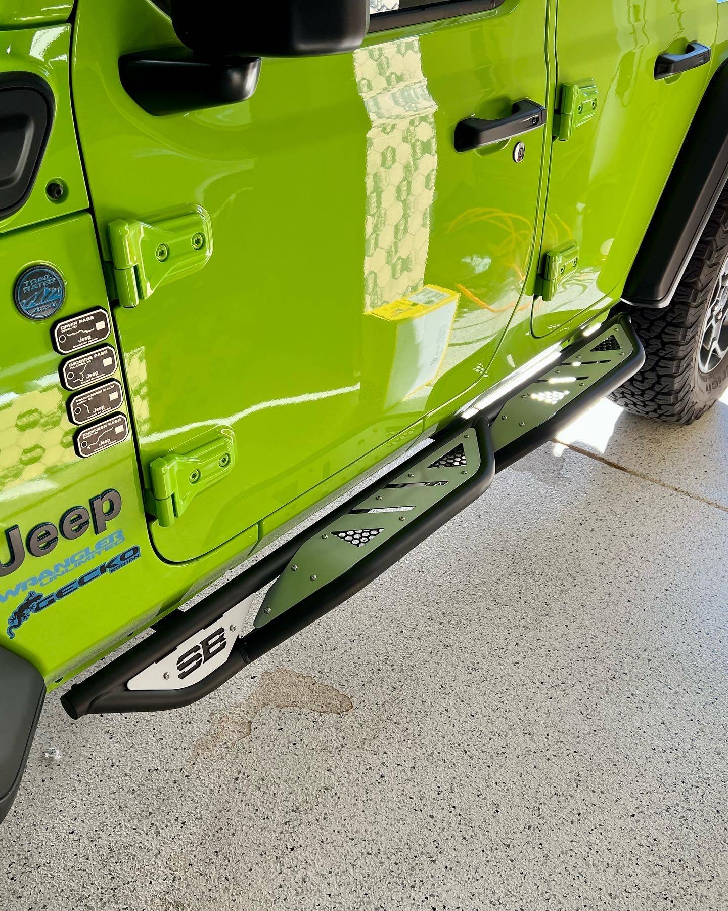

Here’s the final results. I’m very pleased and happy with them. Definitely need to repaint the plates (blue? Green?) and replace the hardware for them with stainless stuff. Quick note about the plate hardware, it’s cheap trash and it’s not very tight when you receive everything. I ran them all in with my impact drill and appropriate bits (not going anywhere now unless I want them to that’s for damn sure).
Here’s where I’m gonna have to put an asterisk in my post; I’m deploying at the end of the month and won’t be back for a few months. In other words, the off road review is gonna have to wait until late spring/early summer. Aside from that, I’m happy with them and they are very sturdy. My wife is 5’4” on a good day and thinks it’s much easier to get in the Jeep now than before (until I lift of course, then I’ll probably hear it all over again lol).

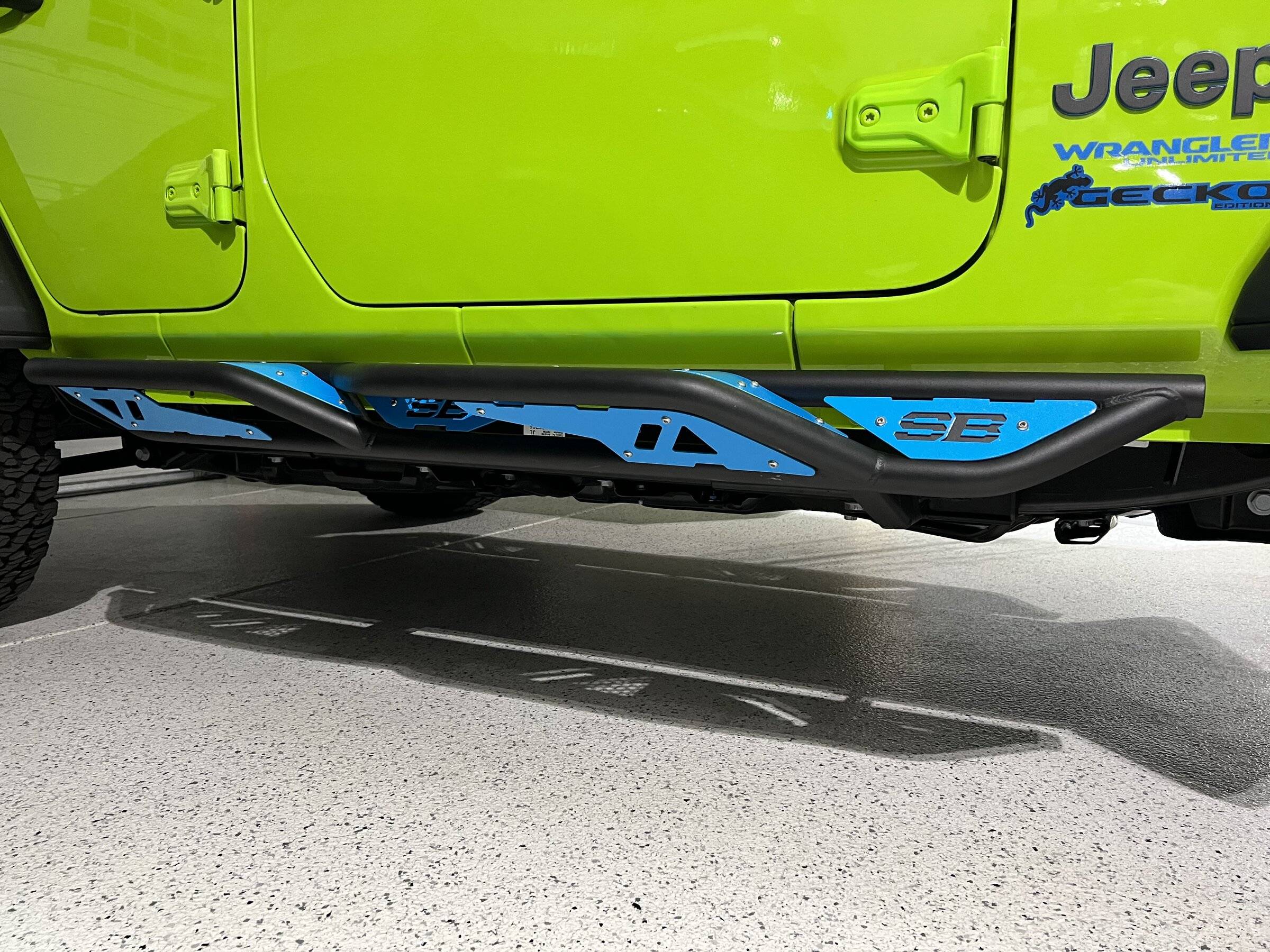

I ended up pulling the plates off to respray them. The silver was bugging me and it wasn’t exactly the greatest quality for durability sake.
As suspected, the plate hardware is absolute trash. I managed to destroy something like 10 out of the 60 total screws thanks to garbage quality. Replaced all of it with 304 grade stainless and can already tell the difference. Shouldn’t ever have any rust issues now.
As far as respray, I took a page out of another 4xe owners book and used Rustoleum Maui Blue after some sanding with 80 grit (definitely use 100-120 instead, 80 is a little overkill unless you don’t mind a couple extra coats or primer/paint). I’m pretty pleased with the outcome.
Jeep Wrangler JL Smittybilt Apollo Slider/Steps D4162F85-669D-4A5A-93A2-69ECCAF7A063
Jeep Wrangler JL Smittybilt Apollo Slider/Steps F55C63BF-6566-4D2A-B53C-E8E425C6B9D9
Jeep Wrangler JL Smittybilt Apollo Slider/Steps 9A5383C7-FB45-4837-9684-C086B110FC5D
Looking forward to putting them through their paces next year. It’ll be a trial by fire in MOAB to make sure everyone that’s even remotely interested is getting the no BS verdict on them.

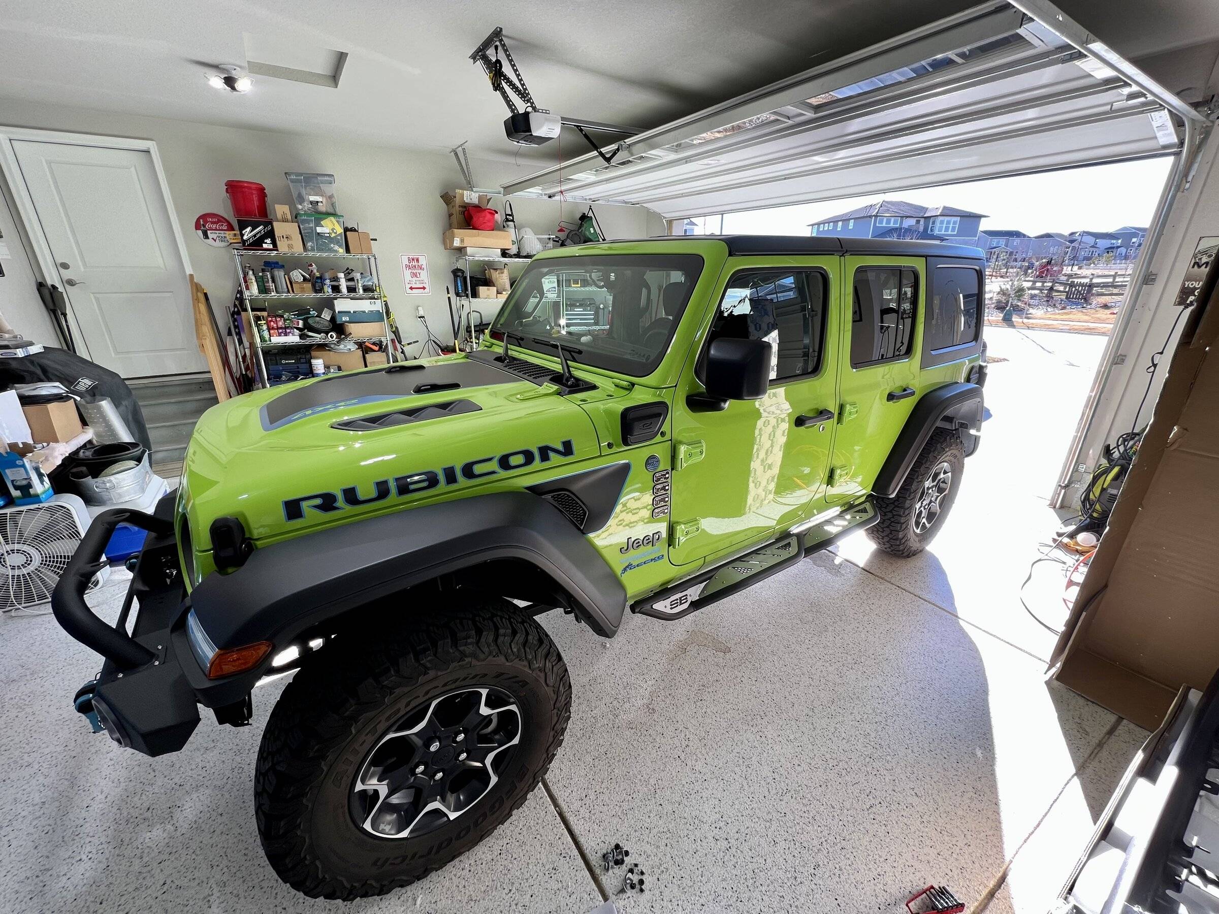

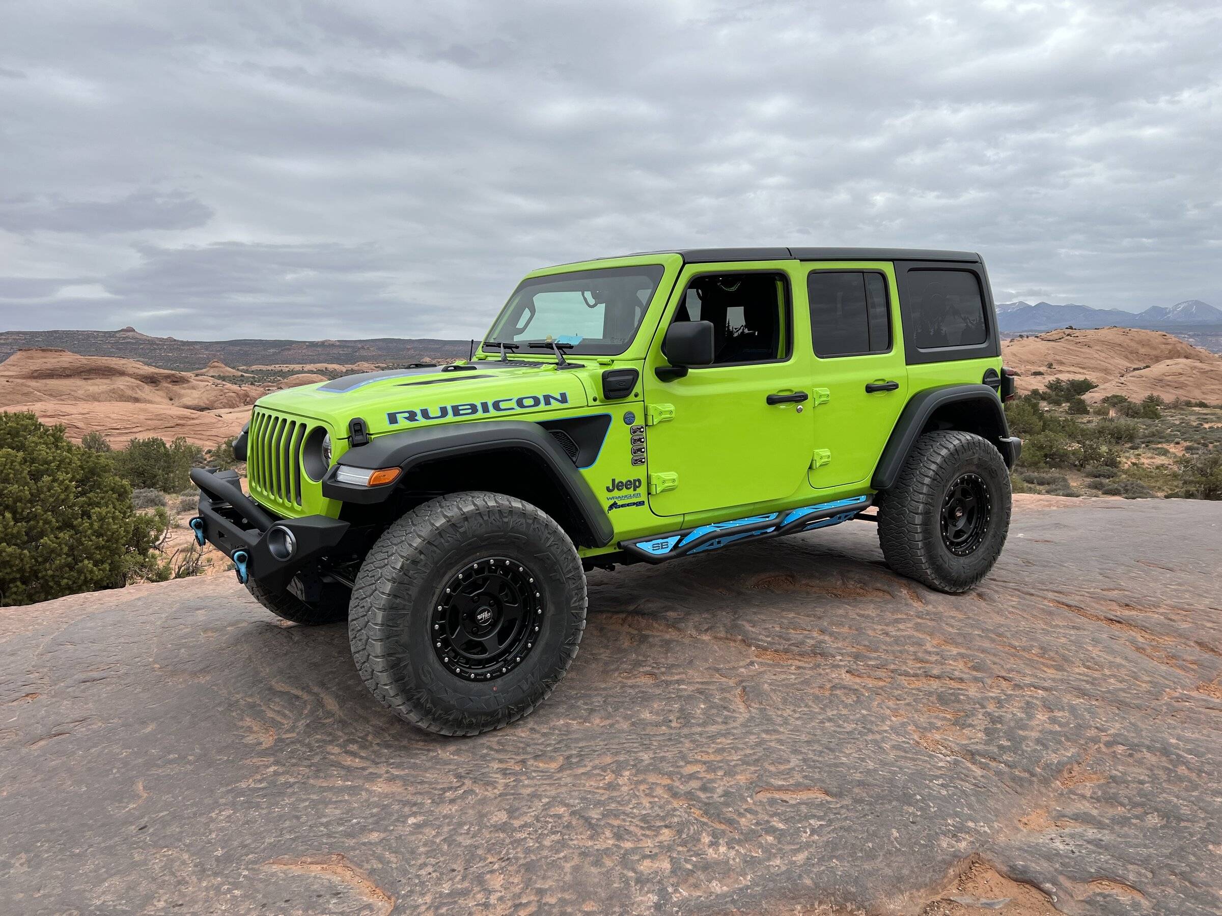

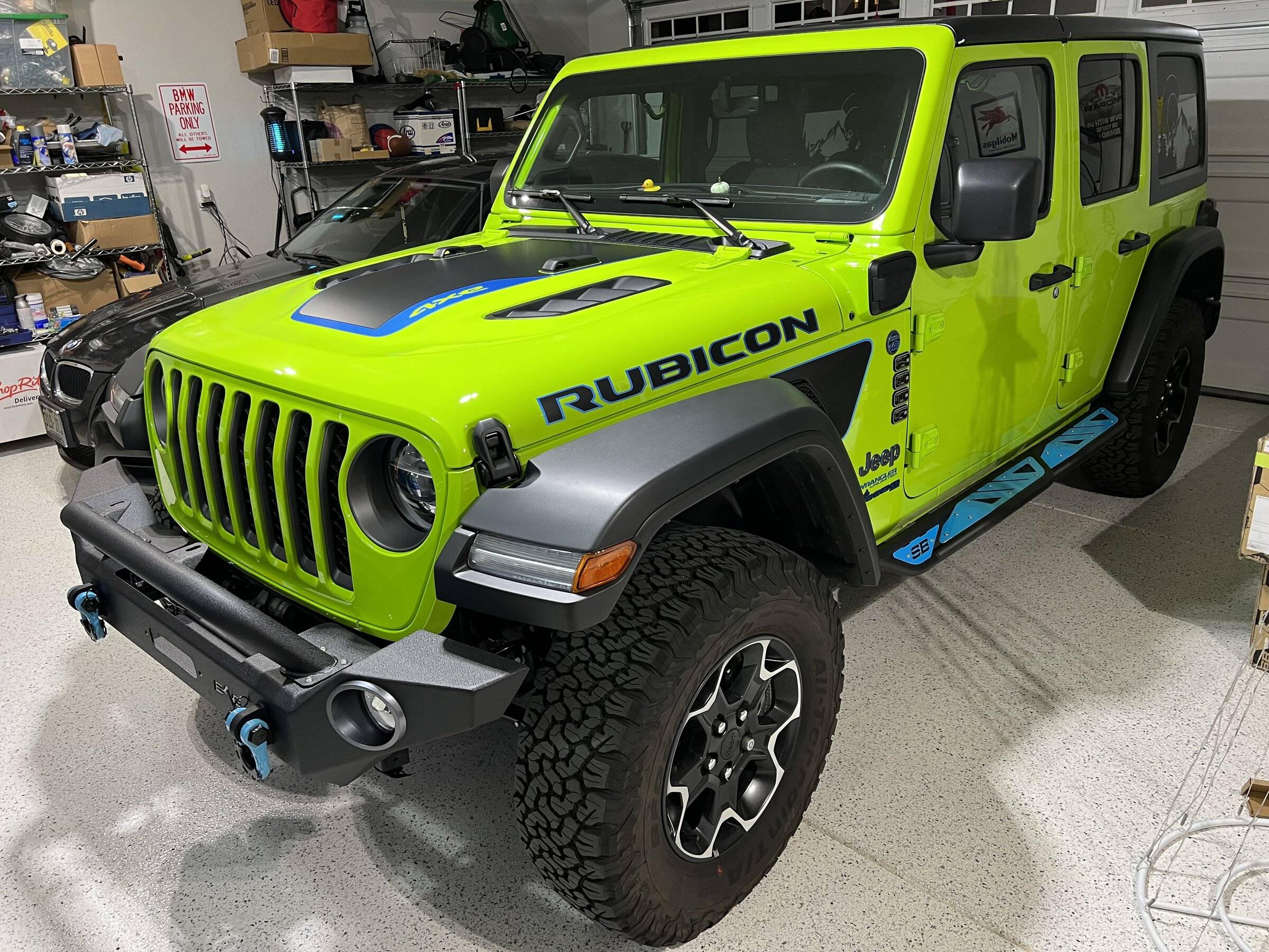

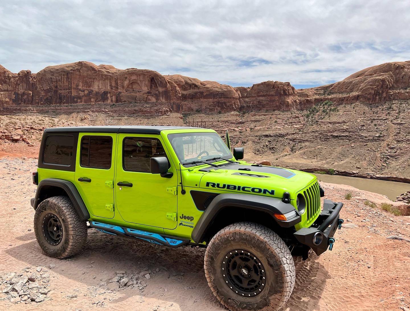

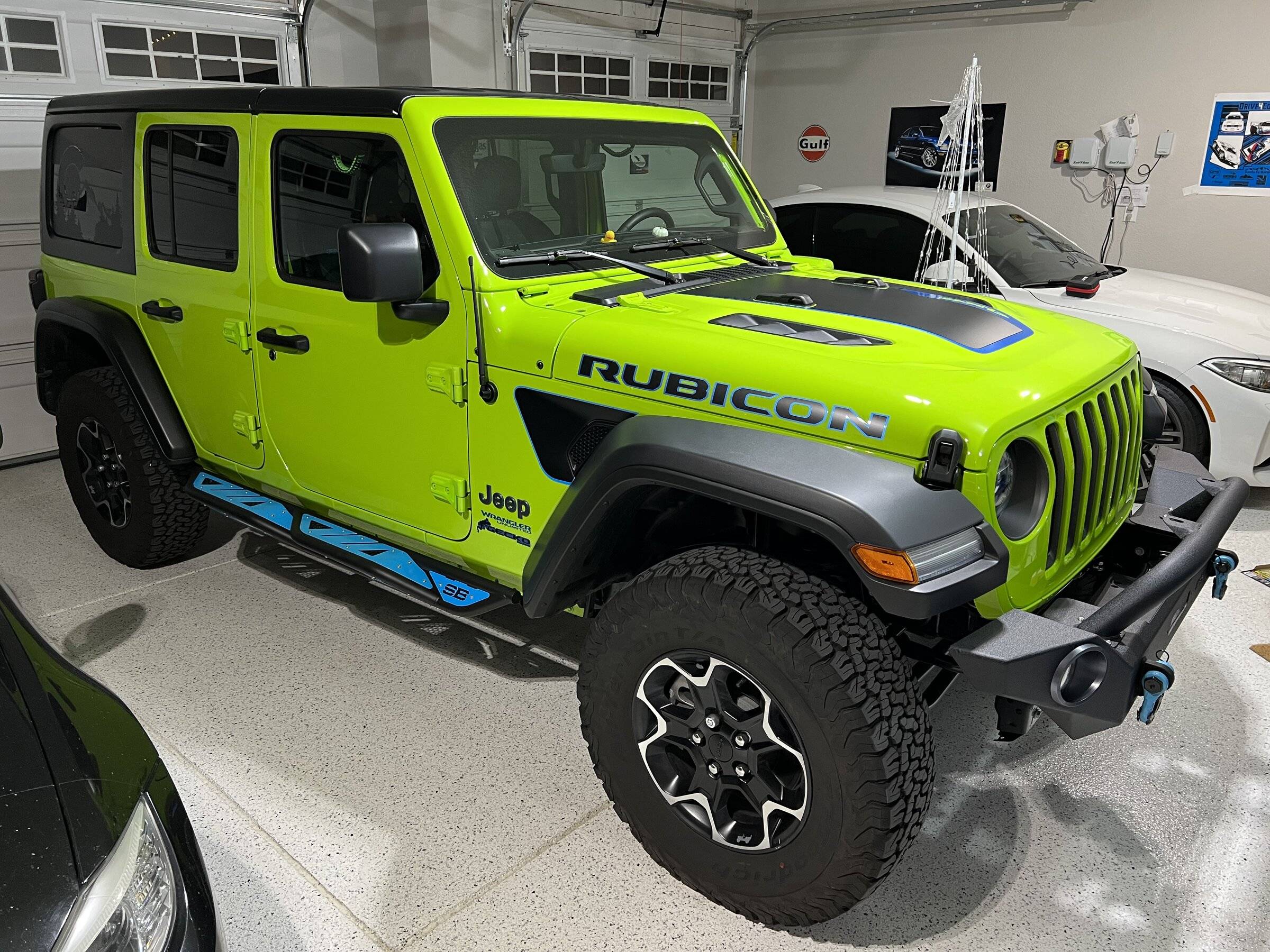

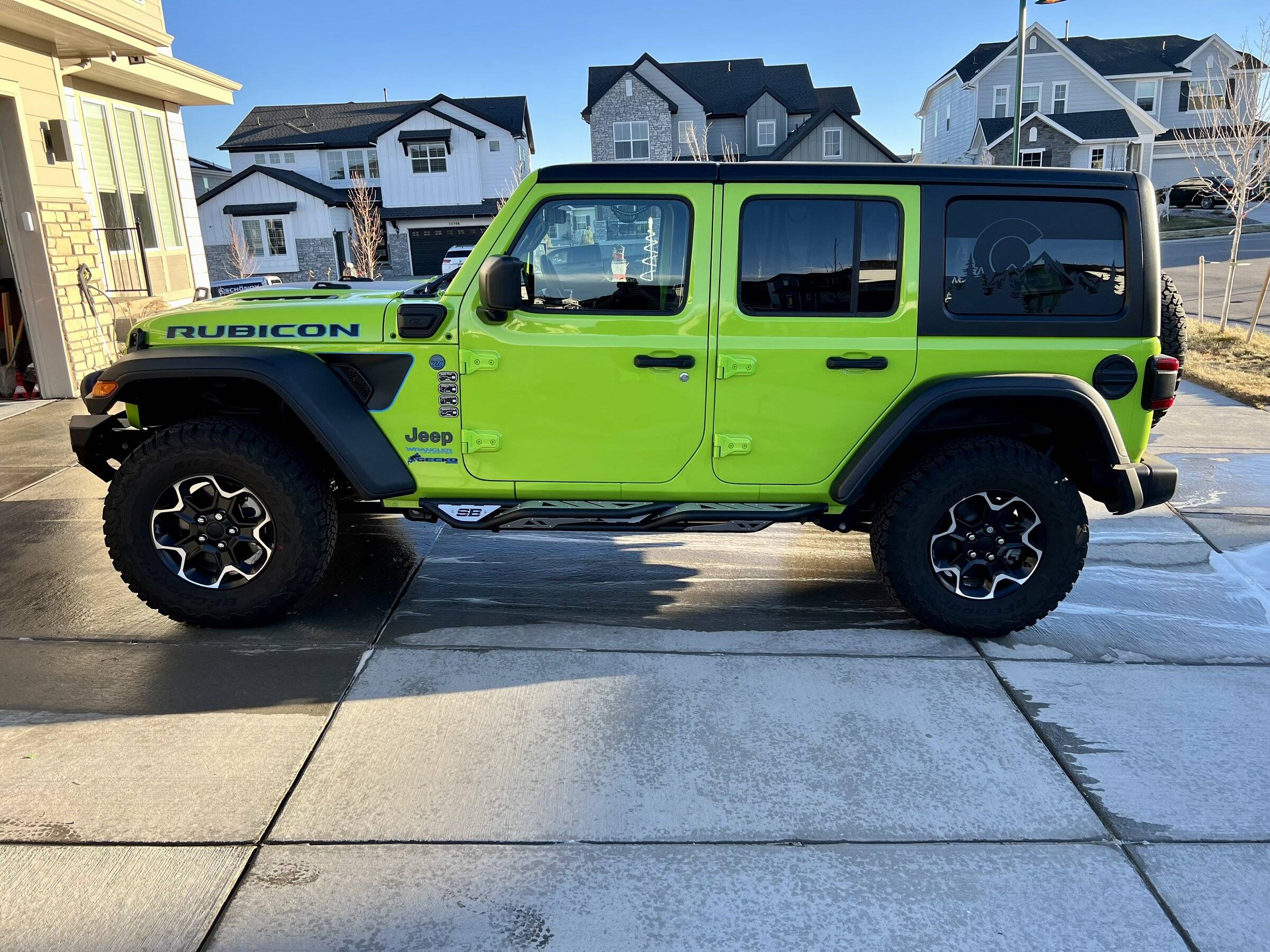

So it’s been a hot minute since I’ve updated this, but I wanted to give my impressions on these sliders since finally taking them on the trails in Moab. Keep in mind I’m now also on an AEV spacer lift with 37’s.
How are they holding up visually?: Well the coating hasn’t come off and I haven’t got any rust to speak of. I really think replacing the stainless hardware on the decorative plates helped a bunch.
Have they taken any abuse?: Up till today, I still hadn’t managed to really ding/dent/scratch them into any obstacles or rocks. I finally had my first major impact on the drivers side today that sounded like I might’ve banged them up pretty good. To my surprise, I only managed to hit one of the support beams going to the frame and all it did was scuff the coating off. Not really damage if you ask me. It’s not even photo worthy because people are gonna start asking if I even wheel my jeep. :CWL:
Are they worth it?: Absolutely. They are still functional as a step which helps my short wife get in relatively easily even with the lift and 37’s. They still look bad ass too. I get tons of compliments on them everywhere I go.
Final thoughts: If you’re on the fence about these sliders or SB’s other version (SRC), don’t even second guess them. These are great for the money and unless you plan on purposely grinding your rig around a rock or a rock ledge to clear an obstacle on them, I highly recommend them (even then I’d probably still consider them). 8/10 for being a bad ass step/slider option. I would rate them higher but they’re not a dedicated solid piece of metal like most of the hardcore sliders are and the cheap ass “stainless” hardware they send with the plates is absolute junk that can be replaced for low cost. It’s just obnoxious they don’t come with better hardware straight from the factory.
