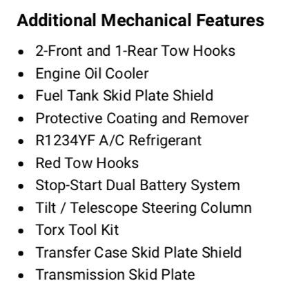

Hey folks, looks like the 2018 3.6L has the same ESS "dual battery" system as the current GC I posted a video above. Confirmed from the configurator output:
I think it's just to keep the cabin equipment like radio and A/C running during an engine stop event, leaving the main battery just for restarting the engine. They are both 12V but the main one is big and the auxiliary is small.
