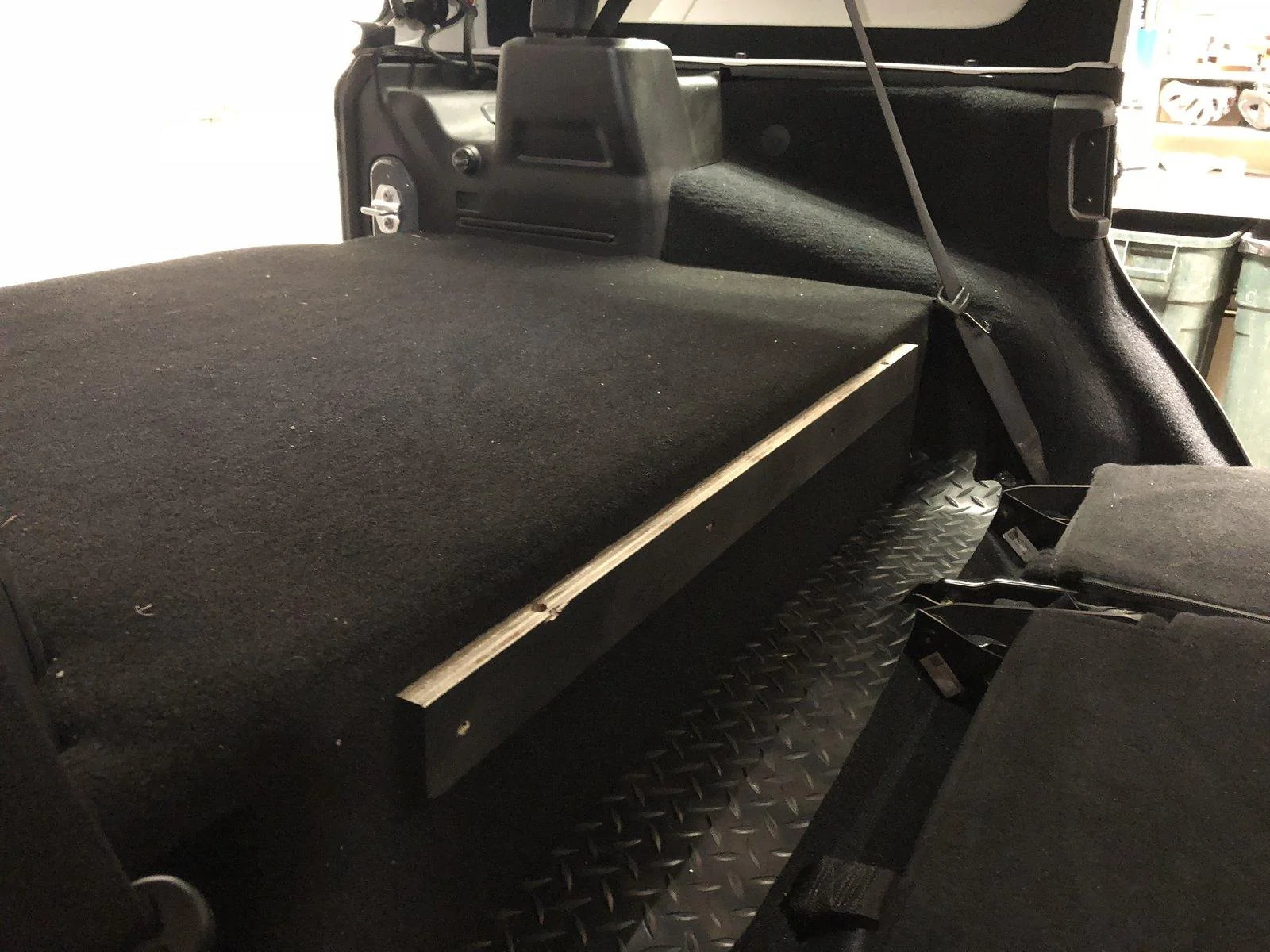

Removable & fits over folded rear seats. Using the Xprite Sleeping Pad.... will finish painting and adding black carpet to it tomorrow.
Edit: Finished the project. New photos added

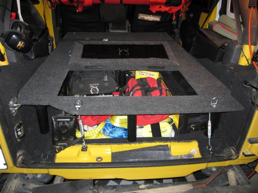

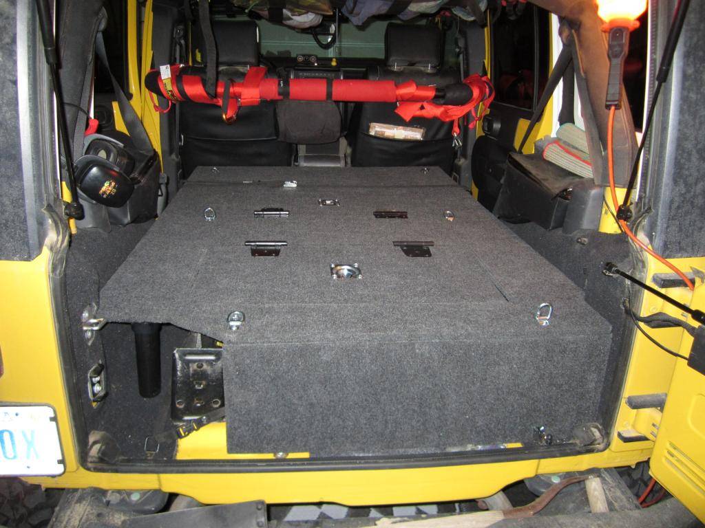

I have a 2dr now, but I had my '08 setup for with/without sleeping, depending on the use of my trailer-
Ready for storage first-
Then close hatch's
Then sleep
The cargo area of the JKU/JLU can be custom modified and made for a comfy sleeping area for two and will be warm and SECURE-

Full Platform is 6’ long (front seats extended forward), 48” wide over folded rear seat area, 40” wide in cargo area. Rear seats are just folded forward in normal way. They still slope upward but the platform is flat above them.

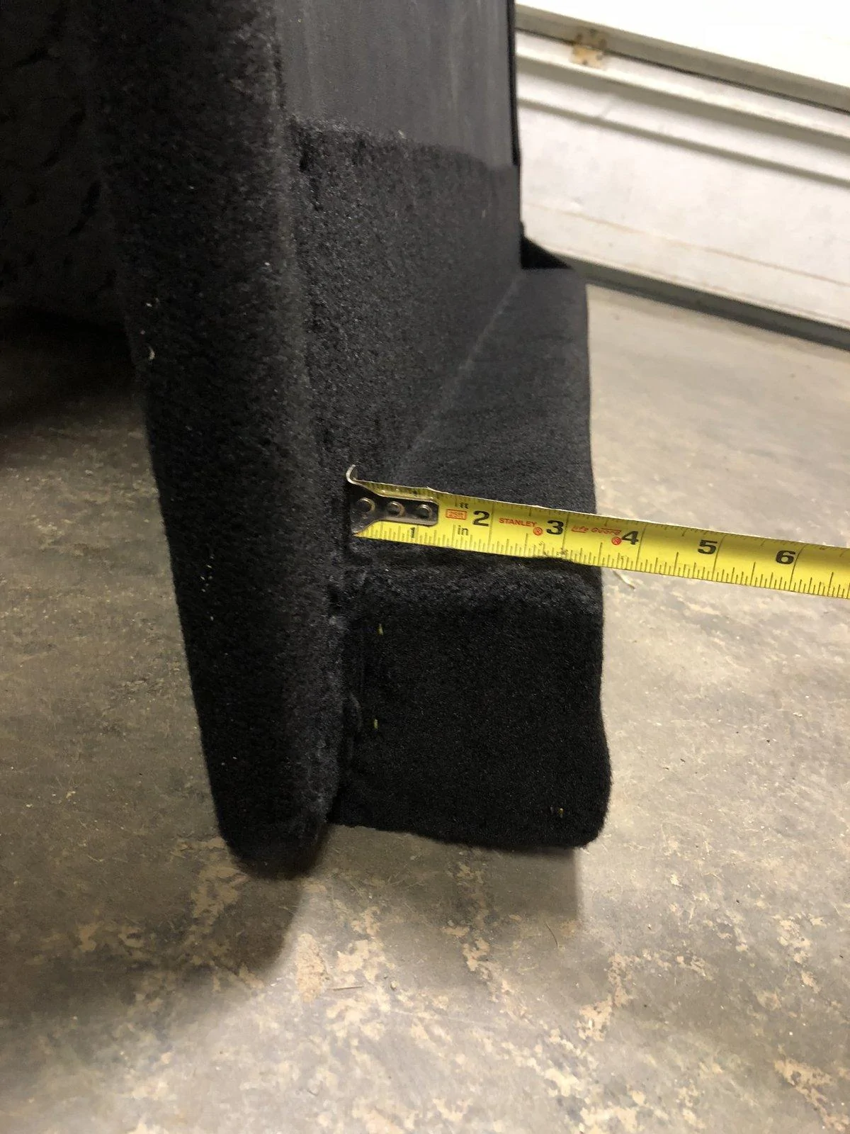

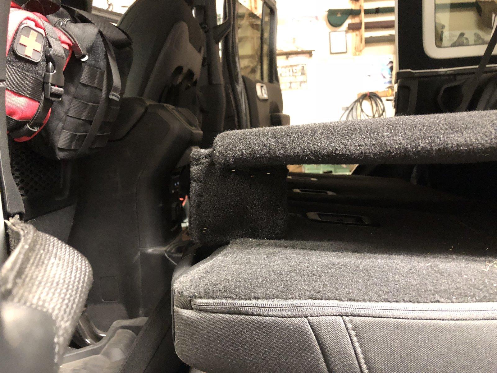

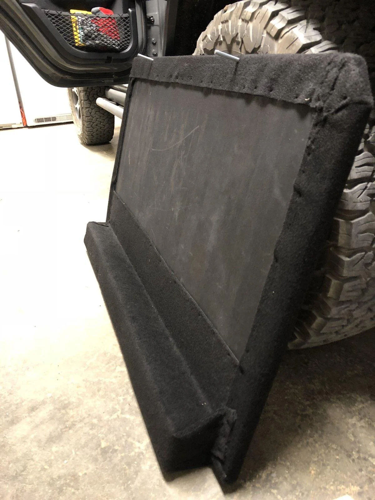

I would love to see more of the under the flat surface detail on the portion of the bed that lies above the folded down back seats.
Here’s a bit more detail @RussJeep1 @Euro JEEP
The 8” high rear cargo area can be left in place with rear seats upright. It has a plywood ledge at the front to rest the middle (over the folded seats) area upon a couple of clevis pins ensure it won’t slip off.
The middle section is simply a 48” flat plywood piece with a 3 1/2” lift block in front that when put in place, the lift block rests on the front edge of the folded seats. The lift block is screwed onto the plywood so it also creates a rest edge for the forward most portion of the sleeping platform.
