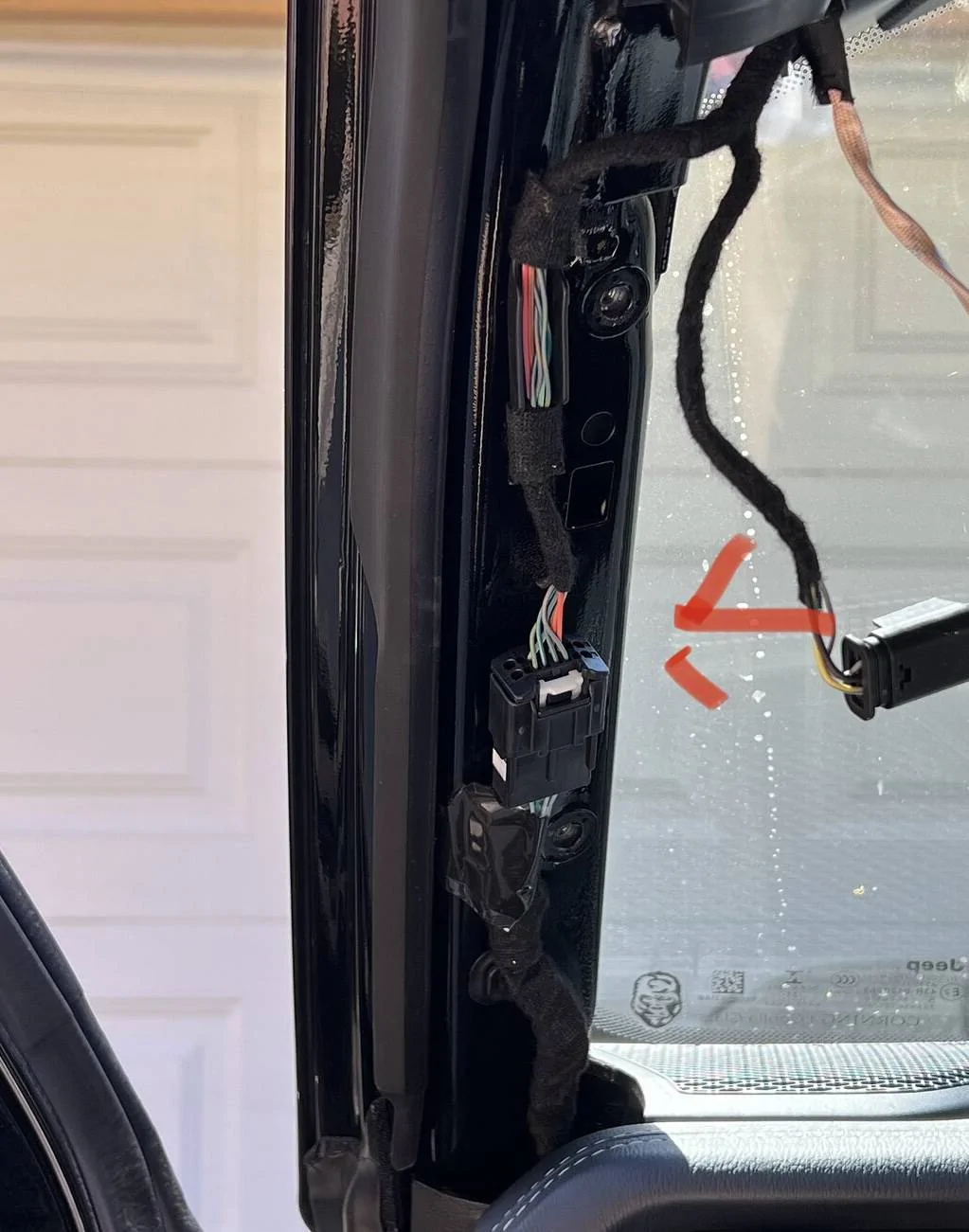

I just put the sky one touch on my wife's jeep today. Thanks for this info on the 2 extra wires. I couldn't tell which ones to use in the kick panel as there were multiple orange with violet, but I ran my 2 wires back to the body plug that plugs into the hard top. That is where I found the 2 corresponding wiresThe two wires aren’t available from Jeep, you would have to change the dash harness to get them from Jeep. Not a big deal to just add the wires yourself. They run from the connector in the A pillar down to the connector in the kick panel on the drivers side.
You have to pull the grab handle and look for wires in the bottom half of the connector, cavity 11 and 12 seen here.
Link to the wire diagram.
