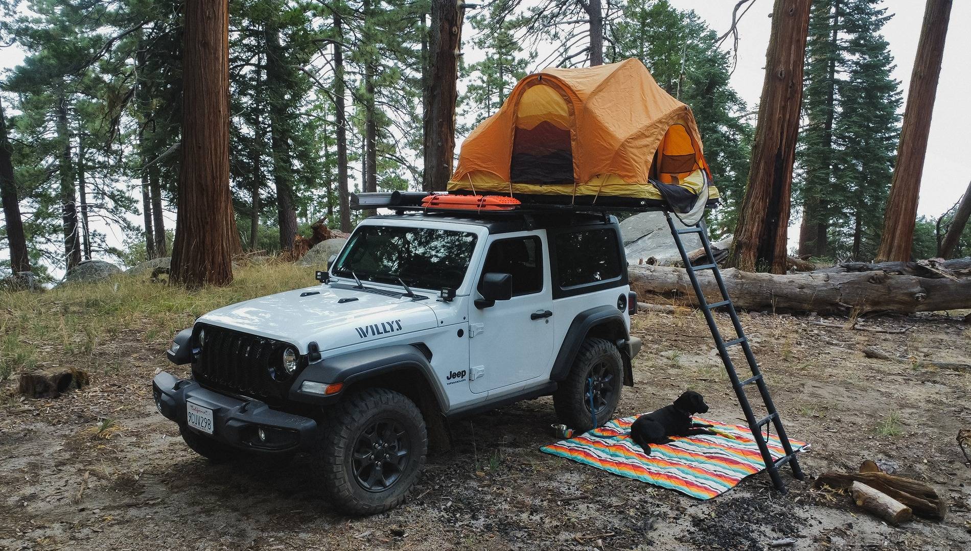

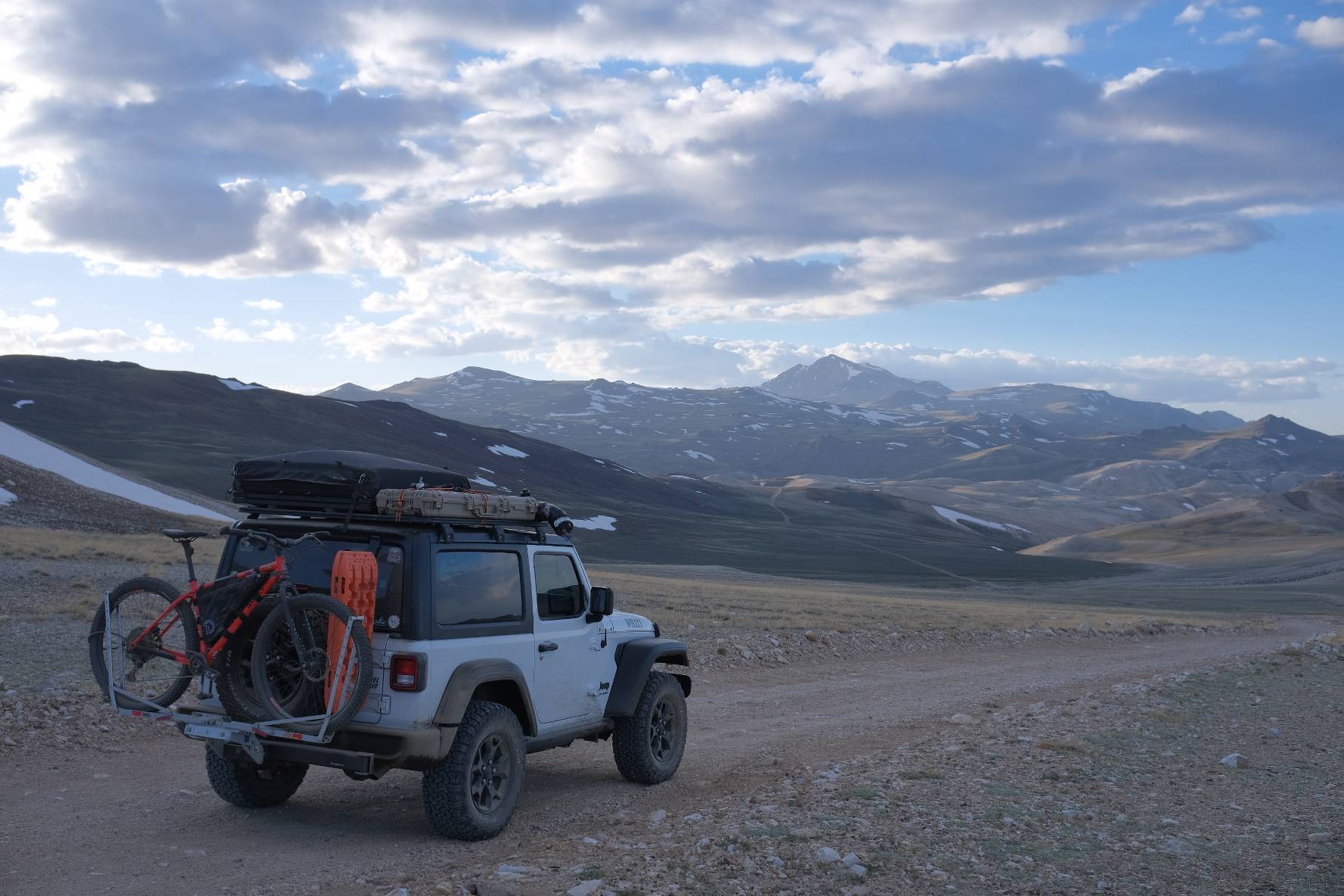

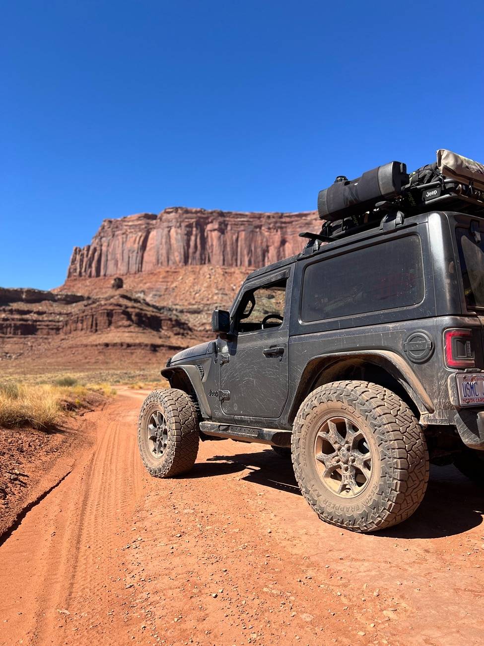

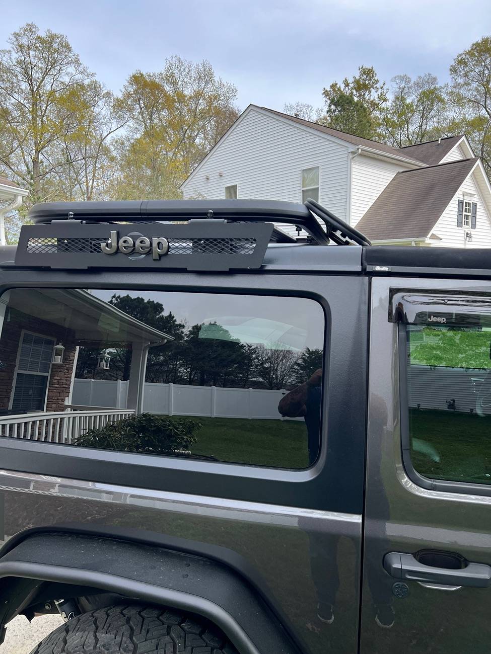

I have nothing but good things to say about my Antidote half rack. It attaches with six gutter rail mounts and I've used it for over two years now to carry my C6 Rev Tent and an assortment of camping gear. Comes off and on in about 10 minutes with the ratchet strap system I attached to my rafters.

Did you need a receiver extension for your 1-bike, 1up if you hadn't used the swing arm?
It worked without one, but just barely. I used a Kuat drop hitch receiver before upgrading to the swing arm and was very happy with it.

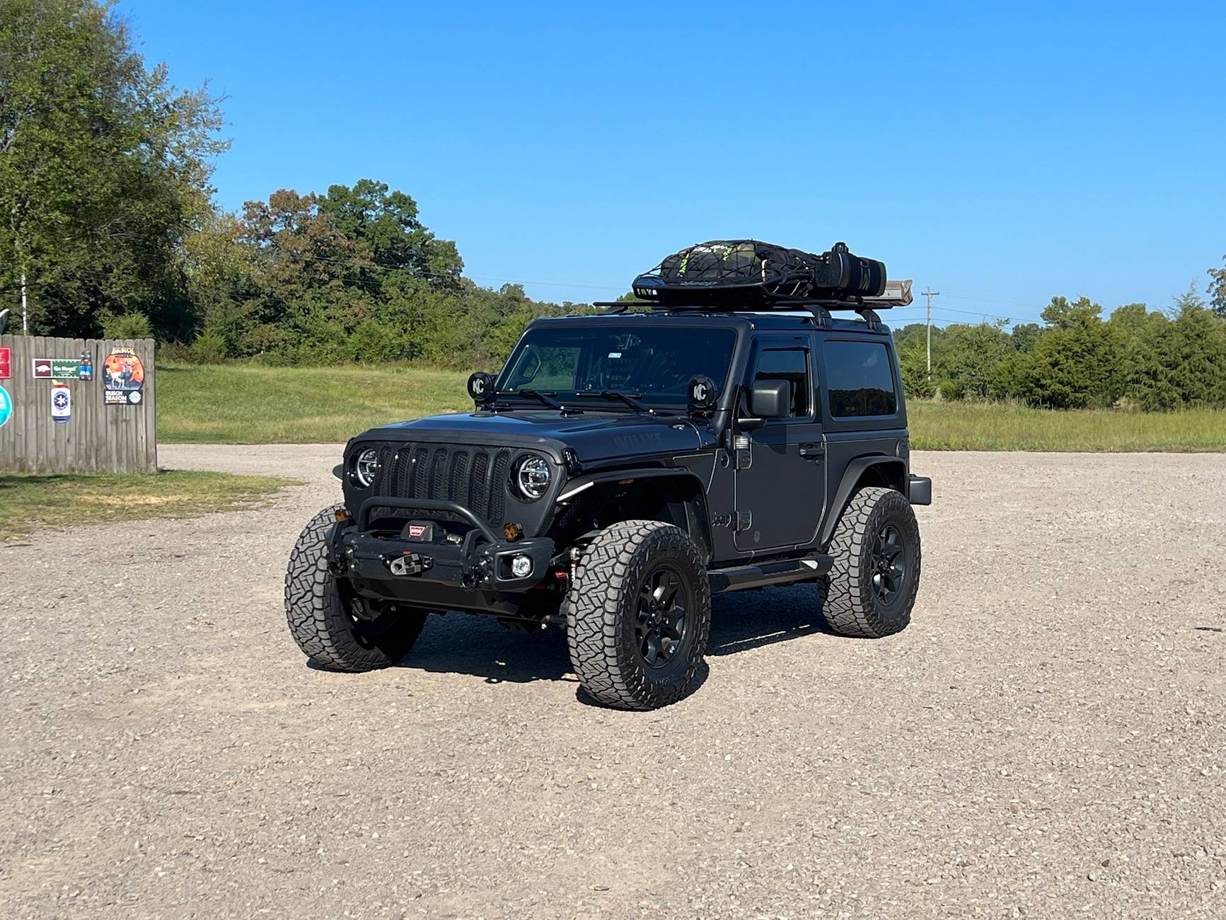

I have the Rhino-Rack Jeep Overlanding Kit (ROLJ1) and it is quite sturdy. There is some wind, especially with my 2 rooftop boxes, but it is very manageable as long as you stay under 70mph. I can definitely recommend it. In terms of dynamic weight distribution I would not add a rooftop tent when you are just using the rain gutters. For a roof top tent I would recommend a rack like Maximus-3 (drill through and internal support system attached to the roll-over cage).

that's a nice rack, but $1600 is absolutely insane..
