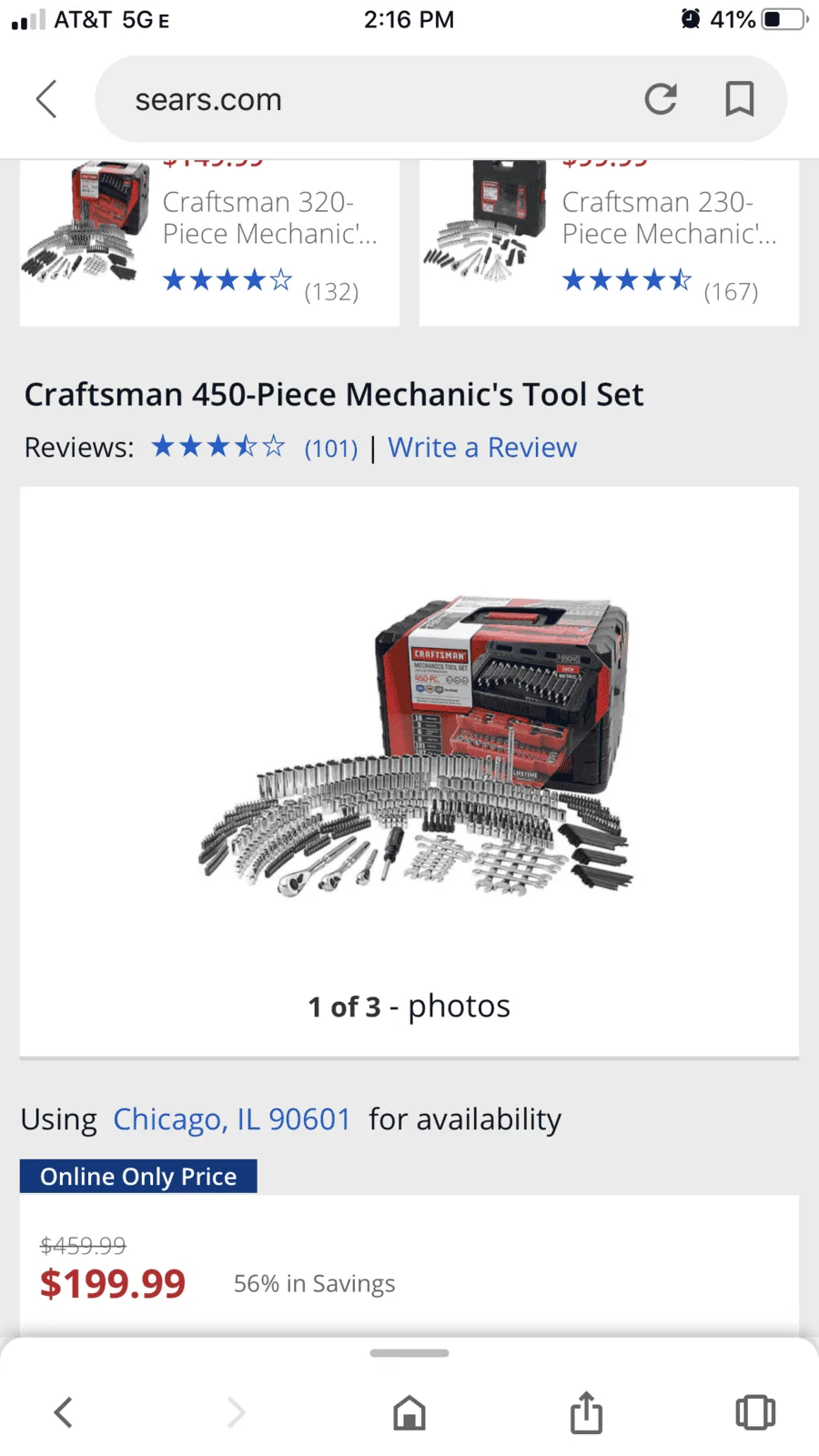

Here you go. I started here. Unfortunately HF doesnt have any big sets like this.
I have a Craftsman mechanics set that I leave in my Jeep on trails. Comes with three 120 tooth ratchets and every socket and wrench you can need, was only like 120$. I love the thing.
