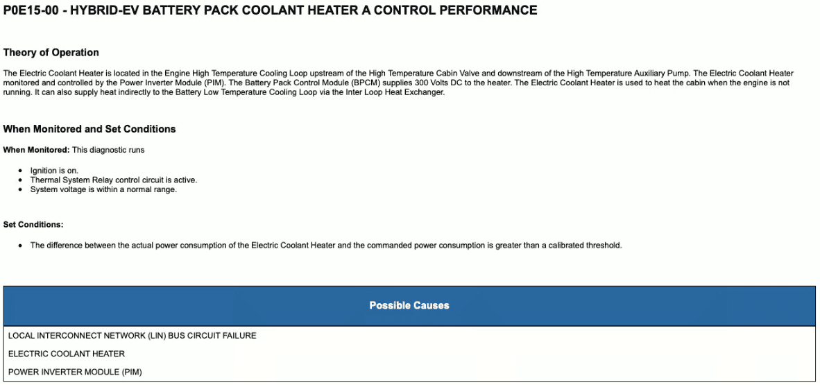

Update 1/26/23: Got a call from trusted dealership. They have confirmed the hybrid coolant heater is indeed bad, and will require replacement. Diagnosis took two days. Part ETA is early February. Jeep is providing me a rental to cover the gap.
