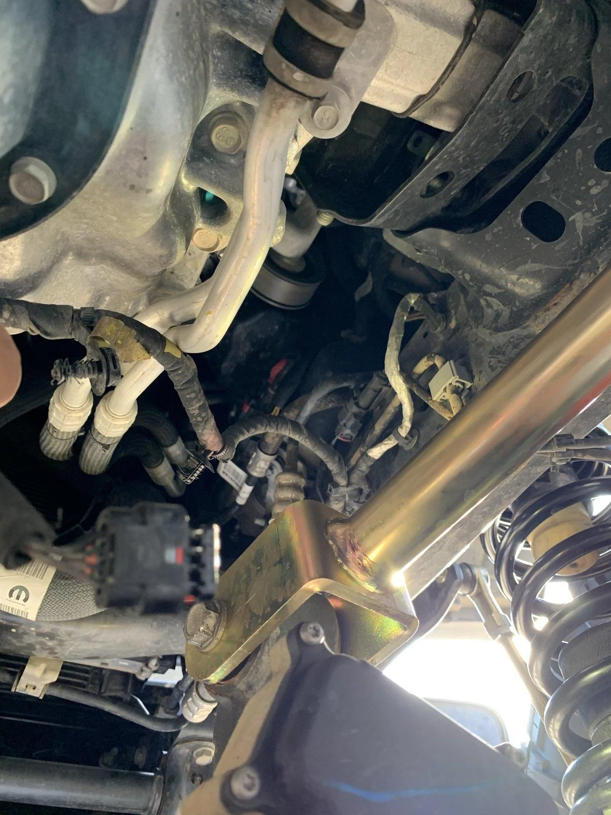

Has anyone gotten this light on the dash? I got my lift and new set of 35s installed today and when I picked it up it gave me this light on the dash. I also have the flashcal superchips programmer and was wondering if this can be fixed using that?

Too much of a coincidence here. Is it possible that the front locker harness connector wasn't plugged back in after the install?

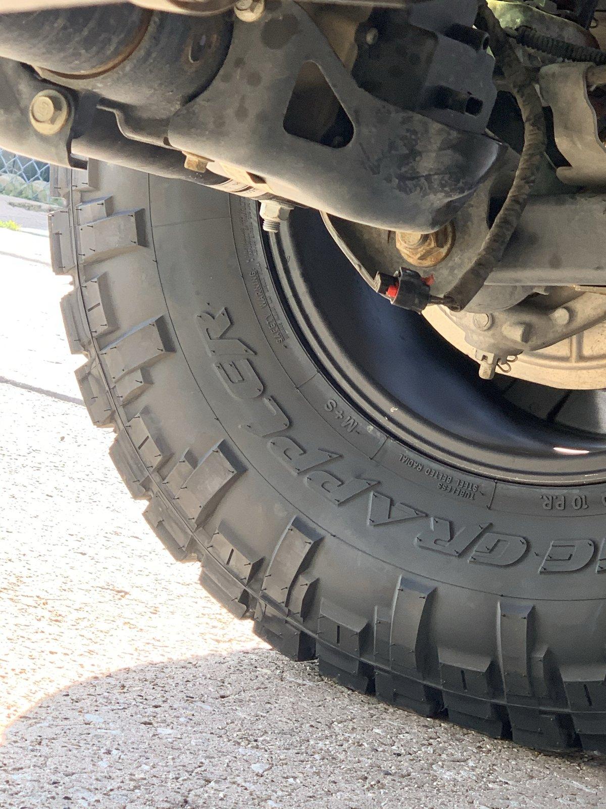

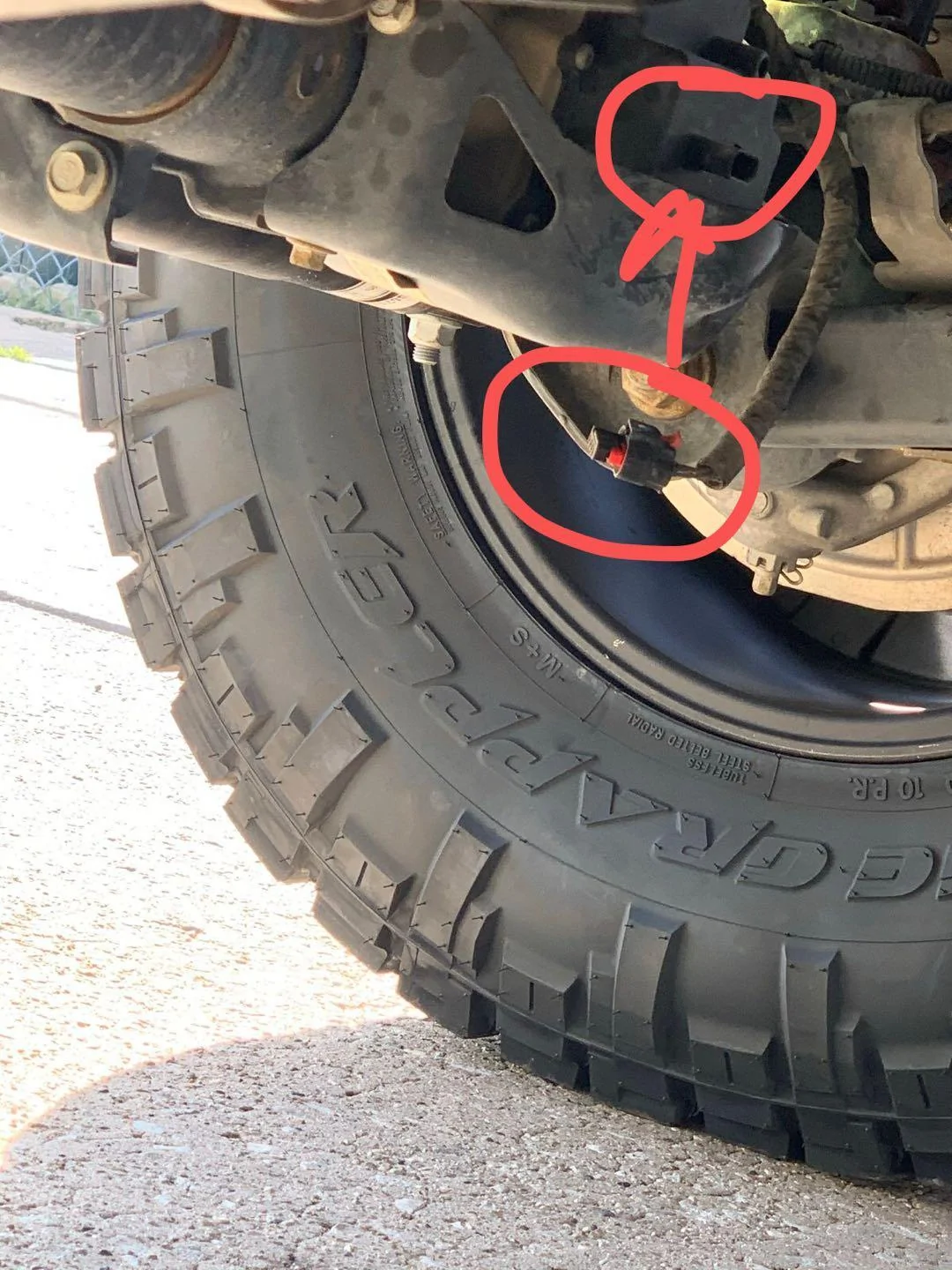

Any clue where this connects? Lol

Thanks ya’ll. I’m clearly blind af

So yeah. This got rid of the service 4WD light. I’m still taking it to the shop tho because it feels like if something is hitting when I apply the break and slow down or when it’s moving at low speeds.
