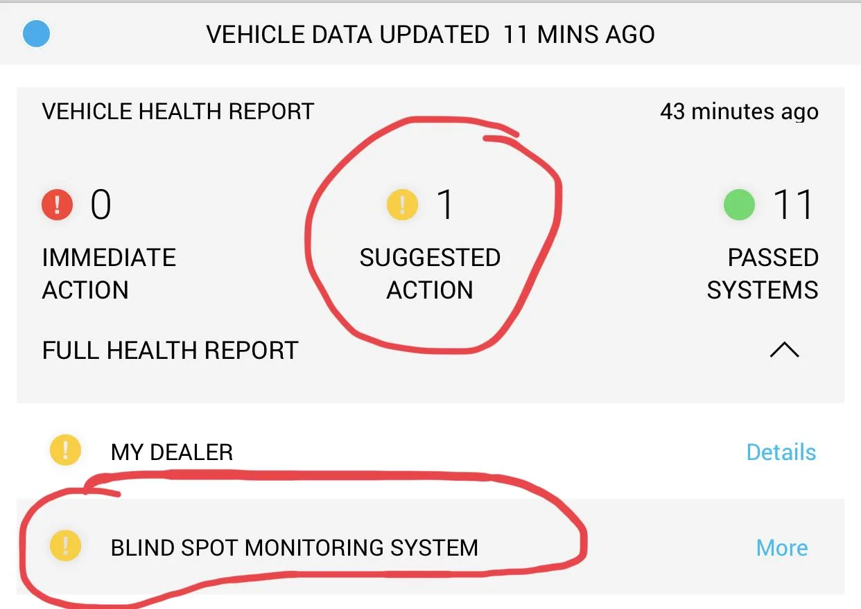

I’m fairly certain I know the answer to this, but hate to assume....
Would having the doors off nearly all month lead to the message in the attached screenshot from the UConnect app (also received it in the monthly Jeep Monthly Vehicle Health Report email)?

Yes absolutely!
The monthly report hasn’t caught up with the fact that if blind spot has been offline for a while for good reason — because the doors are off — it is NOT a real problem.
The “Doors Off Device” from Z Automotive resolves this issue by lying to the Jeep about the presence of the doors. The simple device - which plugs in to the door umbilical connectors - is in beta now.

I figured as much but thanks for confirming Jim!

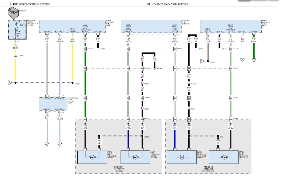

The BSM circuit seems pretty simple...just jumper the BK/BN and BK pins on the connectors with a similar LED. At that point, it should be transparent as far as the Jeep is concerned. Unless there's some other logic that has to be made (maybe it also has to see the door 'closed'?). But then why would it wait 48 hrs to error...seems odd. Is there more to Z Automotive's connector than just one jumper?

The device jumps a pair of pins as I recall, and has a second pair with a small resistor jumping them.
The simple device, which plugs in where the door harness goes, does everything we want -- except after a couple days the master computer gets pissed and goes into an error mode on your dash. Takes a reboot of the computer to get another 48 hours..
The master computer gets upset after a few days - his theory last time we spoke was that the main computer expects to be able to auto-lock the doors when you take off, and the door locks probably send back an ack when they have performed the lock instruction. Something like that..
So it's not as simple as jump a few pins.
Curious about the second jumper/resistor & what pins those are.
Also, seems odd that it would be dependent on seeing auto lock feedback when that's a feature you can enable/disable through the UConnect menu. If that is the case, it also seems like you'd get that error whenever you took the doors off...regardless of BSM status.
Could you post a pic of his connector or ID which pins are jumpered?
