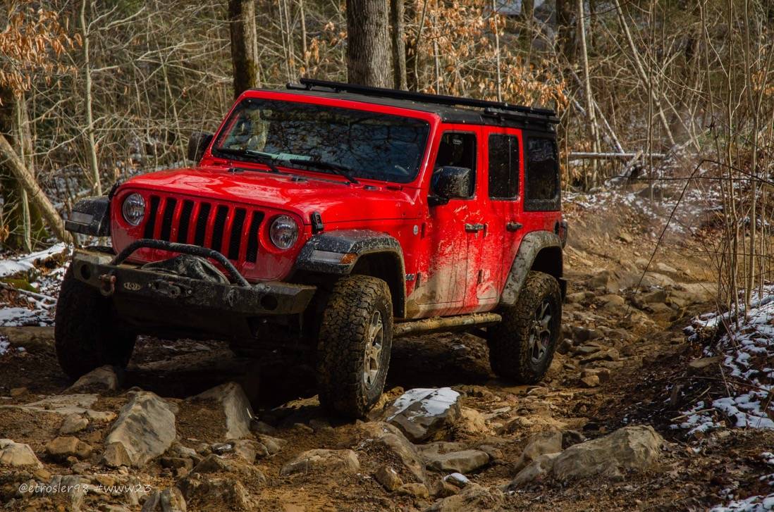

Need some help. I have a 2019 Sport and need advice as I’m getting two very different recommendations on regear and lockers from local shops. I’ve built this jeep myself learning as I go so I have some attachment to it. I’ve added Clayton overland lift, bumpers, winch, sliders, katzkin leather (my poor hands), armorlite flooring and many misc accessories to make it my own, so I’d prefer not to trade for rubicon, but its not out of the question.
I have a m220 axle with LSD in rear and m186 in front; 3.45 gears and running 35” tires. I wheel moderate (think blue trails at Windrock) about once a month. Live in NC. It’s not my daily driver, but also not a dedicated toy. Probably will stay with 35s for life of the jeep.
