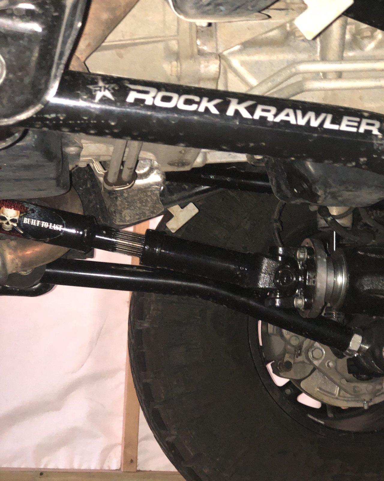

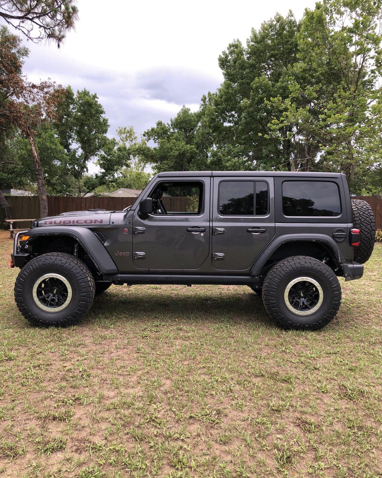

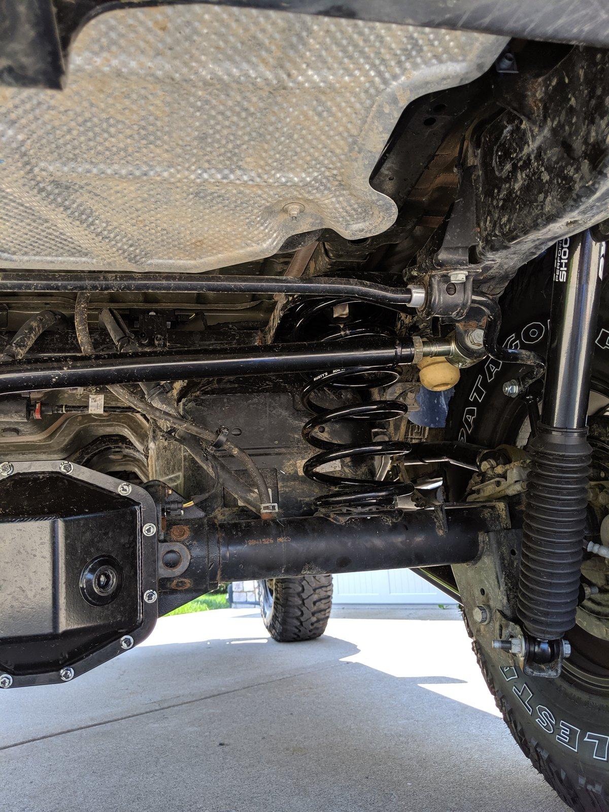

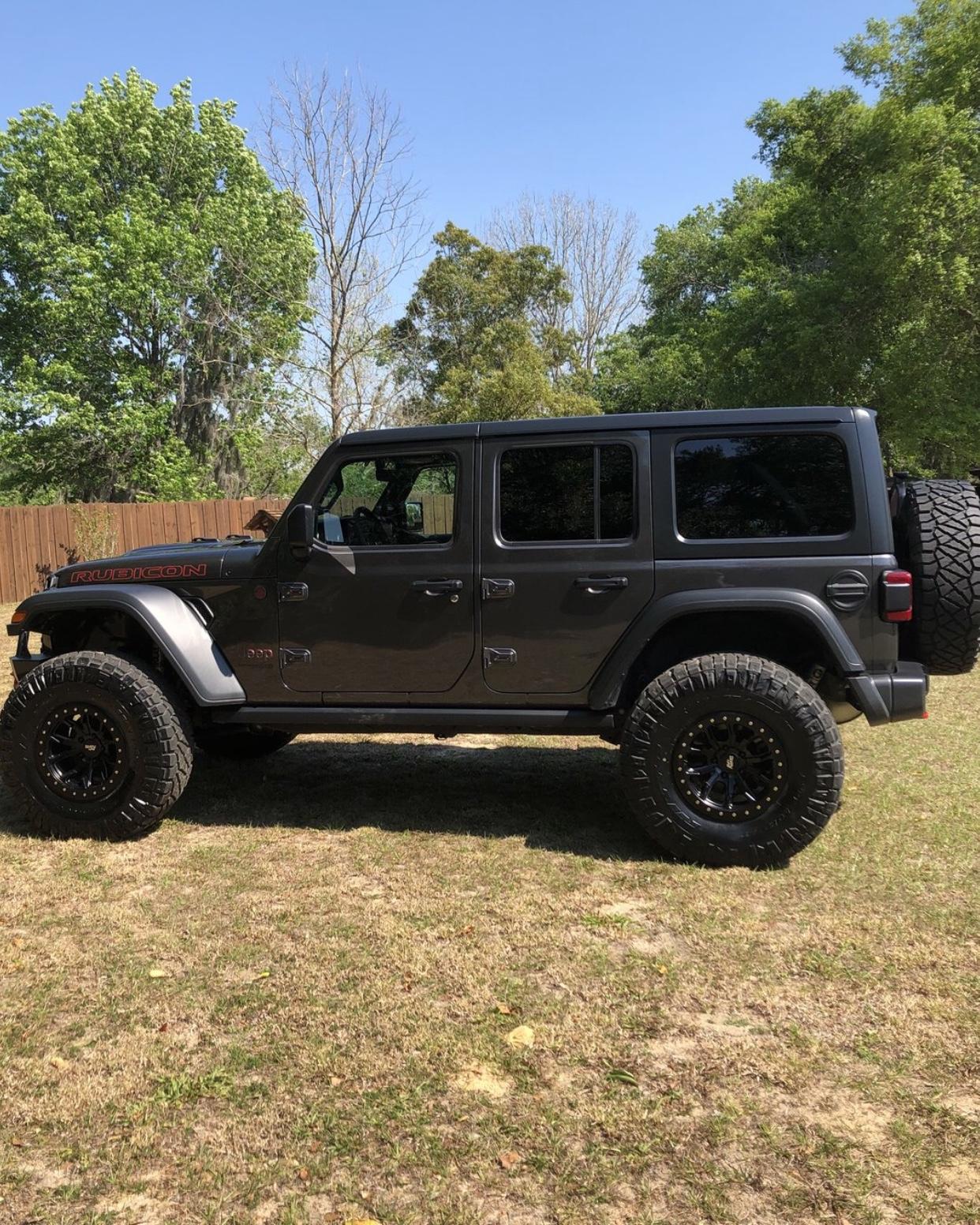

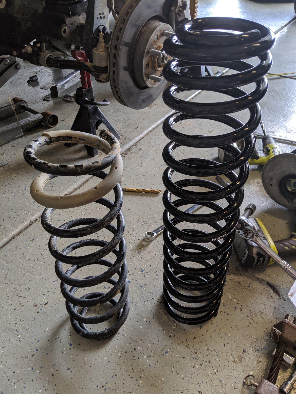

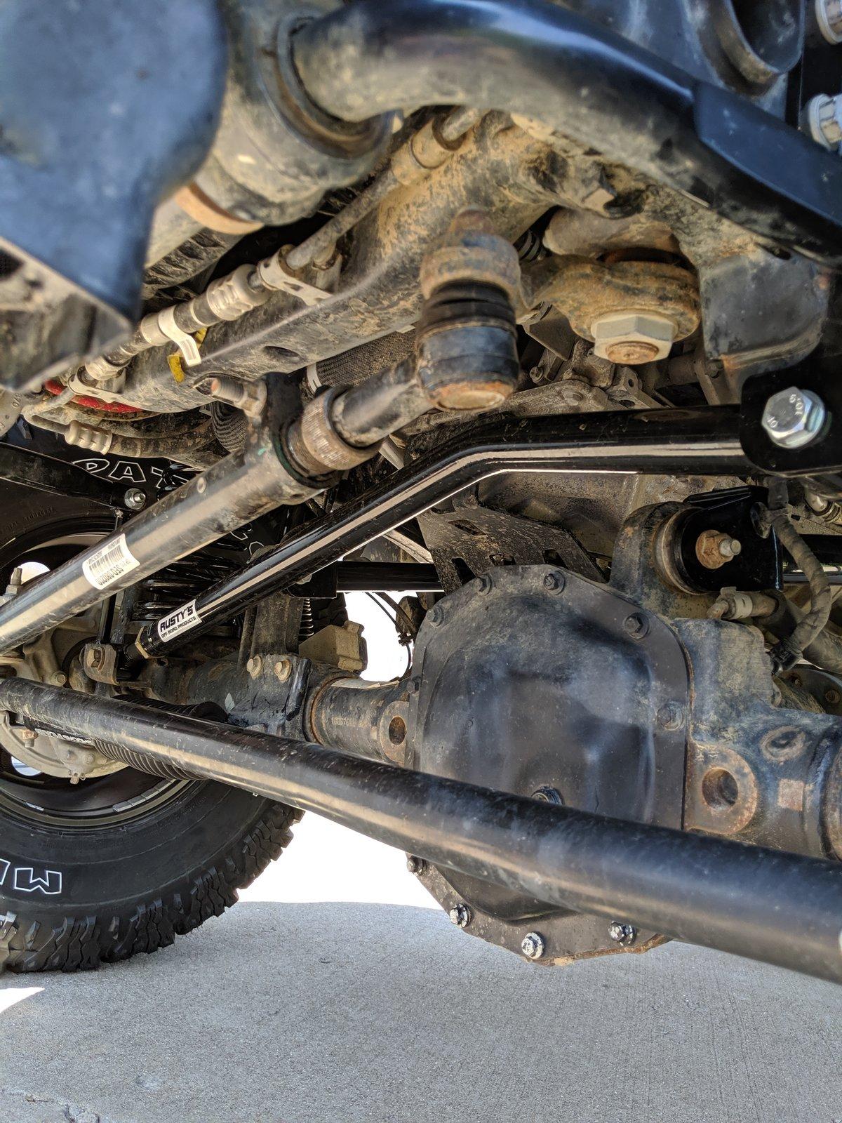

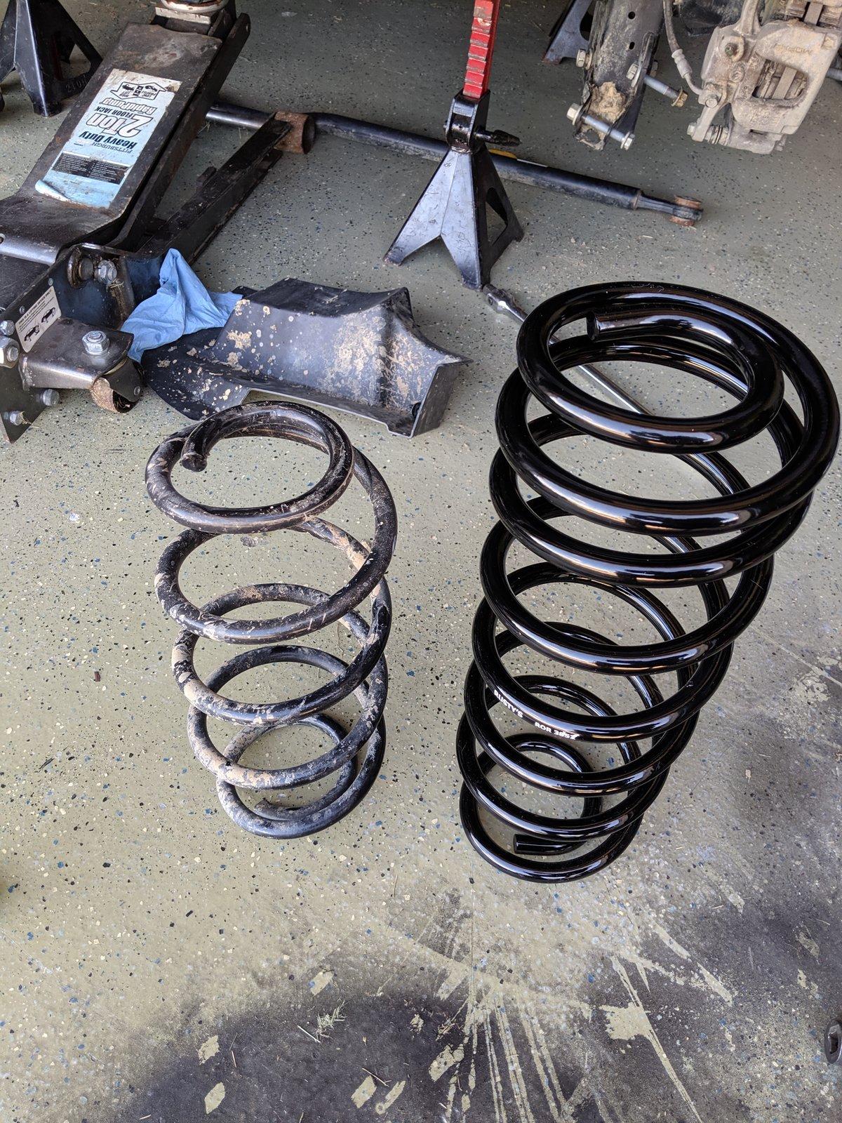

I recently installed this kit, thought I'd post some pics and info about it, since there is virtually none out there that I can find.
I spoke to quite a few companies and did a good amount of research before I arrived at the decision to try the Rusty's kit. I almost went with MetalCloak, but the cost difference between the two and the fact Eibach makes the RX800 shocks and springs I bought with the Rusty's kit pushed me over the edge.
The install was very easy and straightforward. Took me a few days, but I took my time and did it by myself. I come from a racing background, and working on this Jeep is childs play compared to fighting my Evo X or E46 M3. So much space, everything is so industrial strength.
After I completed the install, drove it down the street to the shop that has done all my alignments for my race cars. The owner had never done a JL, but had done numerous JKs. He actually called me after he was done and commented on how easy the alignment went and how surprisingly well the Jeep drove after such a drastic lift. He said that most JKs he comes across are almost undriveable when lifted this much. I suspect this has more to do with the JL than the Rusty's kit, but was still positive. I drive it about 300 miles on the highway this past weekend, very comfortably could go 80-85 mph, and was very pleasantly surprised.
Haven't taken it offroad yet, but will most likely this weekend. I will be receiving my new Tom Woods front drive shaft this Wednesday, shouldn't take me more than a couple hours to get that in and be ready for a trip to Cliffs Insane Terrain this weekend. There is zero percent chance you should consider getting this kit without replacing the stock front driveshaft.
Anyway, here are some pics and what-not, let me know if you have any questions or want to see more pics. So far, I'm extremely happy with this kit, glad I took a chance on it.
