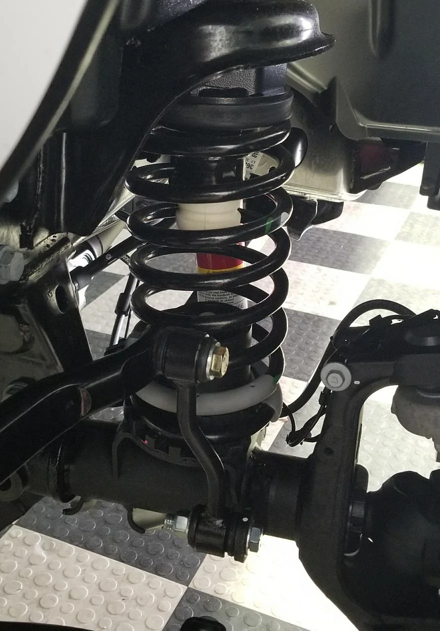

Installed mine today, ride is just like stock. My one and only complaint is the rear sway bar links are just a fraction too short. They end up touching my Rubicon shocks at full extension.
Great product for the price!

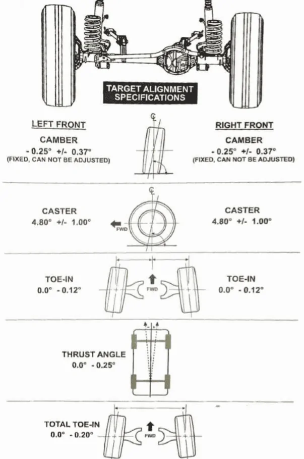

I've never had to pay someone to align a Jeep. All you can do is adjust toe in. You can do that yourself with a tape measure.
Here is the Mopar 2" lift kit post-installation alignment info...this is what I gave to my tire shop mechanic after I installed the RC 2.5" lift. Hopefully this helps other folks either in DIY alignment scenario or to provide their alignment shop folks.
I don't see any bowing in their drawing. :)

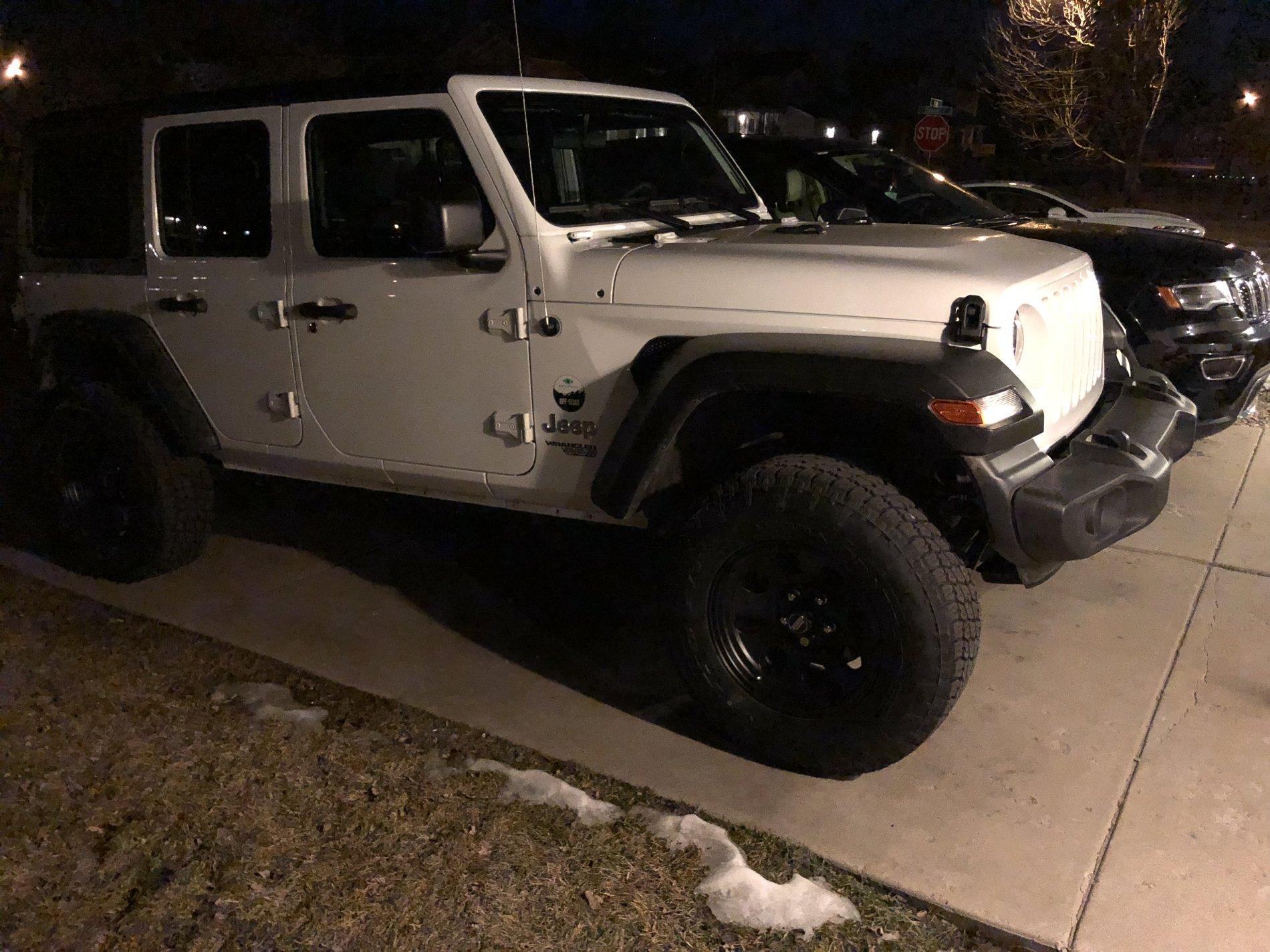

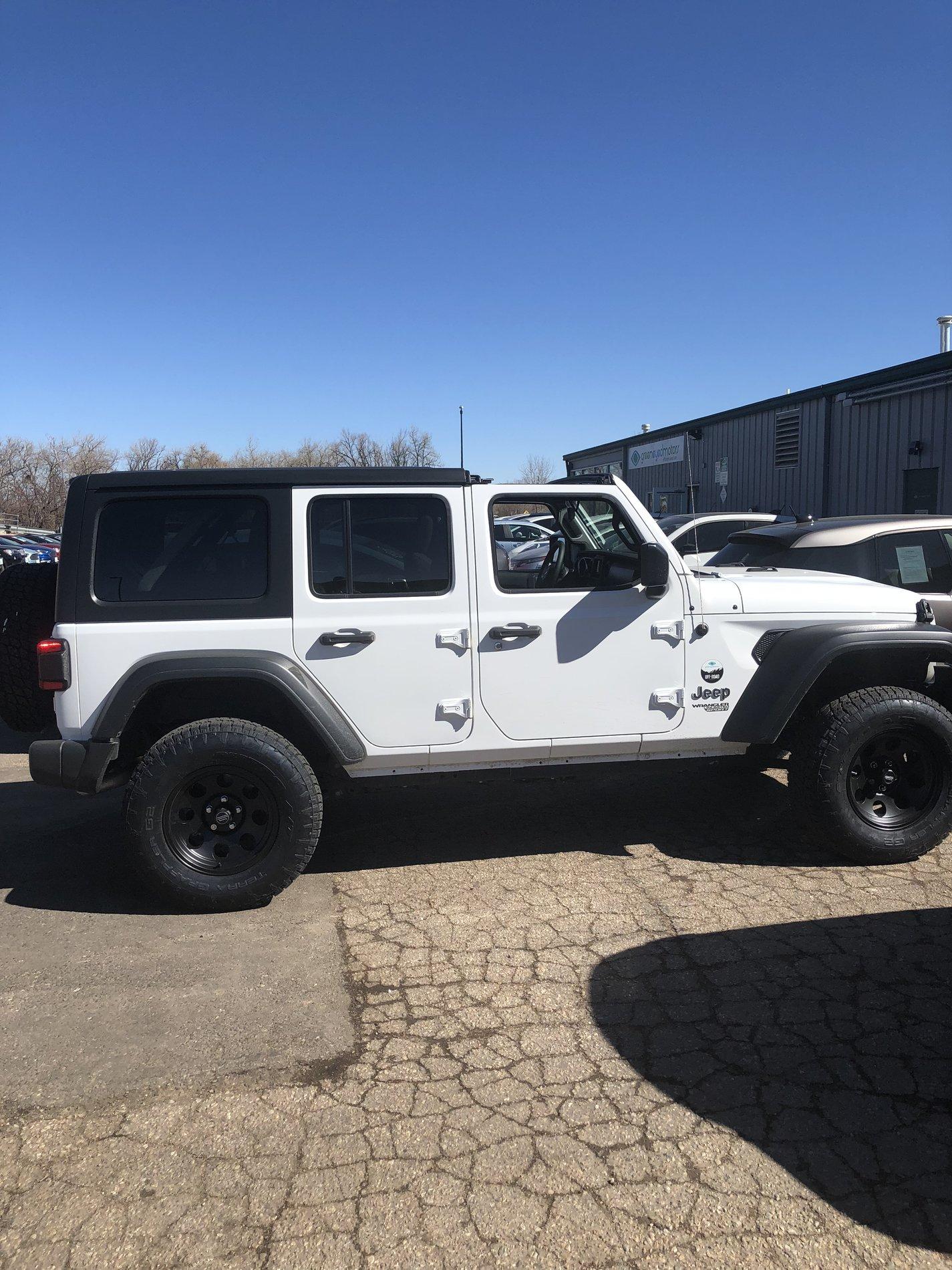

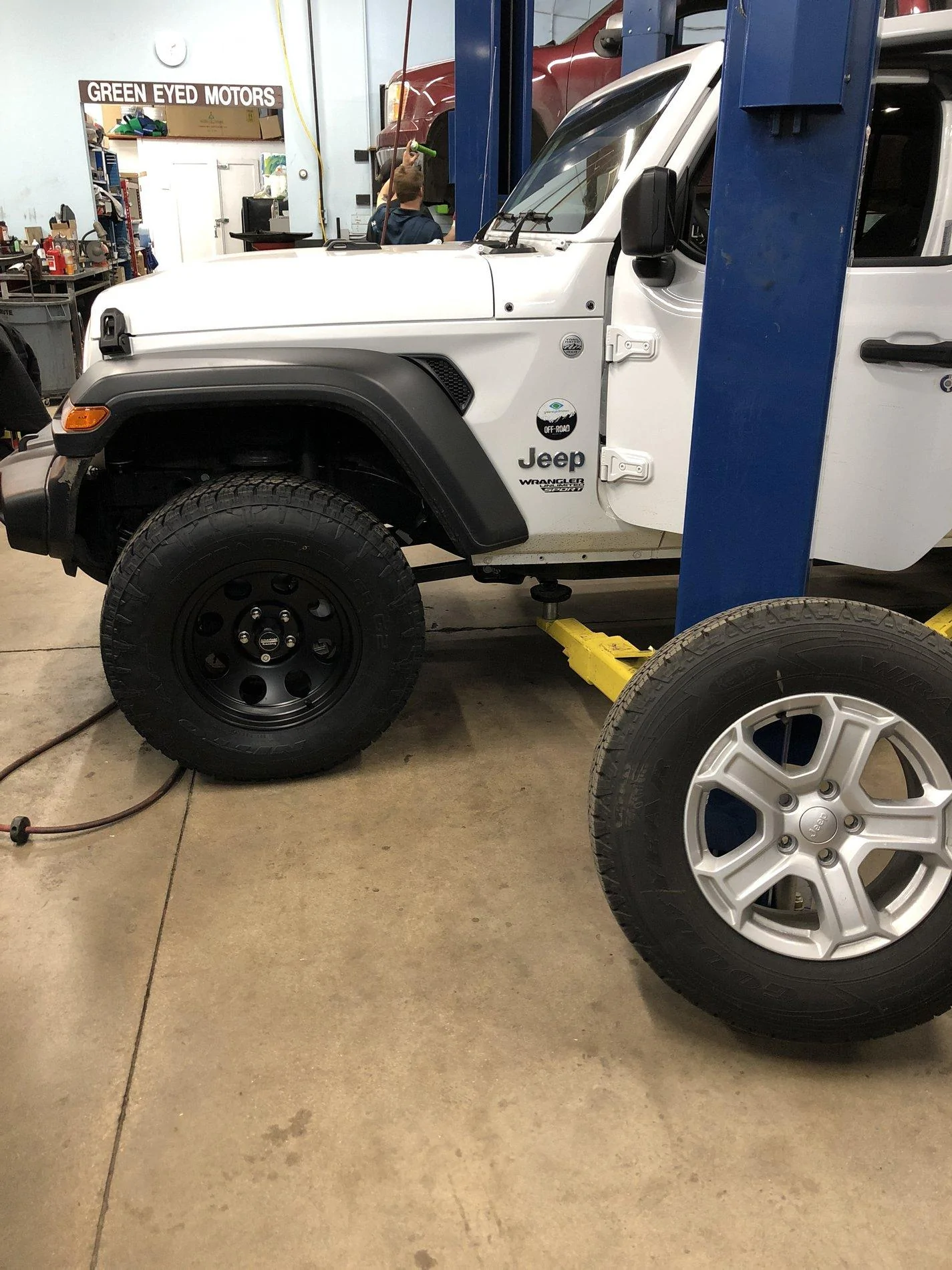

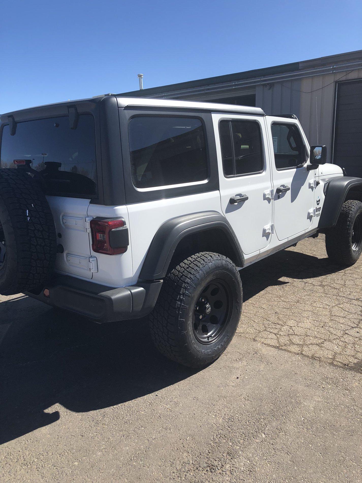

So it went on today! I’ll put better photos up soon elsewhere. My dealership has a full service center, so I was able to get it done at work. Took him 2.5 hours to install.
Looks great! I did the same lift on my bright white last week. Very pleased.

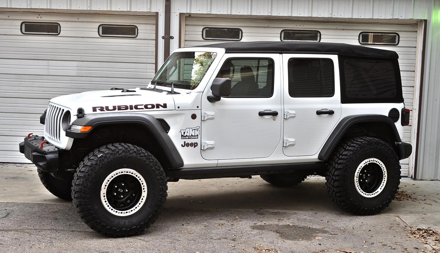

No spring bow on my kit. I installed a Mopar kit the day before for a customer and it had some fairly bad spring bow. It did ride nice View attachment 17982 , felt softer than my stock Rubi on 33s(He had C Rated 35s at the same PSI.)

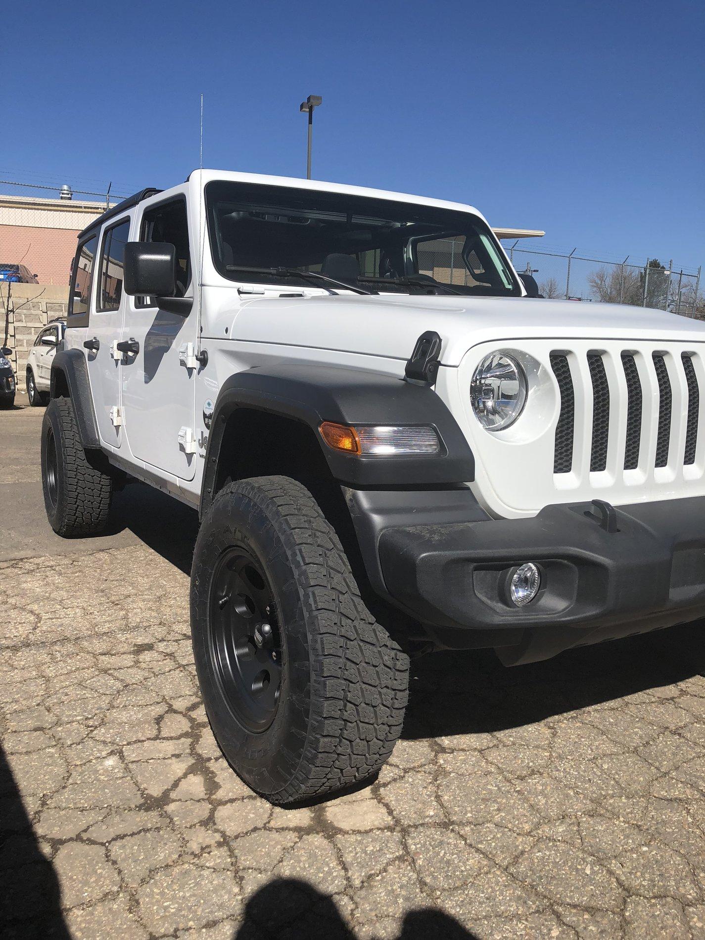

Here we go - RC 2.5", 285/70/17 Nitto Terra Grappler G2, 17" American Racing Bajas. Im sure the lift has settled by now, and I used the Mopar 2" Alignment instructions provided above. :D
Looks great. BTW spacer lifts don't settle. So what you have right now won't settle like springs.
