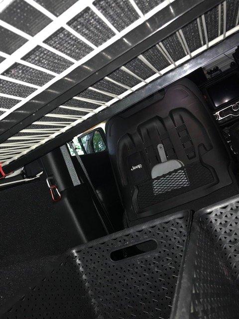

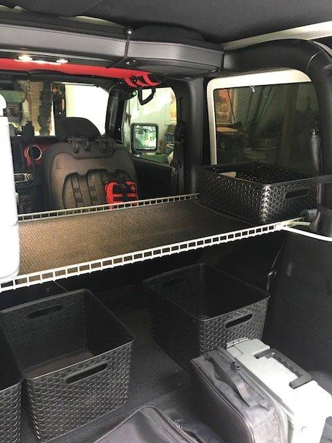

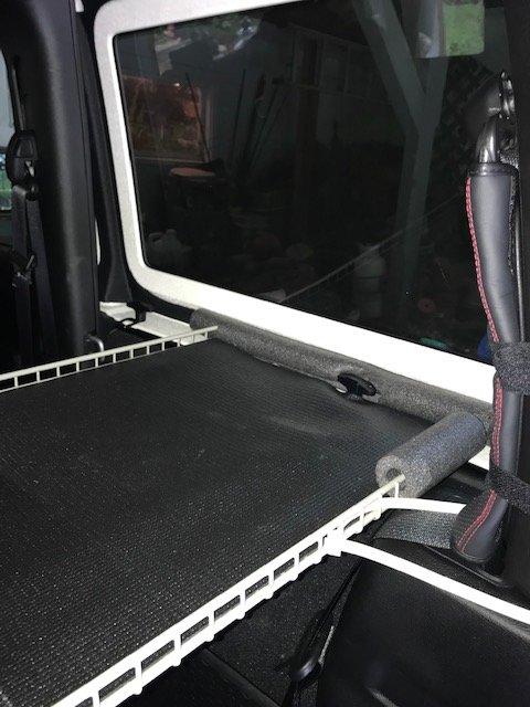

I've used this configuration in a TJ, JK, and JL and it works well in my 2DR with the back seat out. You should be able to configure to a 4dr easily. It's two wire shelf pieces 60" long zip tied together to make a 16" wide shelf, you can adjust any size from 12" to 24" if you like. Capped the ends with pipe insulation and supported the bottom with 2 shelf brackets zip tied in 4 locations underneath to prevent sagging; they are sold next to the shelving. Simple, sturdy, easily removed and or disassembled, adjustable. 60" fits snug with the pipe insulation. also large zip tied from the back for extra security. I lined it with tool box liner that is 16" wide for non slip surface. All your "stuff" can easily be secured via bungee cords to the front and back lips on the shelf-all for about $25

That’s looks interesting. How do you physically attach it to the Jeep? Or is it just sorta wedged in? Does it move around at all?

Keep the length to 60" and the pipe insulation will hold it snug. Since I use it off-road I also attached the back of the shelf to the roll bar (big wide white zip tie shown in photo) and if you want secure it to the hardtop bolt near the center of the shelf. I also used a small strip of pipe insulation at the rear where the shelf would touch the plastic near the seat belt. It's very stable-much more so if you use the brackets under the shelf to keep it from sagging. I have also done a version with the back seat installed set at about 12" wide and it works well also. Since it's adjustable from 12" to about 24" you can customize it to your specifications. With the seat out you can store a ton of stuff on and under the shelf and get to it from the front or back fairly easy. Also two Med sized suitcases will standup side by side behind the shelf and the glass and gate closes easily. I've been using this setup for more than 20 years from Ga cross country 2-3 times a year. Most of the time I just leave it in, but it comes out easily in about 5 min. Note: move the passenger seat all the way up with and the back tilted as if you were going to get into the back seat. This give you just enough room to put the shelves in from the rear (collapsed to 12"). once they are in you can adjust to your desired width and secure. Be careful not to scratch your back side windows if you don't have the foam on before the install. - Works easily with a soft or hard top.

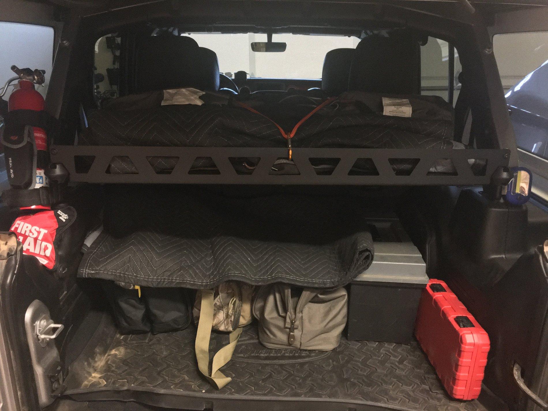

I bought a DeeZee cargo Shelf off a site on E-Bay. I wanted a roll bar mounted shelf that was removable for hauling bulky stuff. It shipped direct from DeeZee in IA (whom would not take an order from AZ on their site ??). I think it was cheaper via E-Bay than other places. I paid about $275 for this complete (with "free" shipping). A fair value when compared with others.
Kinda difficult to understand via their sales information......but after a time I came to understand their offering. You do need to buy the roll bar mount and the shelf affair under two different part numbers (as they evidently fit other models with the same set up). Anyway........I got the cargo shelf and correct bracket quite quickly and was quite impressed with the quality of this shelf. It's a bit cumbersome to assemble.....but it's quite straightforward and very versatile. I measured 20.5" gap under my shelf when it's installed.
It would be easy to remove this shelf in order to haul some bulky items. Now I have a spot to easily access my fold-up chairs, coats and other light gear which is stowed on top of this shelf. Quite happy with this affair. No loss of vision for me out the back window. My tools and trail gear fit nicely under the shelf......as well as my big cooler. Also safer with the shelf keeping some of the "heavies" from flying about should a bad happen. Wish I had a better pic for you. I'd buy this again.

Here you go.....but be sure to do the research and find the roll bar brackets for the JL. You will need two SKUs to have the complete deal. I think the brackets are about $40.....and actually they could be used alone with a sheet of plywood and a couple of stiffeners......and you could save some real dough......If your that kinda guy.
The DeeZee roll bar mounts are very clean and model specific. Remove two pieces of plastic trim from the roll bar.....attach bracket with provided screws, and I remounted the plastic trim after grinding the relief area from the trim on my abrasive grinder. Nice, very neat and not a buncha excess metal, etc. I think the shelf is rated to about 200 lbs......and my coolers and tools and totes will fit under the shelf. Lots to like for an affordable price. I'd buy this over the others I researched.
