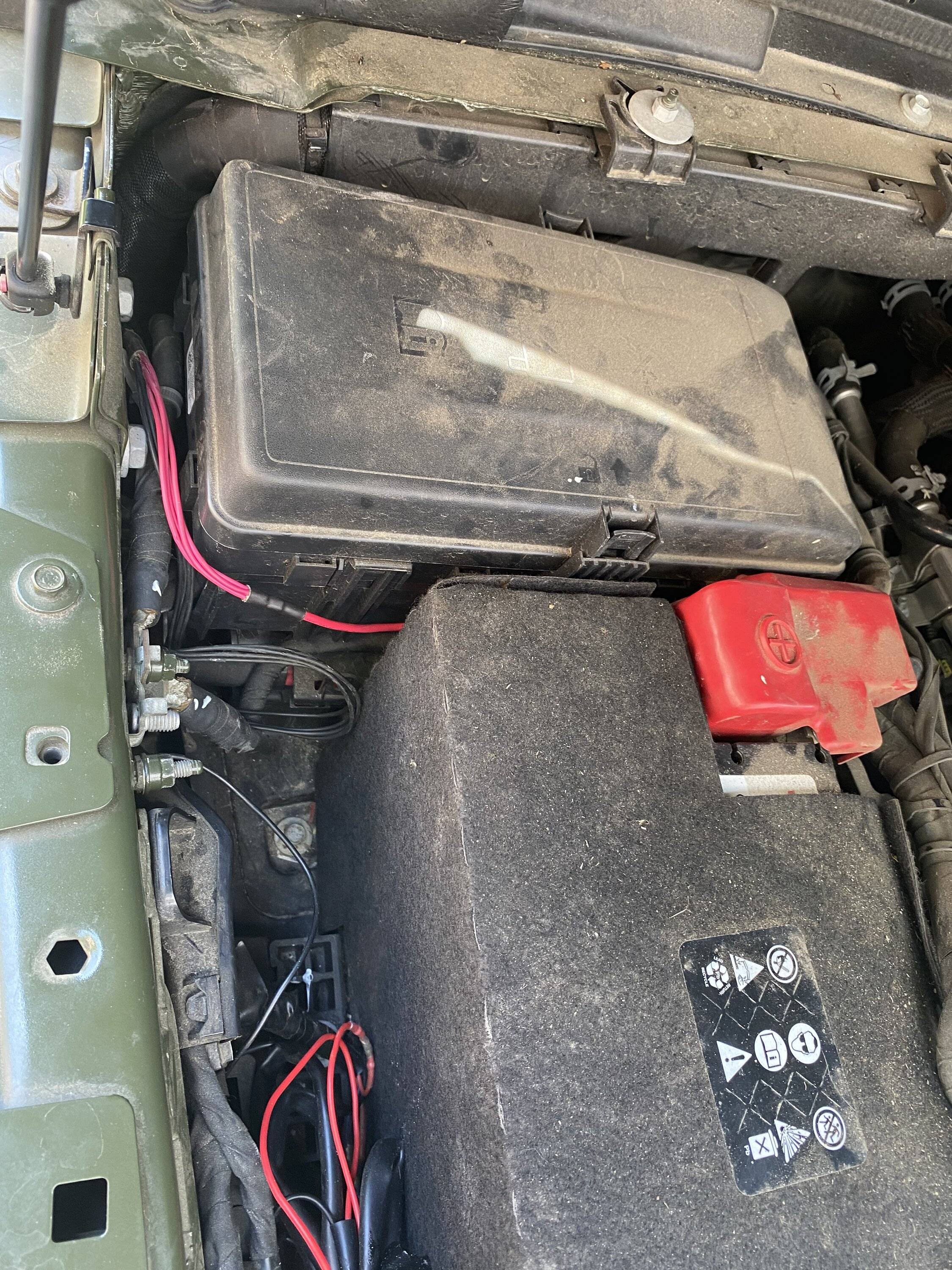

Did you run the wires between the fuse box and battery or off to the outside of the battery? I have a tray that covers the space between the fuse box and the firewall and then there's the battery tray. Between the fuse box and battery is a cover plate covering a wire loom, maybe the wires to the aux battery. Can you take a picture of the area where you ran your wires so I can compare my setup under the hood.
This is what worked for me… comes up near firewall.
Jeep Wrangler JL Rockslide Engineering Steps Gen 3 4515C7F1-5CF0-4C49-B454-98467C30A69A
Awesome, thanks. I found that opening yesterday where you ran your wires. I was hoping it would be close enough to make the connections.

Sure no problem.
like I mentioned above, the 10mm bolt and wire clamp they included for frame rail is not needed. I needed a few inches of slack so just zip tied rse harness to factory harness on top of rail.

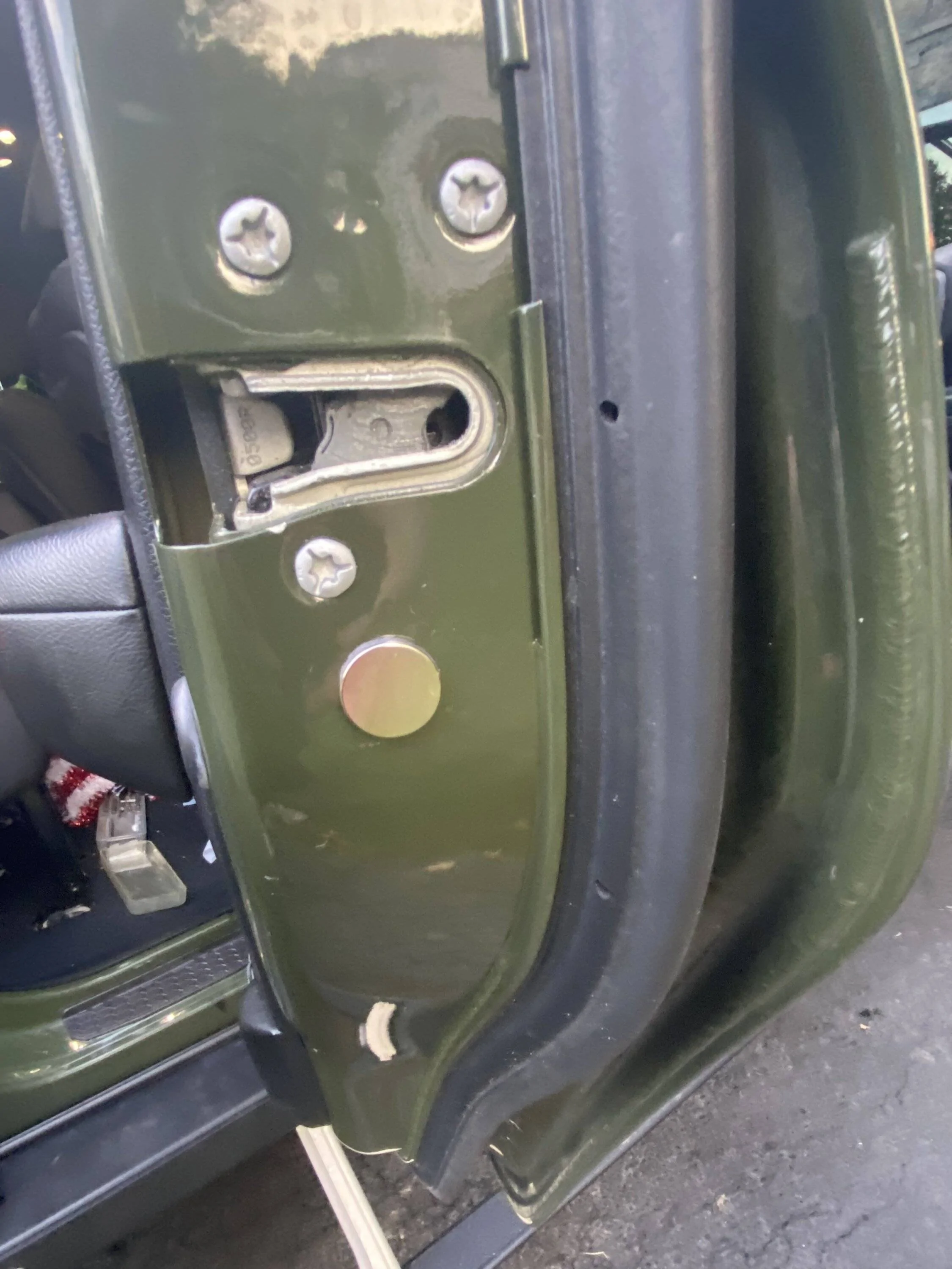

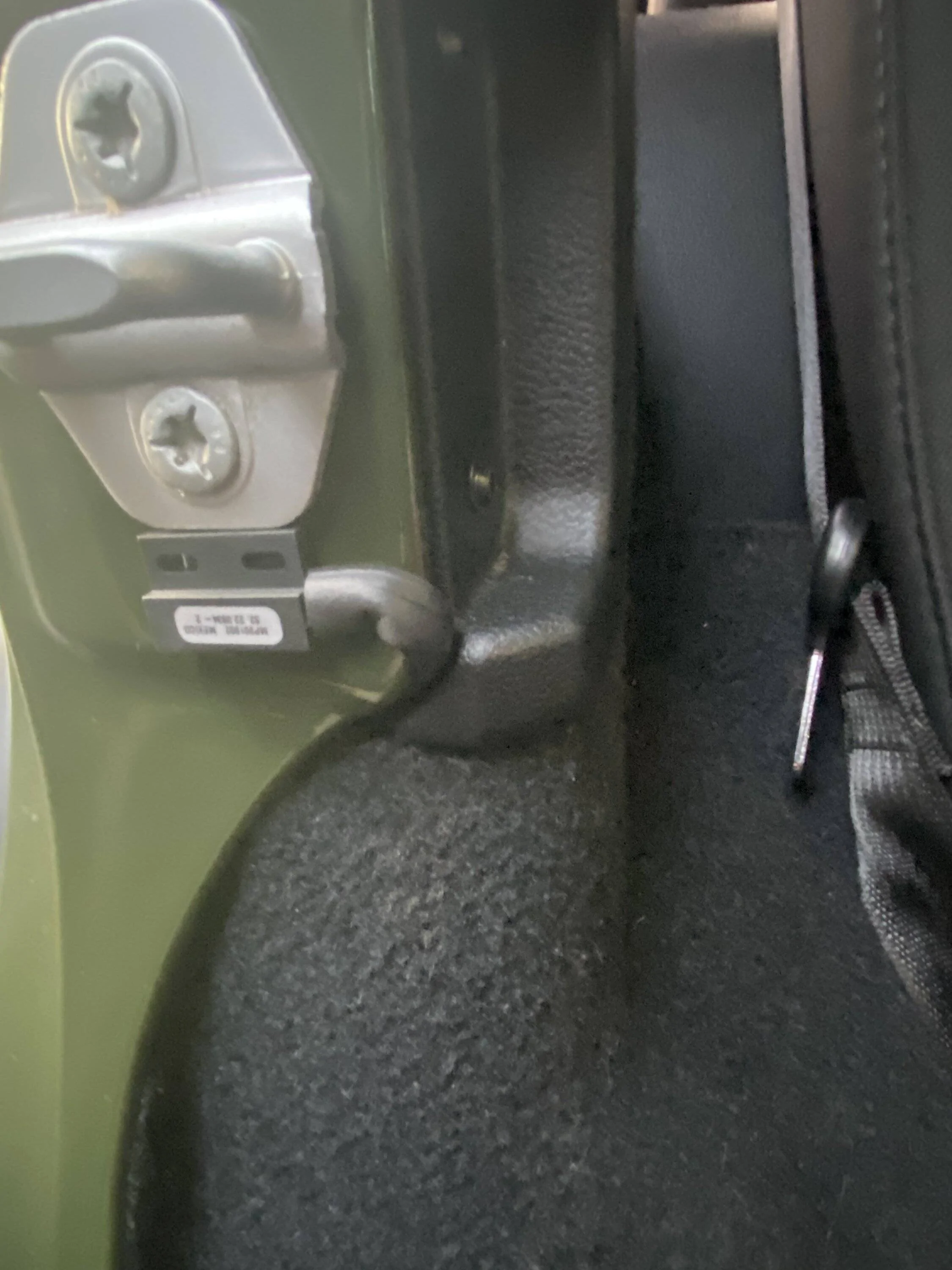

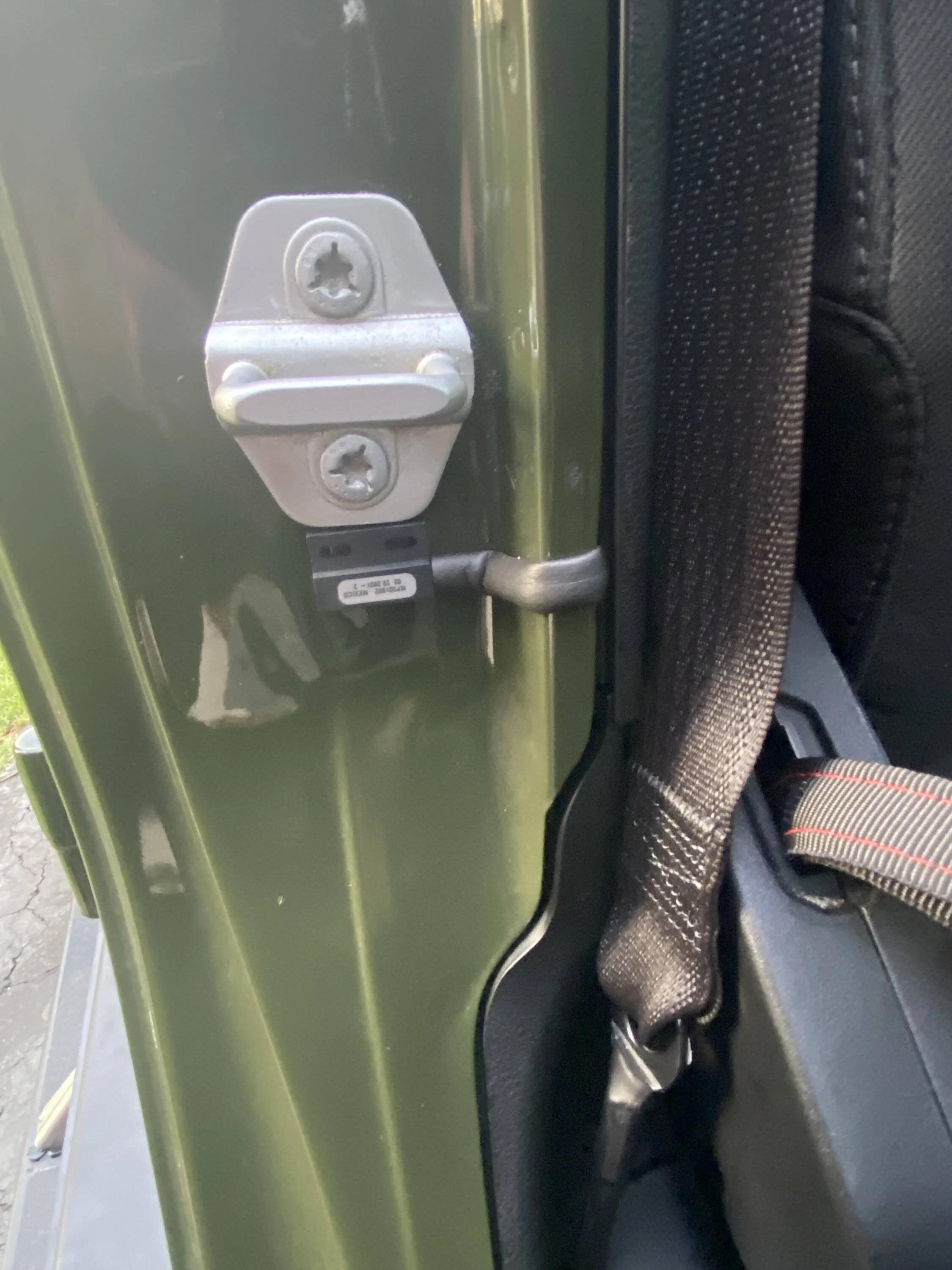

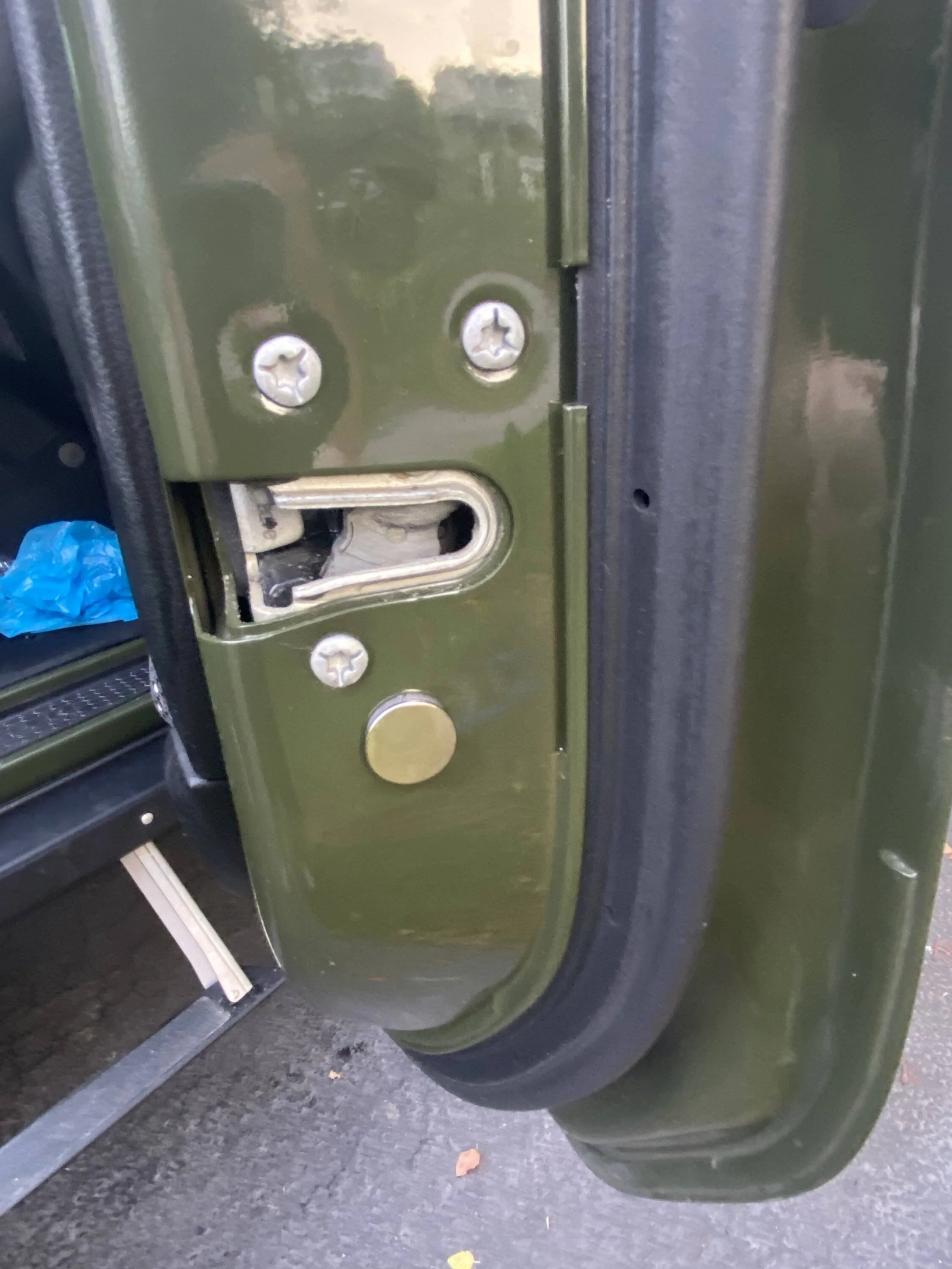

yes the instructions are wrong.
the wire isnt really pinched enough to cause any issues. Heres pics of front and rear. Use masking tape to make sure your magnets are aligned before perm attachment.
I just did my armor kit as well it was a PIA to align holes… came up w a better way to install if you are going to do that as well.
First two pics are front.
Jeep Wrangler JL Rockslide Engineering Steps Gen 3 37A7883D-6AF3-4309-A961-71759DB39555
Jeep Wrangler JL Rockslide Engineering Steps Gen 3 7A1AF946-2150-4CB9-B756-679710B4E20C
Jeep Wrangler JL Rockslide Engineering Steps Gen 3 702ED855-F9D8-4BB6-9202-40B81DC70F59
Jeep Wrangler JL Rockslide Engineering Steps Gen 3 F1EE72DC-DFF4-4E35-A6BD-0A6678989835
