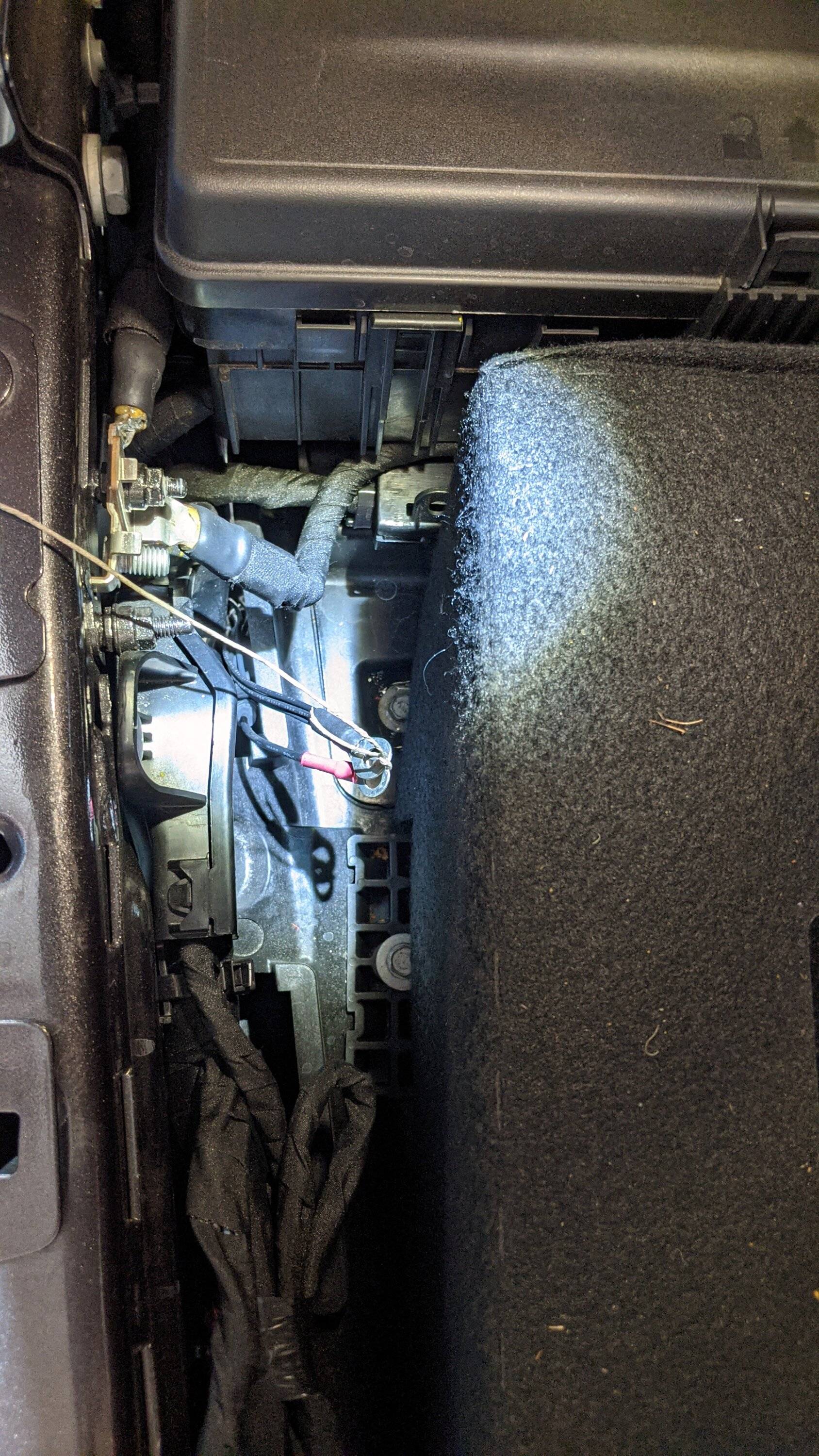

My fuse box is behind my battery at the firewall. It doesn't look like there's any space behind the fuse box. I might have to lean my hood open to get a better view.
In the dark have someone shine a light from underneath while you look from above and the best routing will be more obvious.

I am trying to run the wire harness on my JL and I am having a hard time getting the wires harness into the engine compartment. Are the wires ran up between the battery and the fender or behind the fuse box?
Hi I just installed mine this past week and I ran the harness in front of the fuse box and out on top of passenger frame rail.
I found it easier to run the cable up from bottom than down. I used a wire fish line. Make sure before you zip tie wires on rail that you leave enough slack for the cable to reach positive battery terminal…. Mine shifted and I removed the cable clamp RSE gives you to bolt to frame to give me a bit more slack.
good luck!
good luck!
Did you run the wires between the fuse box and battery or off to the outside of the battery? I have a tray that covers the space between the fuse box and the firewall and then there's the battery tray. Between the fuse box and battery is a cover plate covering a wire loom, maybe the wires to the aux battery. Can you take a picture of the area where you ran your wires so I can compare my setup under the hood.
Yes will do tomorrow when theres light.
