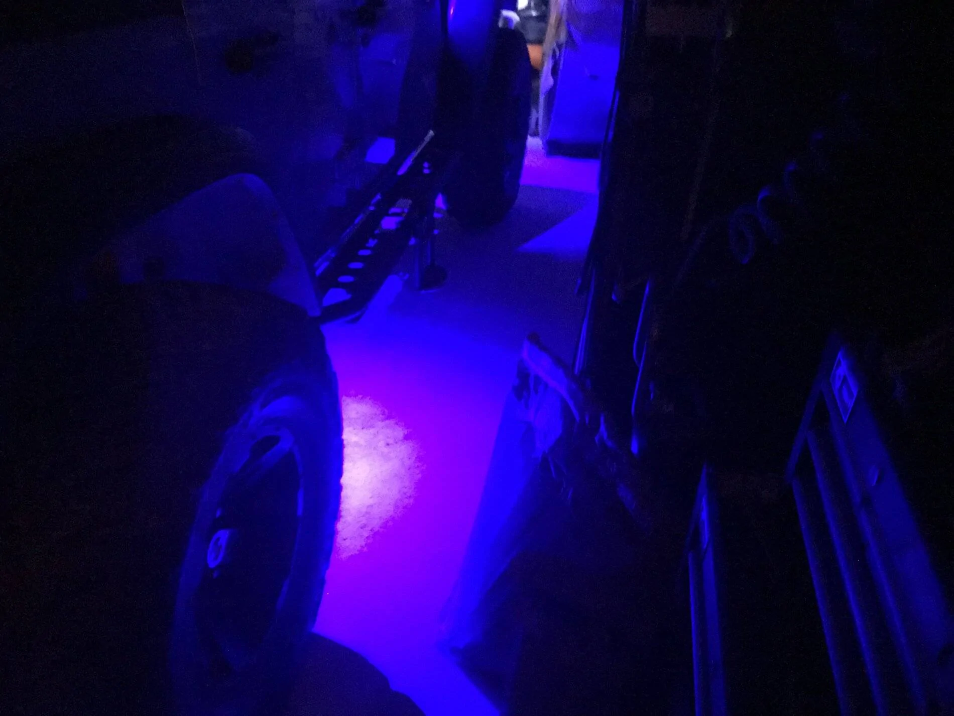

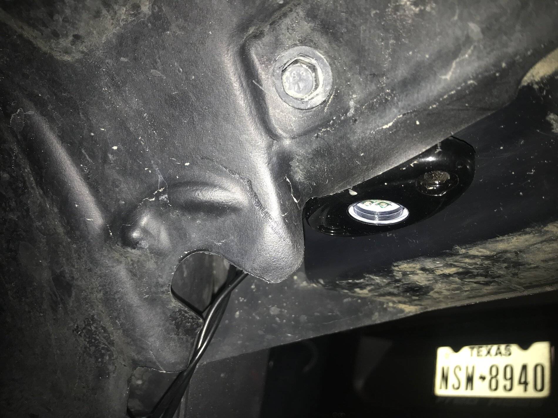

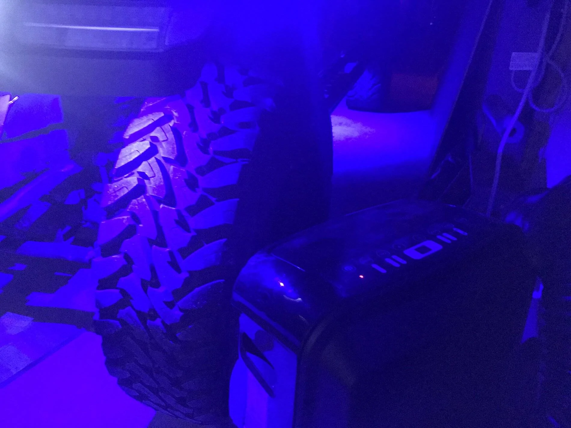

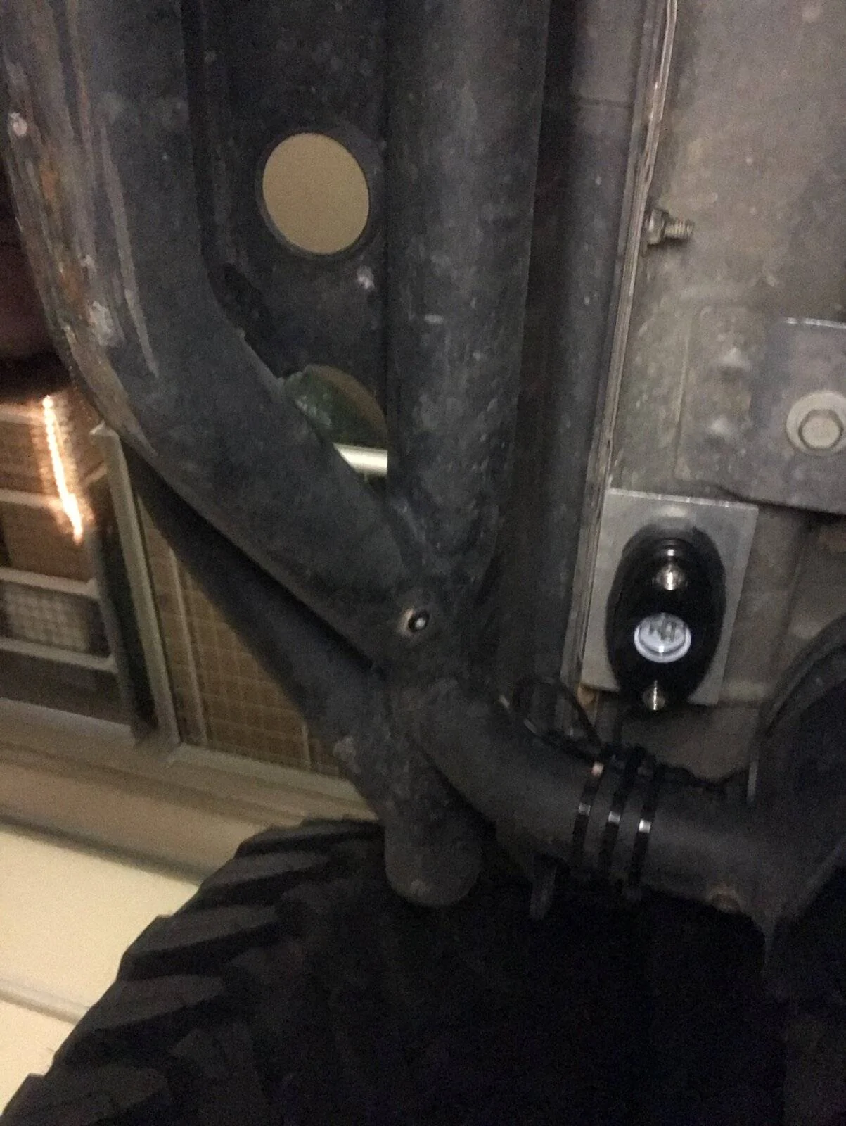

My daughter got me some inexpensive rock lights and I installed them not to long ago. I actually used 3m automotive double sided tape for the front under the turn signals. In the back I made a bracket out of some angle aluminum bolted to the slider bolt.

Well, looks cool as heck. On the rear, did you drill into the frame?

I bolted the bracket on with one of the slider bolts. You can see one above the bracket. Rubicon sliders and stock running boards have bolts that go through the pinch seam holes to mount to the body. If you have a Sport without running boards, there will just be the hole.
