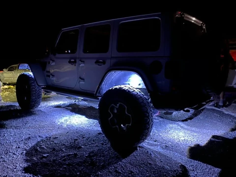

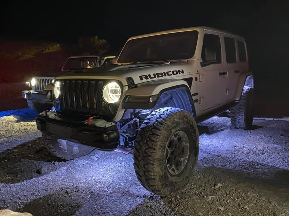

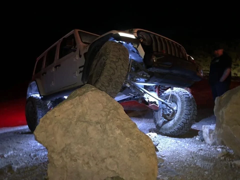

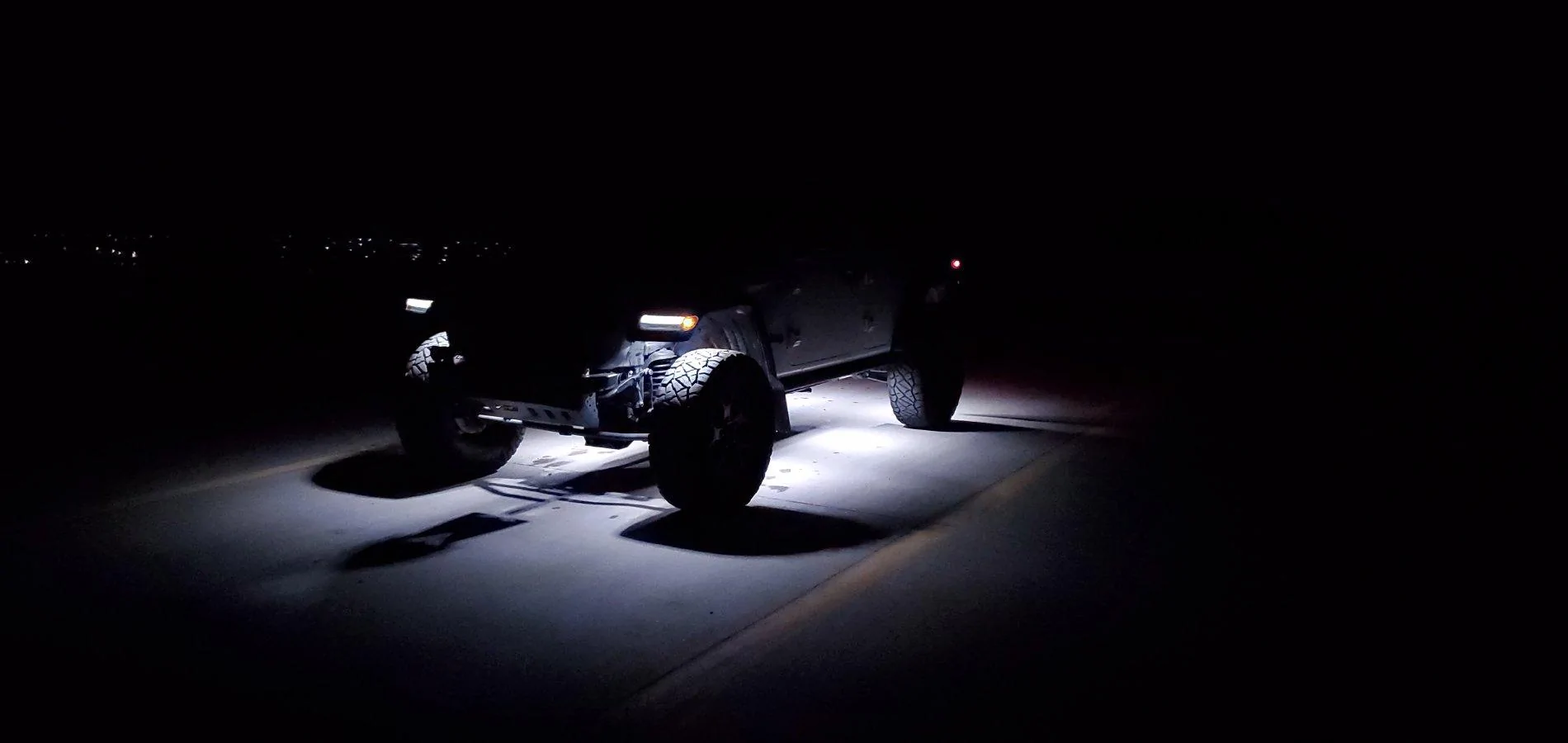

I installed these because I’m a cheap a55. 8 pods for $130. No complaints so far. Super bright and can turn on and off with my aftermarket AUX buttons or with cell phone. Can change colors through Bluetooth on cell phone also

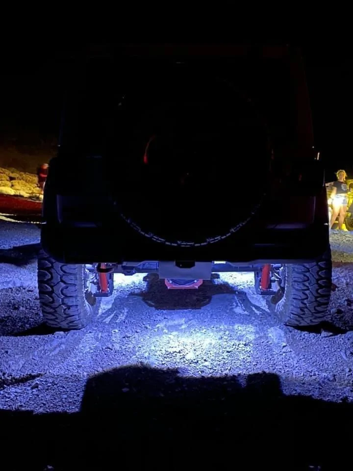

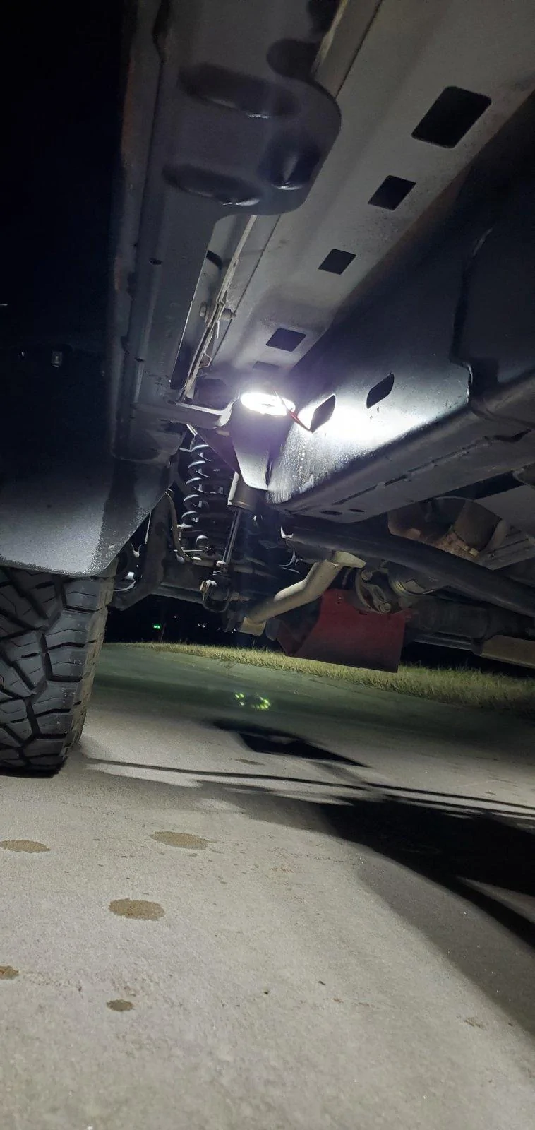

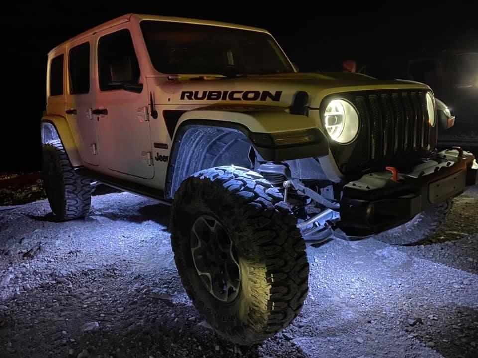

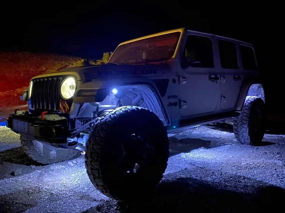

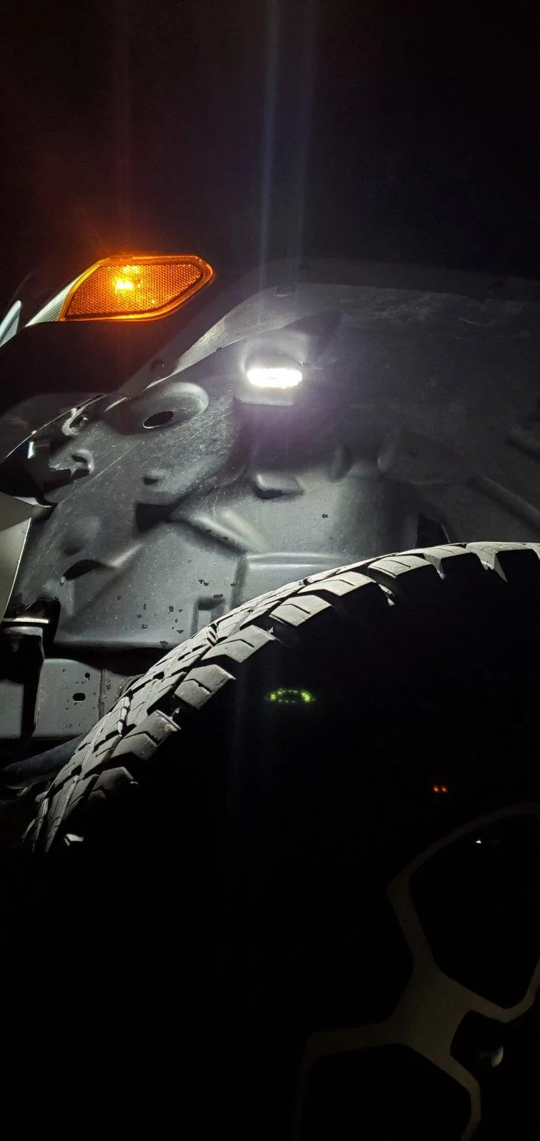

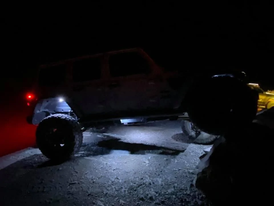

I just installed some Lux rock lights. I need to move my fronts to shine down more. Maybe make a metal plate and attach that to the plastic inner fender wells. Other than super happy with them. Ordered on a Friday and received the following Friday.

I installed these because I’m a cheap a55. 8 pods for $130. No complaints so far. Super bright and can turn on and off with my aftermarket AUX buttons or with cell phone. Can change colors through Bluetooth on cell phone also. Video at the end of pics

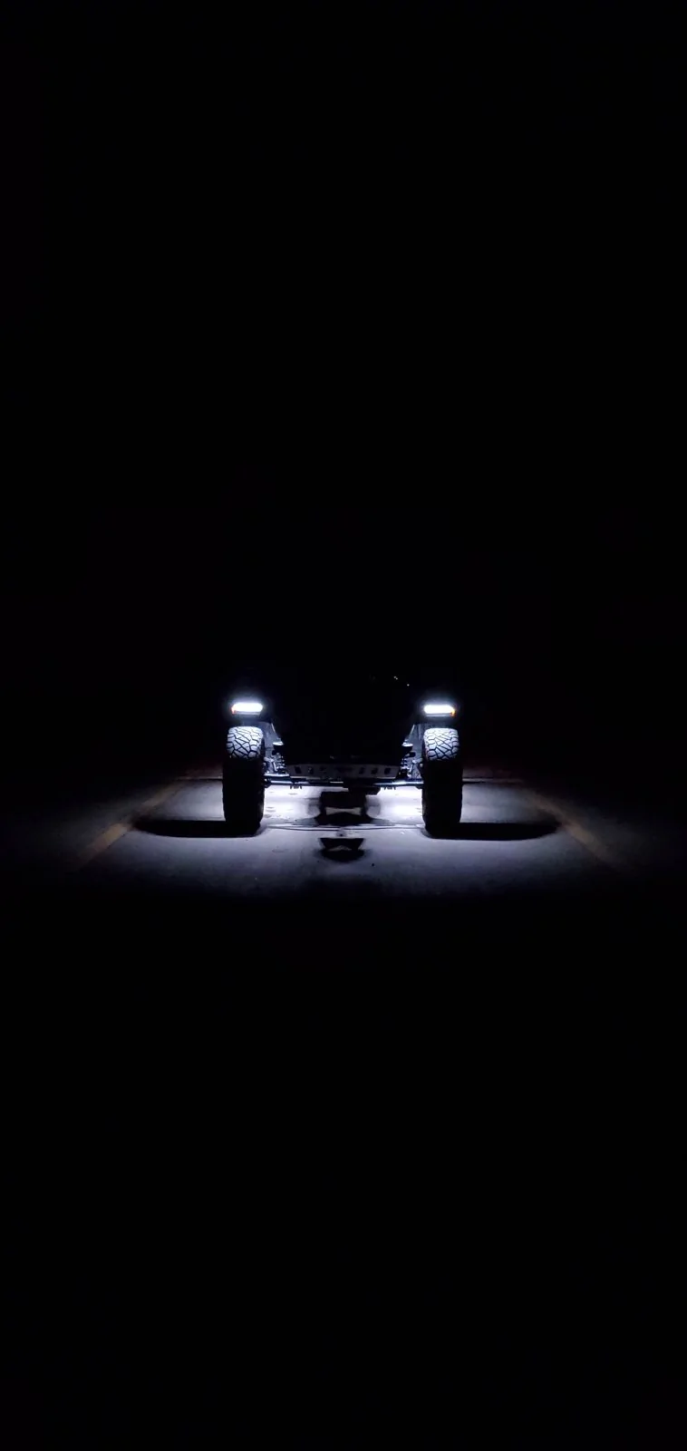

8 KC Hilites Cyclones

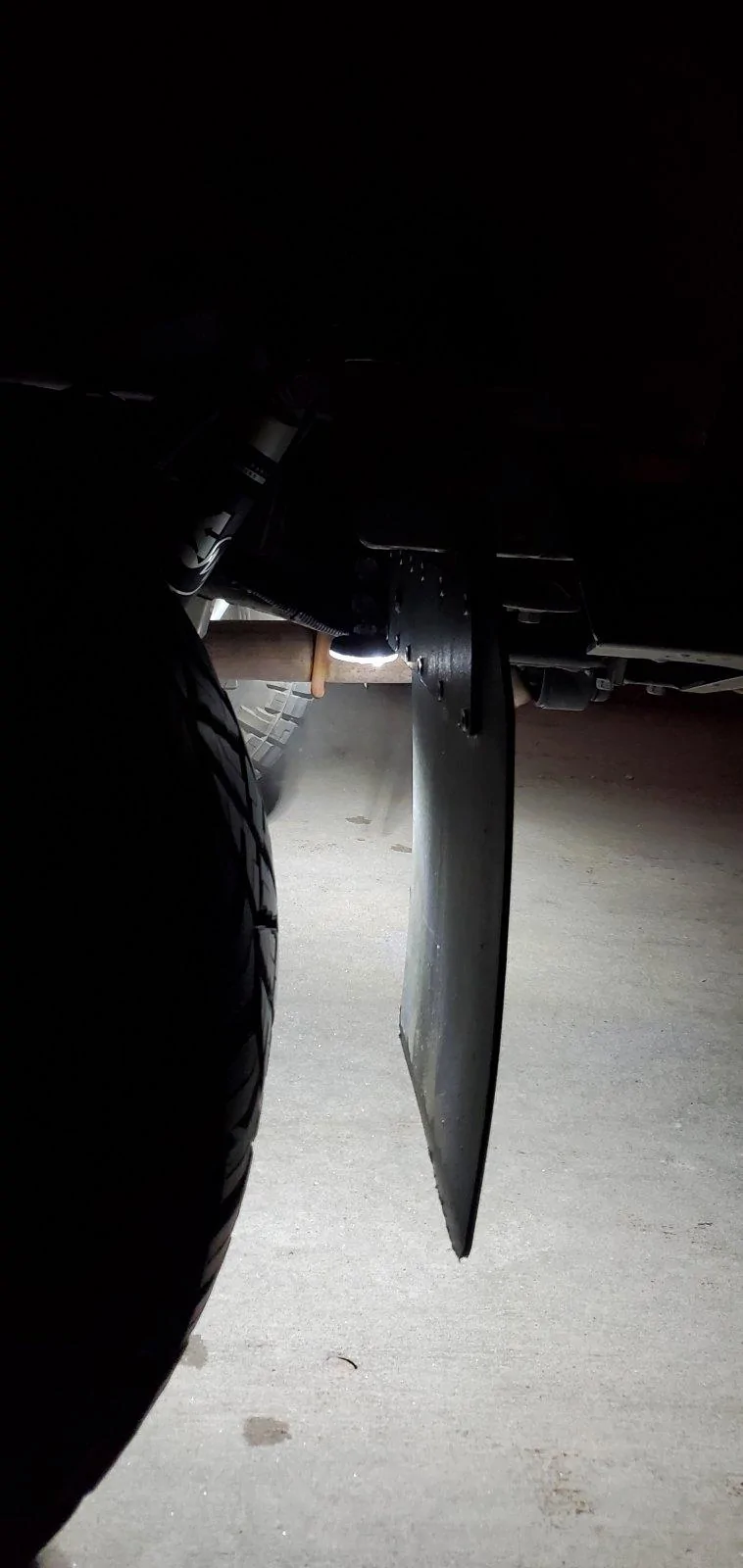

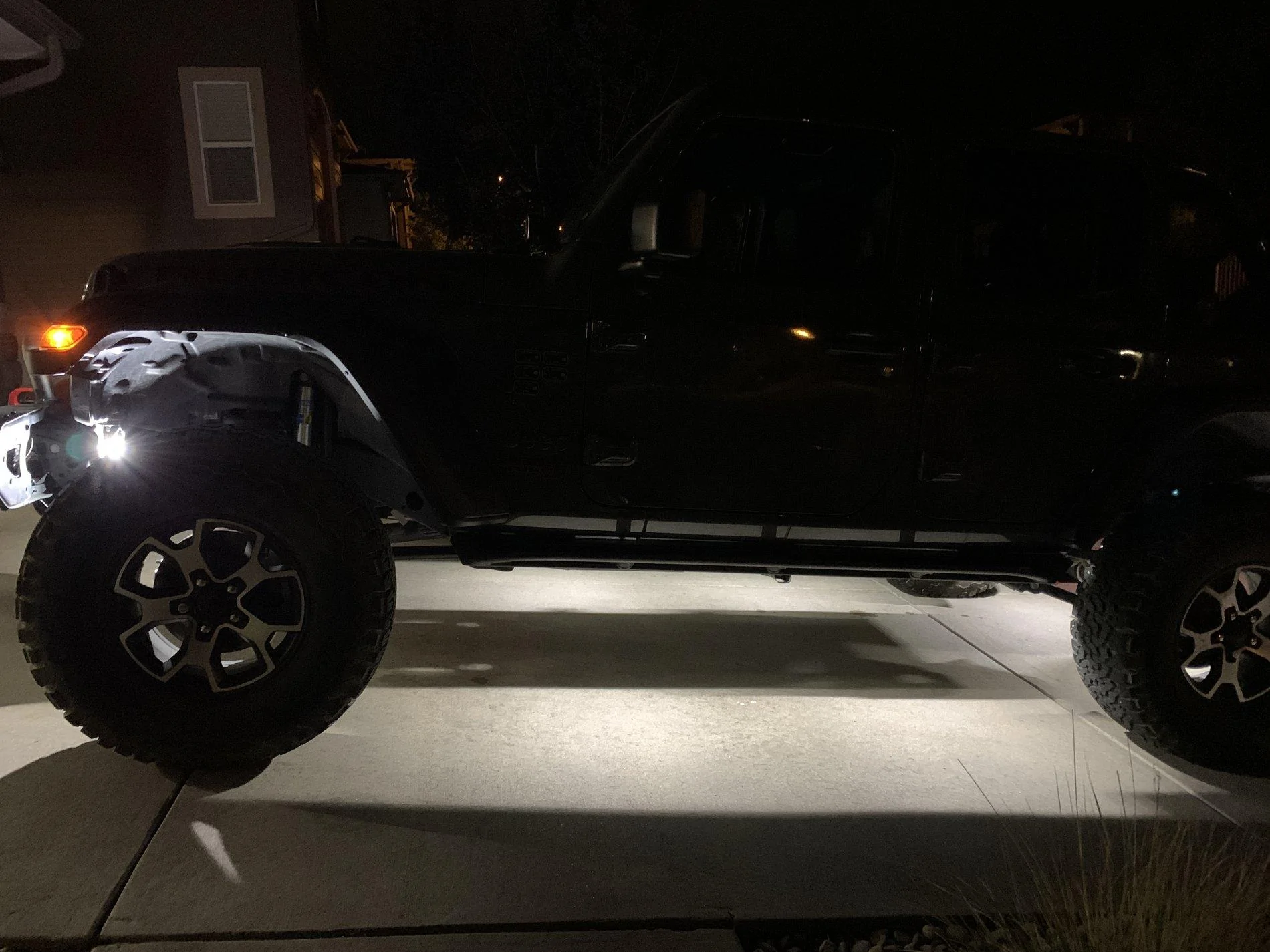

I'll take some better pictures when I get home later. But here's what I have.
For the front pair, I used a fender mounting bolt. I had to use a 5/8th steel spacer so it would sit level and wasn't sitting against the liner. For the 2 on each side, I used the included Z brackets and mounted the forward and rearward most mounting bolts for the rock rails. The rears are mounted with the included L bracket up against the frame where the factory bumper bracket bolts to.
Big help. Much thanks!
