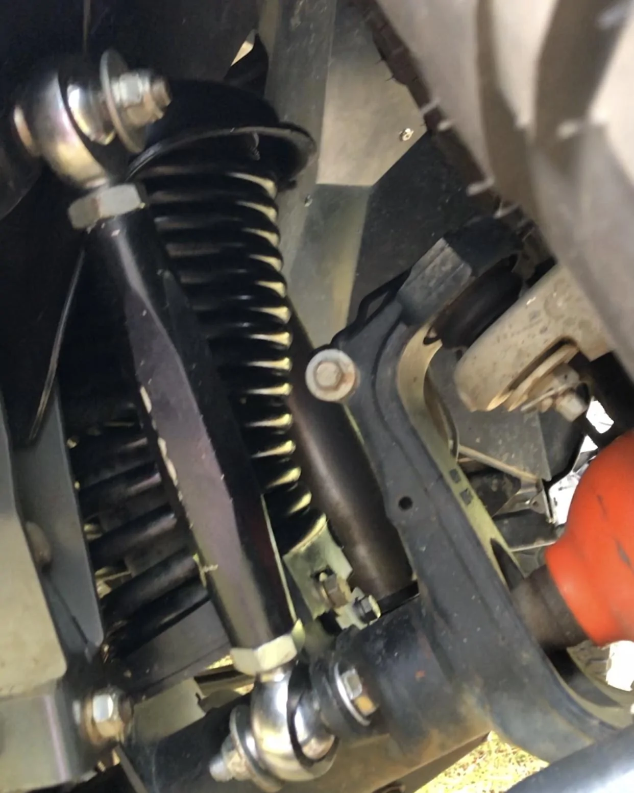

IMHO , it doesn’t matter what lift you have, as long as your 2.5” and up of lift you’ll benefit . The no limits are made specifically for the Rubi elect disco. It allows the misalignment that occurs when links are still connected but the sway bar is in disco mode. The Rubi’s have a lot of articulation right off the shelf, and the more lift the more misalignment. Here’s pic of stuffed side and drooped side...

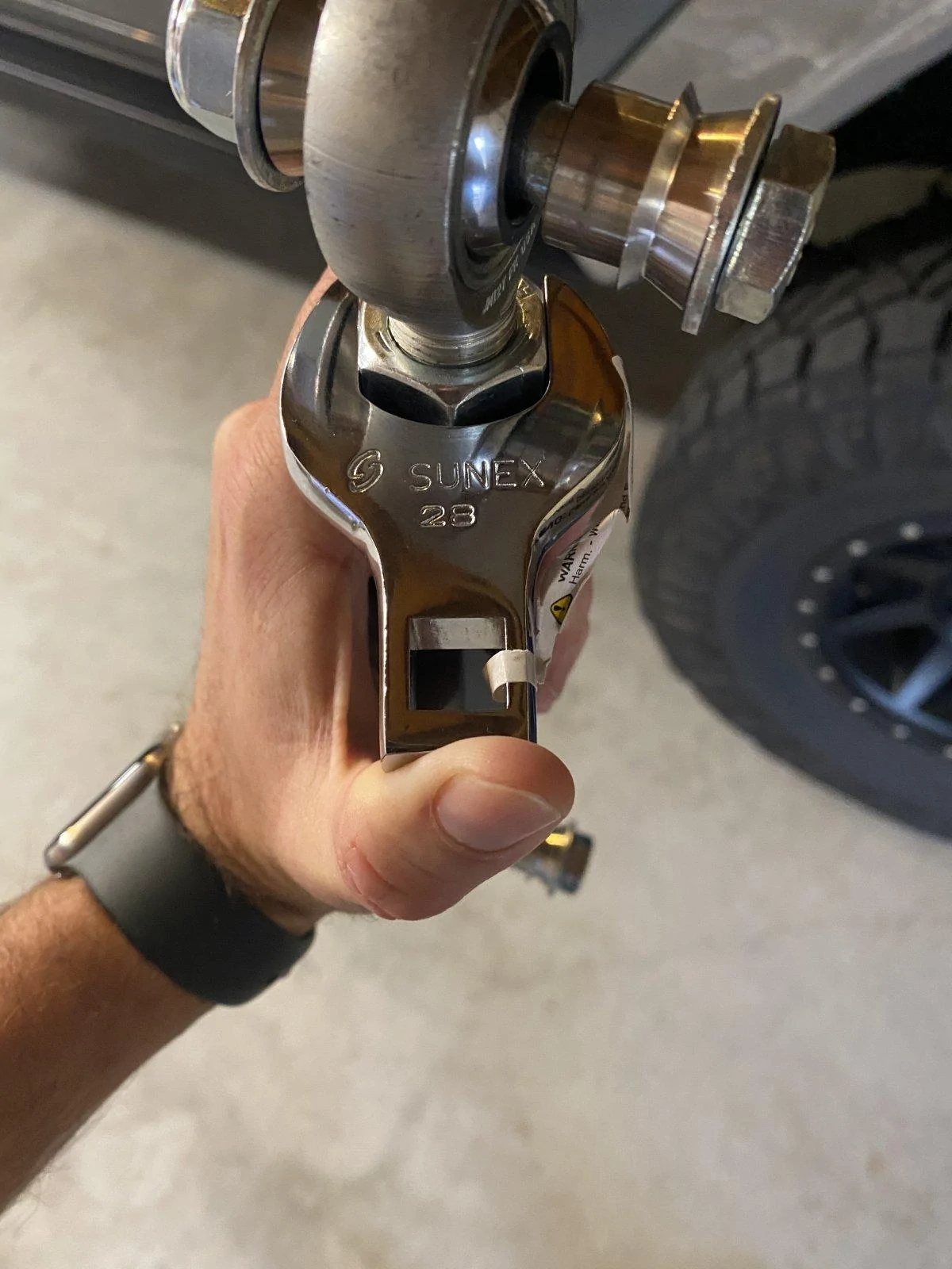

What did you guys get to torque down the jam nuts? It is a 1 1/8” and I can’t find a crows foot anywhere in that size.
I have two very large adjustable wrenches I use for all of my RK jam nuts.....I'm not a fan of crows feet

This.......
Limited-time deal: Sunex 9720A 1/2-Inch Drive Jumbo SAE Crowfoot Wrench Set, 1-Inch - 1-3/8-Inch, Fully Polished, 7-Piece (Includes Storage Rail) https://www.amazon.com/dp/B000LQG3XQ/ref=cm_sw_r_cp_api_glc_fabc_dlT3_Vko-Fb0X32PGT
Thanks, I was trying to no buy a set that I likely wouldn’t use. But may have to
I fully agree, all the times I’ve used them before didn’t like the feedback from my torque wrench but those were 1/4 and 3/8 drives.
Yeah...... crow foot wrenches suck, but I still use them on the big stuff, like my lower control arms, which is torqued to 250 ft lbs. Had to up grade my torque wrench , my old one only went up to 200.....:facepalm:

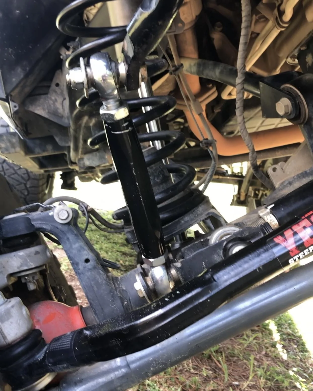

Oh man, I never did update that. We ended up doing a custom application setup for a customer a while back that used the 3-5" No Limits links. That one had a 14" travel coilover in the front and went 48" bottom of tire to ground on a forklift. I don't have photos of that one, that customer is not ready to show people his jeep yet, Hopefully soon.
But, here is a photo of our shipping manager's JT on a 40" stand with No Limits links without binding and you can see that the heim joints have misalignment left in them
Are those the same ones that are now for sale on your website? The 3-5” lifted ones?
I also have a 14”long travel coilover setup and want to get these ordered stat! The ones Evo included are total garbage, no misalignment whatsoever, just a super long (too long) link that’s at a terrible angle.
