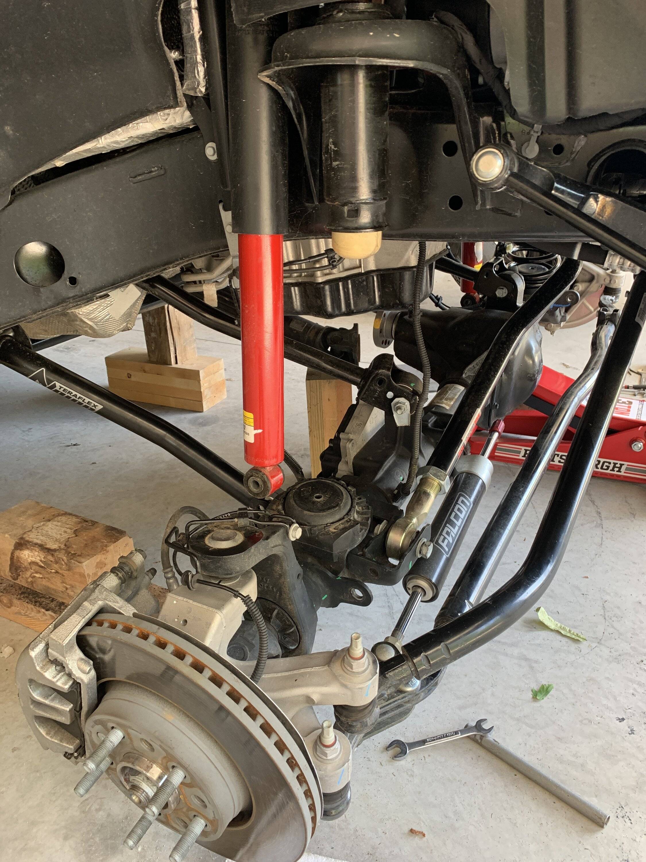

Track bar not holding it, looks like the shock is still connected, probably just the pic…
Can't tell if the shock is connected either, hope it's off lol. But yeah, I don't think track bar is holding it, I'm thinking it's trying to shift axle to driver side but since the jack's on that side putting pressure it can't shift that way to continue down. Jack technically stopping it, but can remedy by pulling track bar off the axle bracket. Though, if the shocks are still connected, that'll do it too.
Yeah, needs the jack closer to drivers tire……

Disconnecting LCA brought it down some.

I’ll move jack closer to tire also.

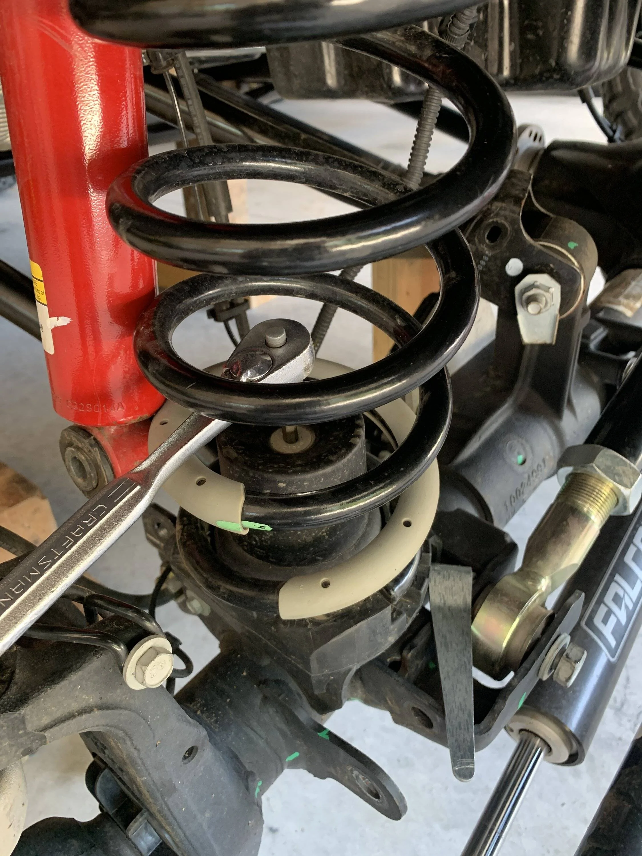

Once I remove this stopper I’ll probably have it!

Jeep Wrangler JL Right side front axle not dropping enough? image
