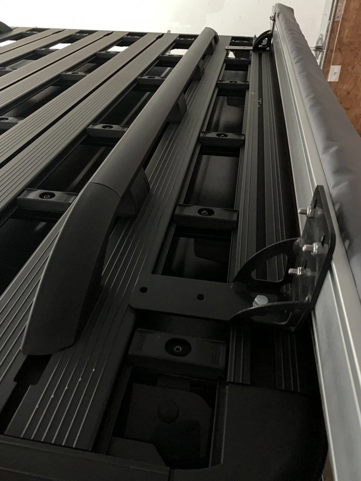

I've had the ARB awning mounted on the pioneer platform since the beginning of summer 2020. I originally used the AWB quick release awning brackets since I was planning on removing it while parked overnight(s) in Colorado on vacation. I ended up never touching the brackets, so I replaced them with the ARB universal awning brackets, and they've been up ever since. We've gone all over the place and those brackets haven't moved at all. Here is a quick pic of the way I have them mounted. Check out my previous post to see it mounted from afar.

Thanks! I will use the ARB universal awning brackets as well. Did you need any special hardware to attach them or just nut/washer/bolt?

I just used one M8 bolt/washer/channel nut that I had for each one. Keep in mind mine is the 2000x2500 awning. I think it's the perfect length for the Jeep/pioneer platform, but if you get the 2500x2500, ARB recommends using 3 brackets. I also bought extra stainless M8 bolts and channel nuts from Amazon, and they come in handy when adding stuff like this!

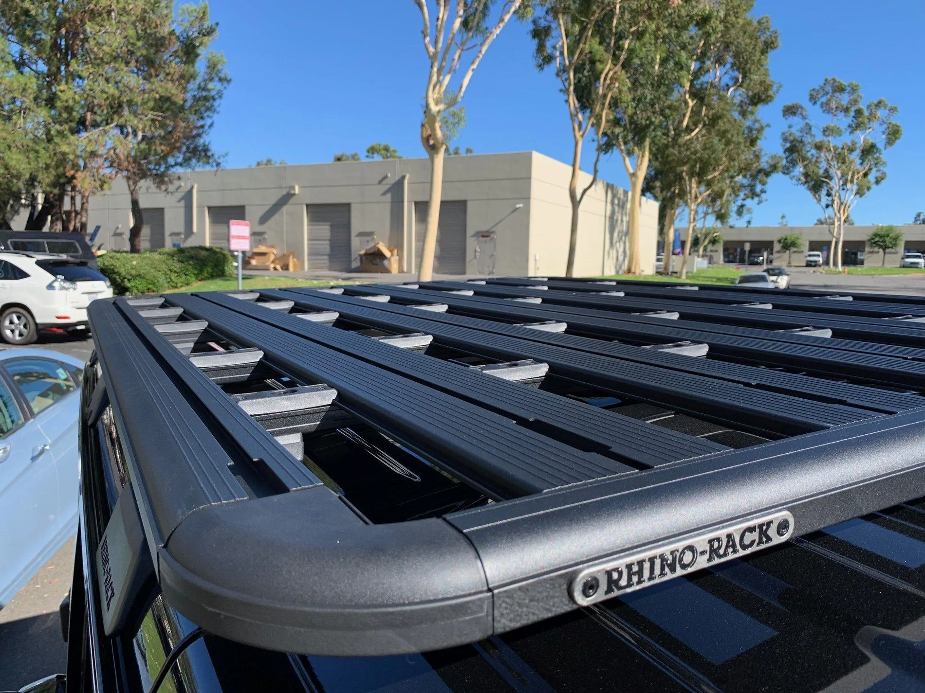

Thanks to the great guys at Rebel Off Road, I got my Rhino Rack backbone installed! It looks incredible and I can’t wait to load it up and go camping!
