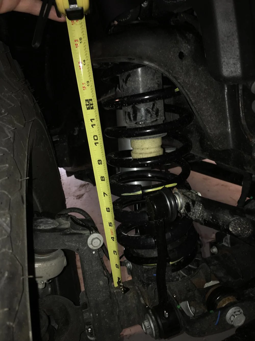

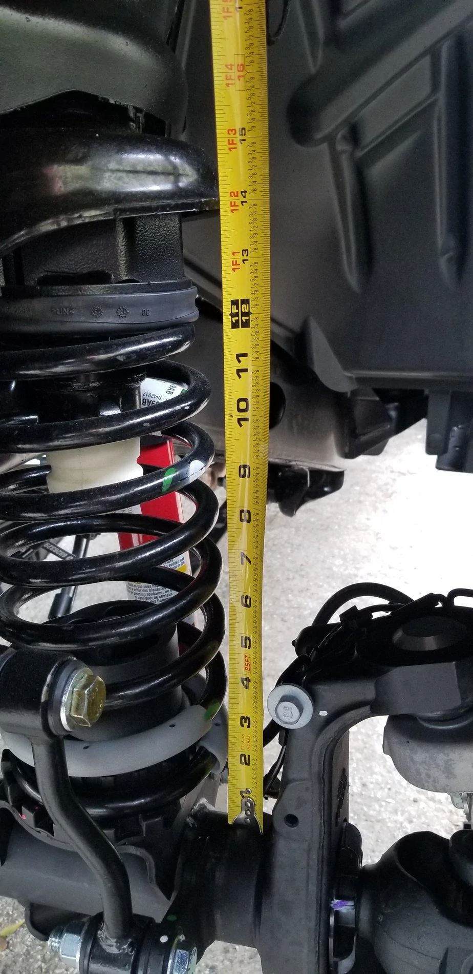

Everything worked out great for me: steering was well-aligned, the lift actually achieved the 2 and 2.5 inch increase (I measured the before and after).
