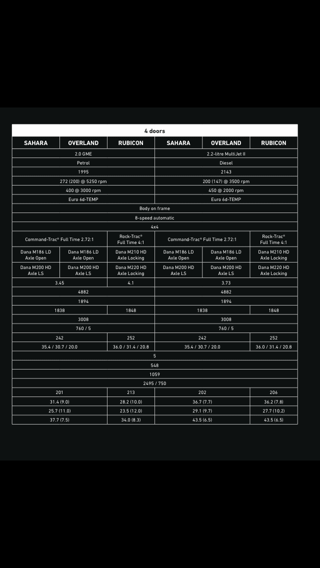

I have a Sport JL 2.0 with M186 Front Axle / M200 Rear Axle (Front is broken). Finding a new front axle is tough where I live, however, I could get my hands on 2.2D rubicon axles (I think they are Dana M210 Wide Front Axle / Dana M220 Wide Rear Axle).
Would it be possible to replace one or both axles on my Sport with ones from mentioned Rubicon?
