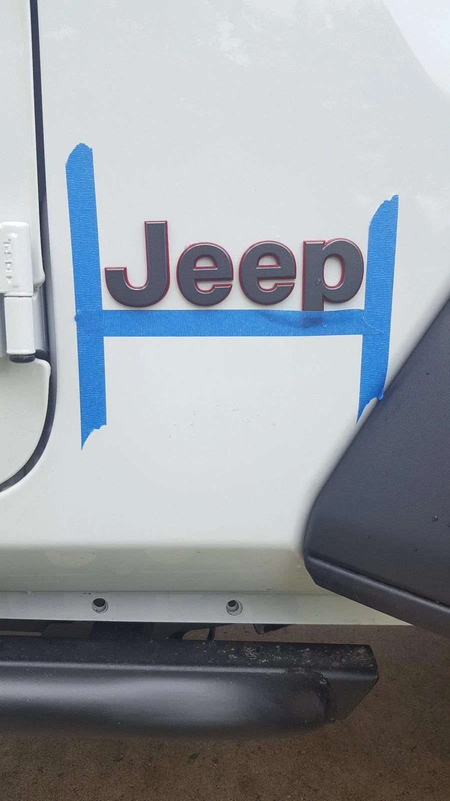

One thing you can do is use very narrow strips of painters tape to align the letters Put it to each side and above the letters. As an example, when I pulled my Wrangler Unlimited sticker, I used tape to mark the edges first. That way when I put the new one in its place, it would line up the same. You could definitely put strips of tape in between the letters before removing them so you maintain the alignment when you replace them.

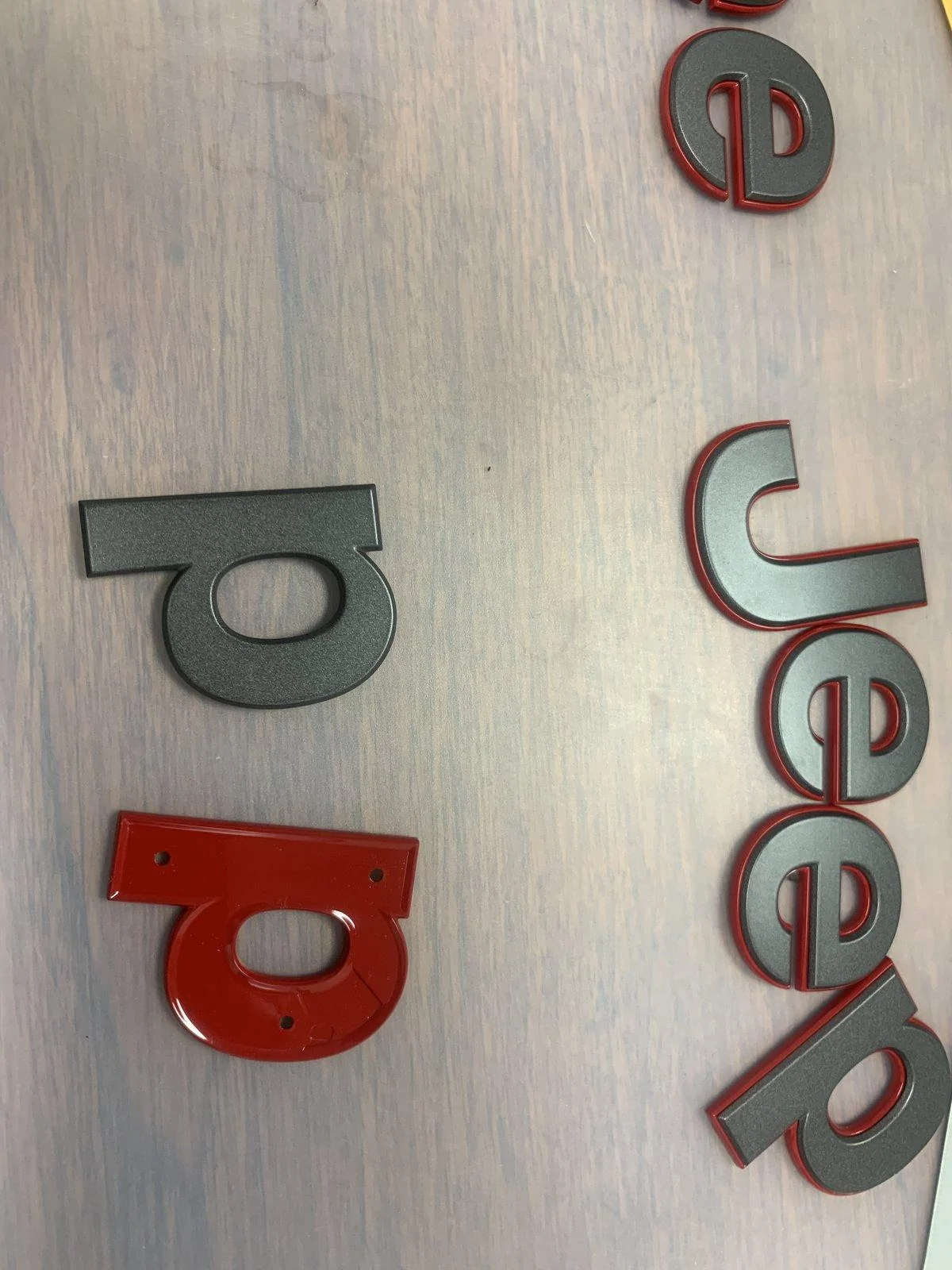

So I decided to remove the Jeep emblem and the Wrangler sticker. The sticker came off pretty easy and in one piece.
The Jeep emblem was a bit tougher. I got the letters off, but it left behind most of the adhesive and rubberized material. I have used Goo Gone to help soften the rest, but I still have a bunch of residue. It looks like a bit of time and elbow grease will be necessary to get the rest off.
On the passenger side I may try a light touch on a heat gun. I read of folks who said their letter came off easily, I'd love to know how they did that.

I have found the solution to the decal and badge removal process!!
Goo Gone, an old credit card, and lots of swearing and elbow grease.
Have no fears, I have a new trail rated badge that I will installing later. I'm just swapping out the red colors.
Even the Rubi decals on the hood will be replaced shortly.

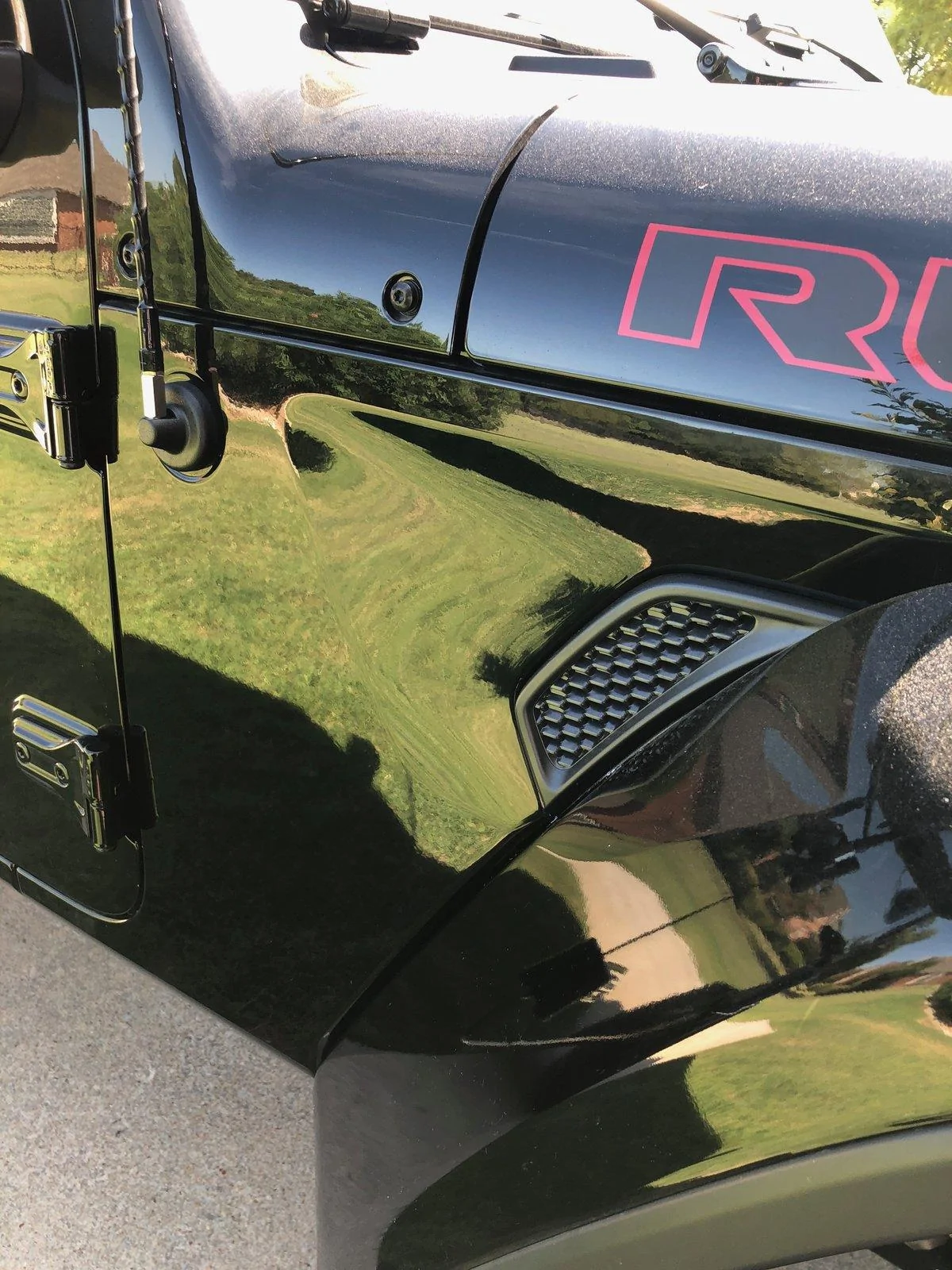

Pulled my logos and stickers on the new 2020 last night. Figured out how to disassemble them without breaking. Going to redo them in colors of my choosing and put the Jeep badges and trail rated badge back. The red accents just aren’t my thing. Used 3M adhesive remover as it is safe for clear coat. Would like to redo the rubi stickers exactly the way they were, but with custom colors. Thinking pixel decals for that one.
