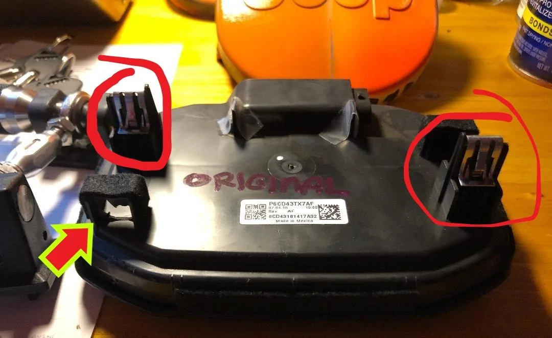

I have been trying to pop the dome light down in my 2021 JLUR with a trim removal tool (plastic) and it doesn’t seem to want to budge. I do not want to break anything up there. Am I missing something?
I am prying between the outside of the housing and the plastic soundbar trim.

You got 2 clips in there ...you should be able to gently get a screwdriver in there to press on them. Don't He-Man it out or you'll break the plastic thingies opposite the clips.
