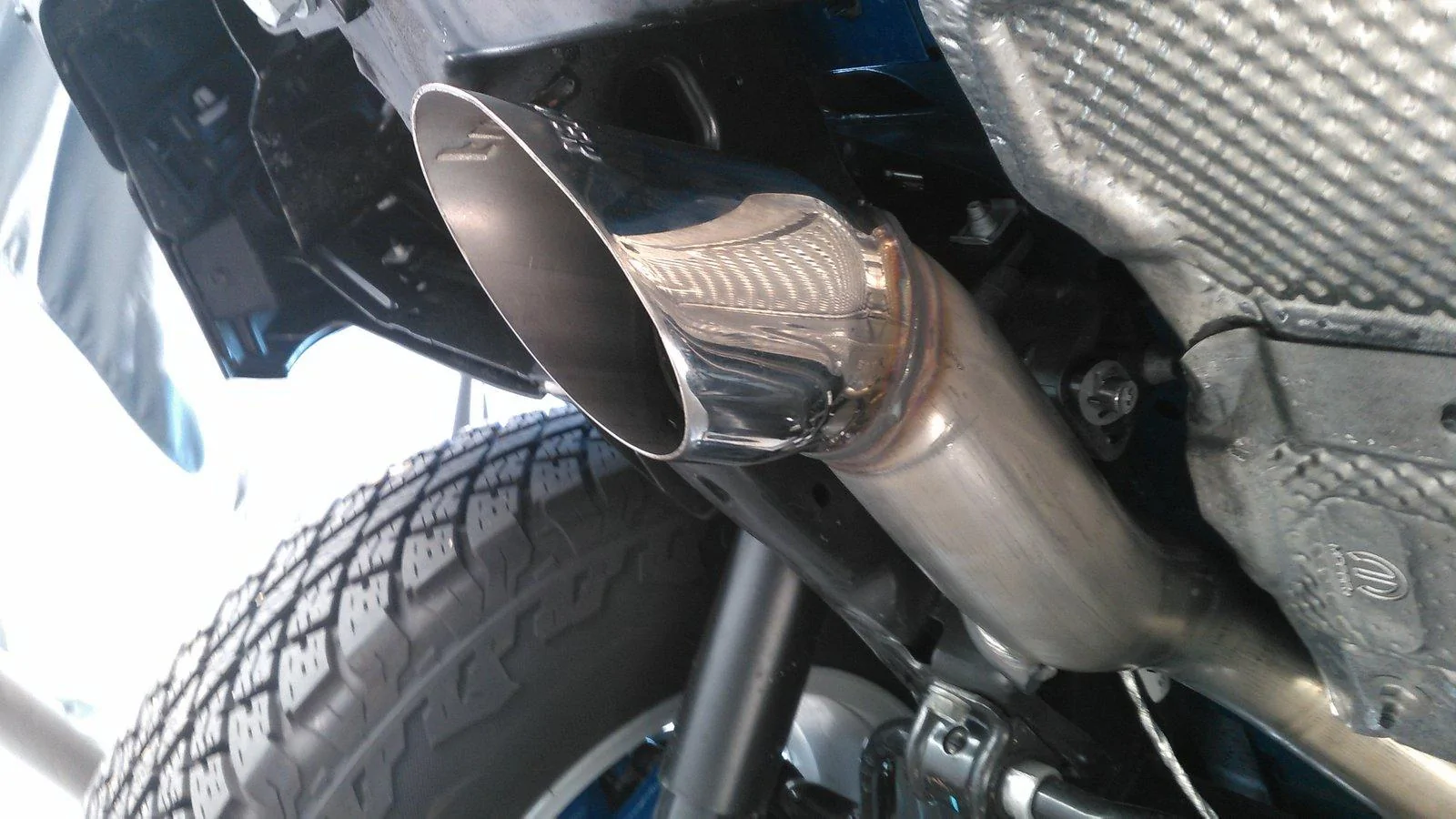

Installed it Saturday. I needed a exhaust expander to get it on. Here it is:
Jeep Wrangler JL Removed Stock Muffler KIMG1104

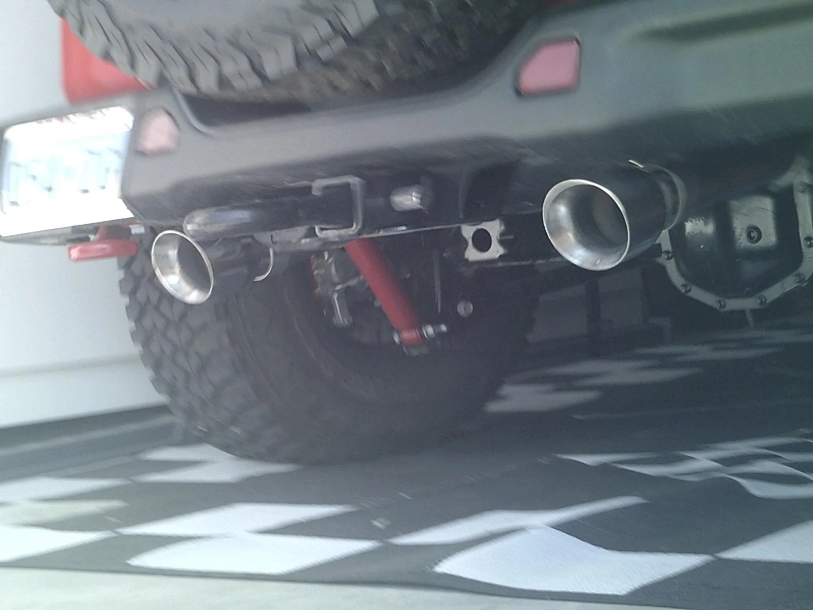

Using the DYNOMAX TURBO--there's no relocation of anything, but
W.E.
JIMBO
It's a mild sound/w no DRONE
Jeep Wrangler JL Removed Stock Muffler SUNP0175

Just installed the Dynomax! About 45 min. I love it! Looks great and the sound is just enough!
