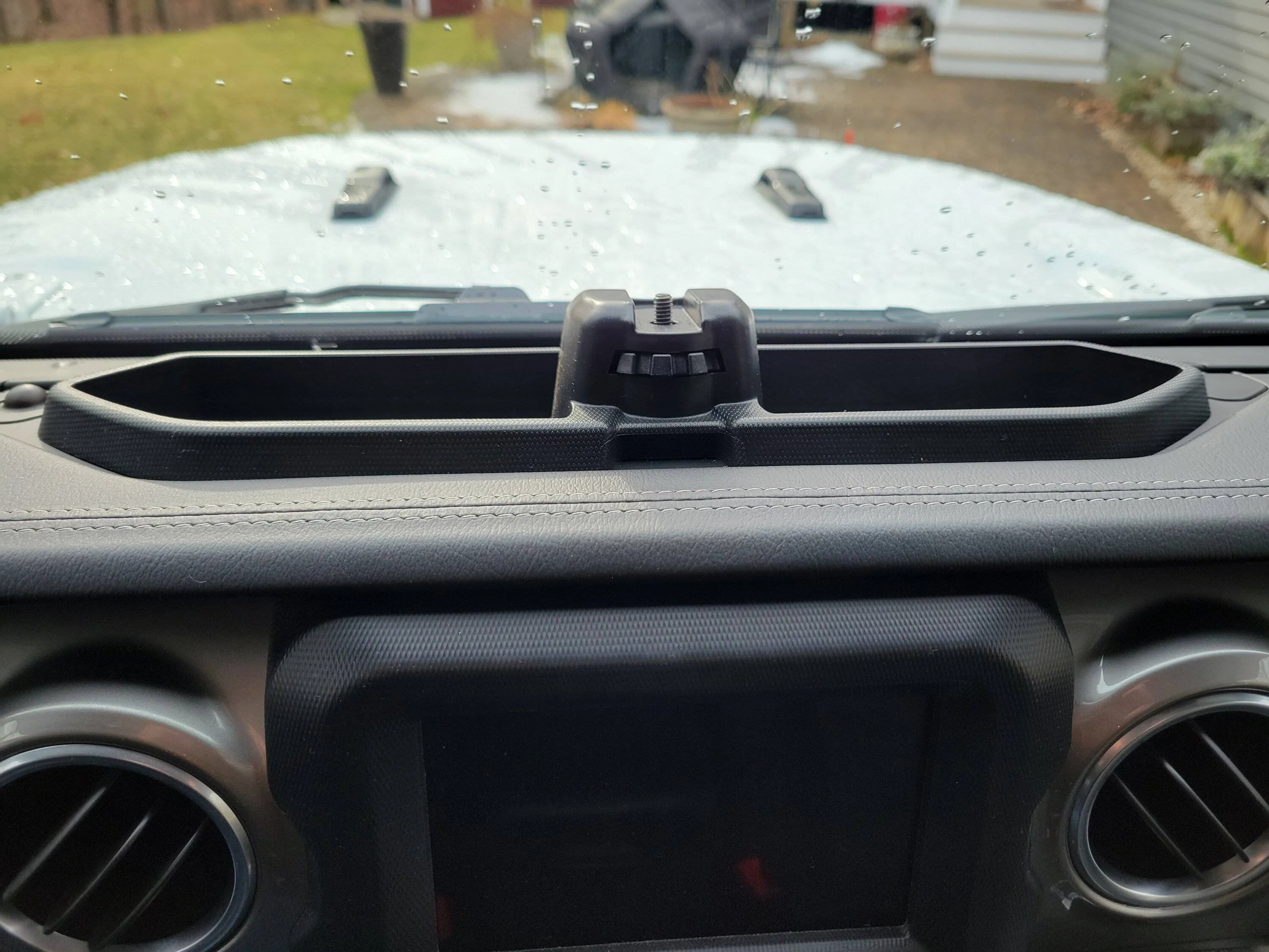

I just bought a CPO Sahara Unlimited. I have determined that the previous owner replaced the bin on the center of the dash with the Rugged Ridge phone mount, but the phone bracket is not with the vehicle.
I tried to add a 1/4-20 Ram ball and ram phone mount, but the ball won't tighten down enough (plastic thumb-wheel and integrated bolt slip) and the ram ball doesn't hold the phone steady at all.
The vehicle has wired Car Play and Android Auto, so there is really no reason to have the phone mounted on top of the dash.
Does anyone know the proper part numbers to restore the original bin and rubber mat?

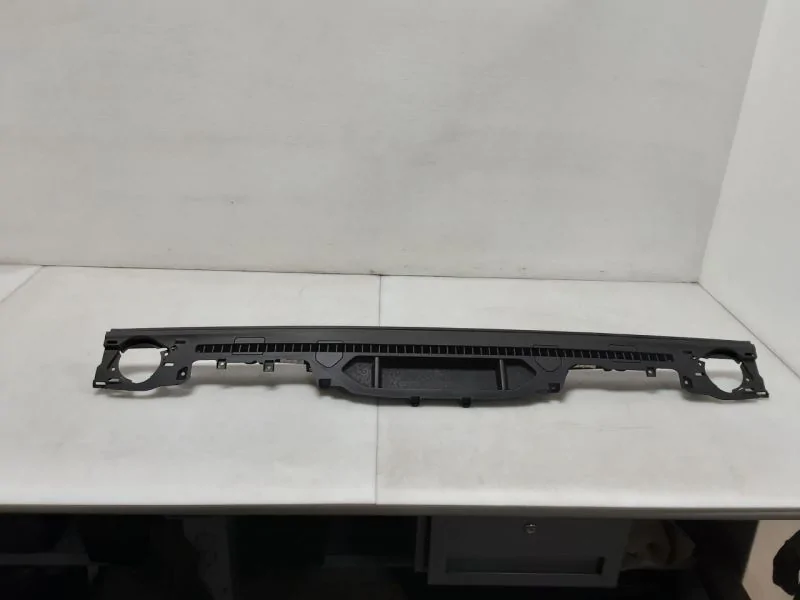

@DaveP12
6KN87TX7AD ... is factory part # , I believe..
OEM Front Dash Defroster Vent Trim Panel 2018 2019 2020
You can find and buy used on eBAY or at a local salvage yard.

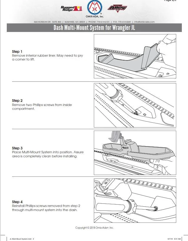

That does have the center bin, but seems that it should be a much easier piece to replace. The instructions just show two screws holding the piece in and are exposed from the top of the bin.

The "bin" doesn't come out. You should be able to remove the 2 screws and pull the RR piece out. It may have some double sided tape holding it in as well. Then you just need the rubber mat part.

Thanks for the responses. I have removed the Rugged Ridge tray and will get a replacement mat for the OEM bin.
