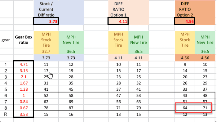

Are the numbers in red on my image the MPH where the gearbox will shift into 8th gear?
Thank you very much for this information! That is amazing!!!
I am heading over to read the thread now.
-DD

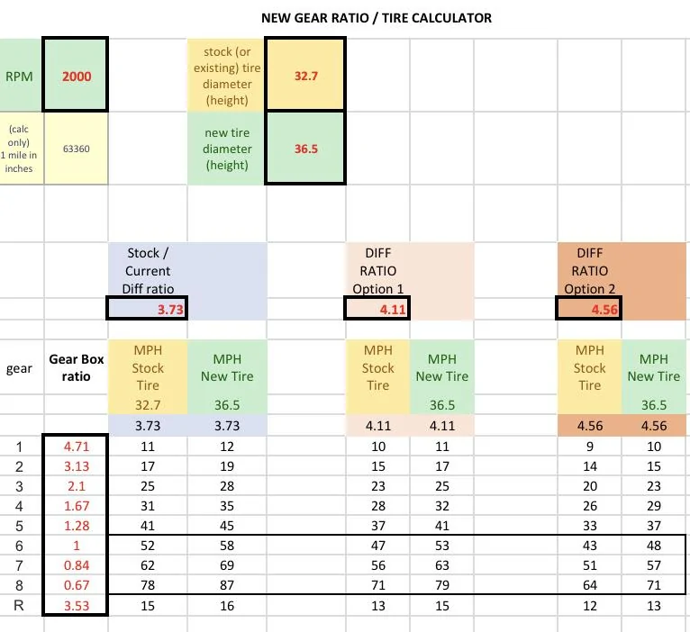

No it has nothing to with shifting. It’s the MPH at 2000 RPM. In the red circle you made you would only me looking at the MPH in GREEN column on the right.
This is what your MPH would be with 37” tires and going 2,000 RPM in 8th gear - 71 MPH - This is extremely close to stock and actually puts you ever so slightly better into the powerband of the diesel. So you’ll theoretically get better MPG and have more power on tap VS stock.

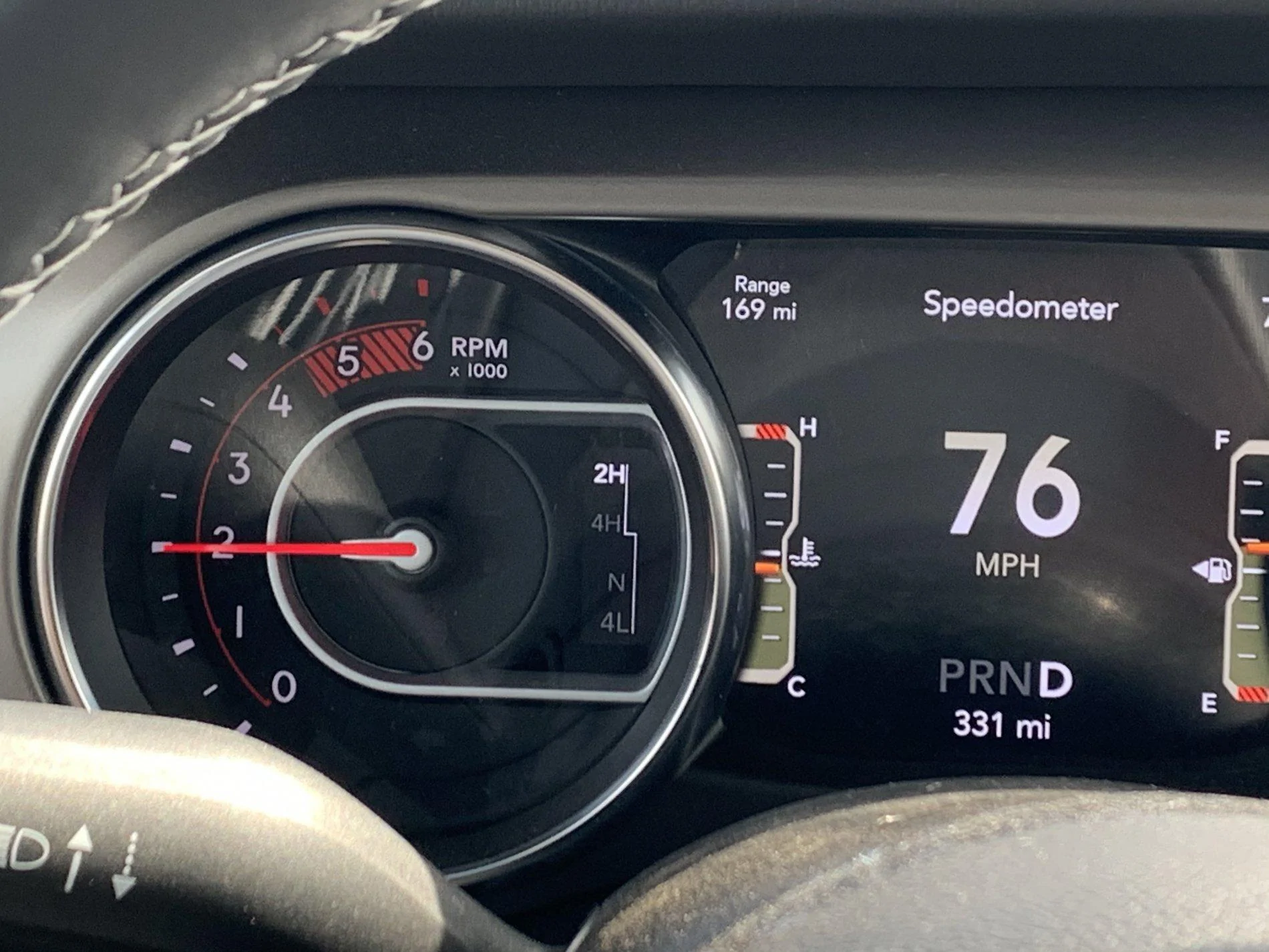

In the pic I posted of my gauge cluster I’m bone stock going 76 MPH @ 2,000 RPM in 8th gear.
