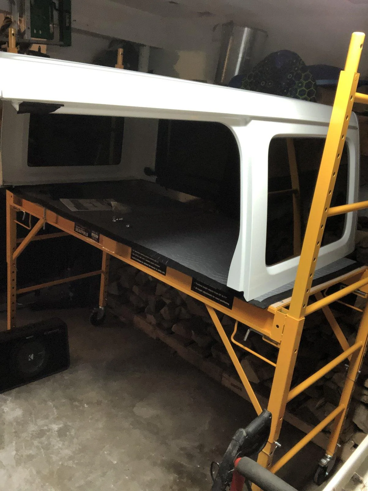

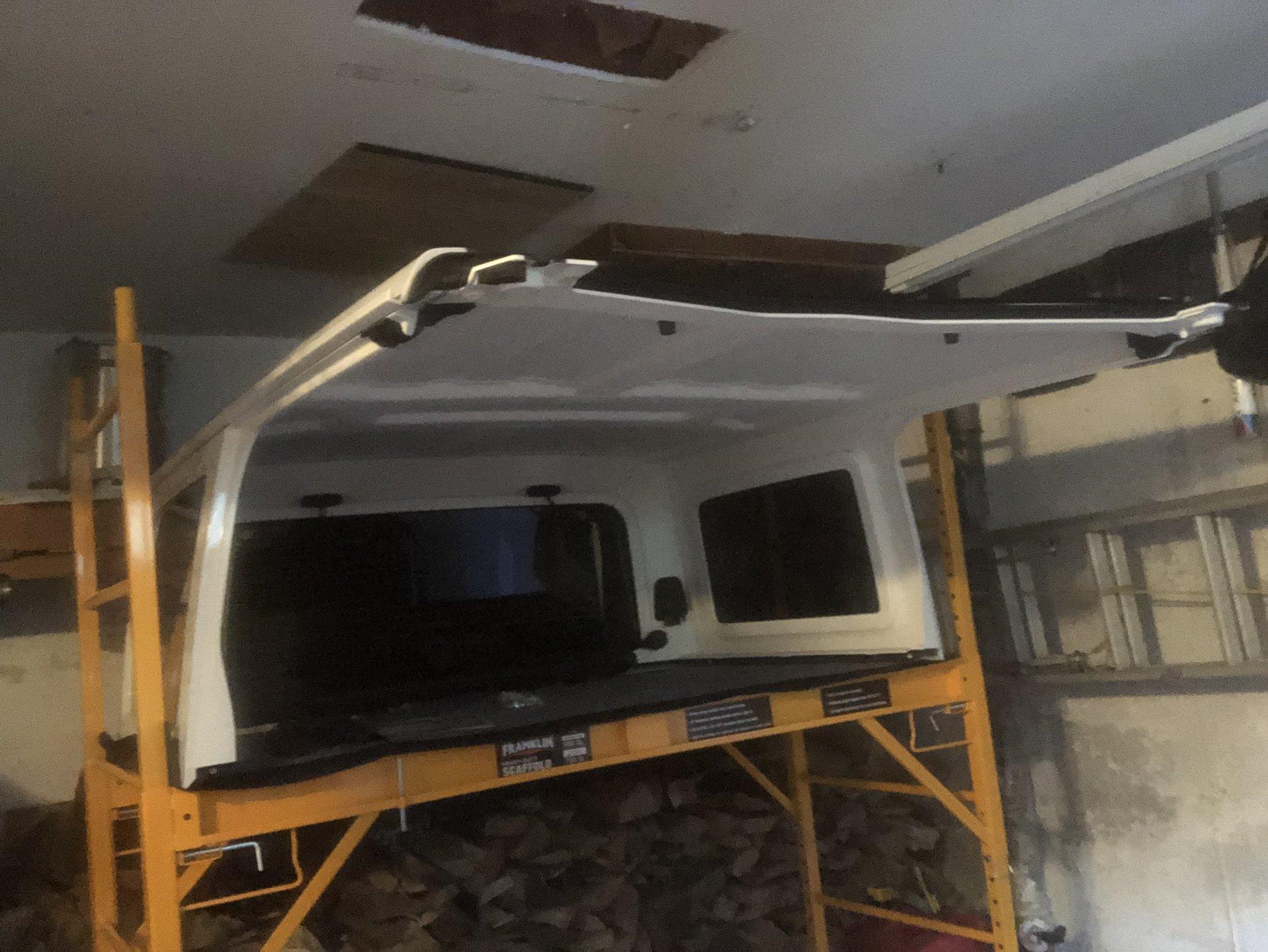

First off congrats on your new Jeep! Spring will be here sooner than later and I’m itching to swap tops myself. Personally, I think the Scaffold works very well removing and storing hardtop. We can park my wife’s car under it with our tight single car garage. Removing top is a snap. Just move the scaffold right to the rear bumper with the hardtop window open, lift with a 2nd person, and slide back onto Scaffold about a foot. I use a movers blanket to protect the bottom but that is optional. Harbor Freight has a nice unit for about $160 with a coupon.
