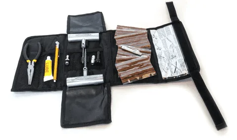

tire repair kit, added some Colby emergency valve stems

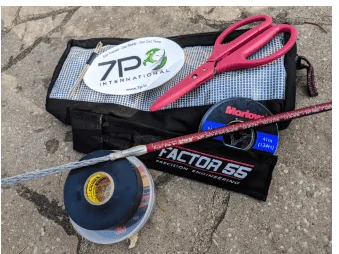

Synthetic line repair kit:
Jeep Wrangler JL Recovery gear for newbies 1660346704310

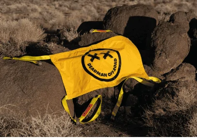

Deadman, replaces tree saver and can save me if stuck with no anchor point:
Jeep Wrangler JL Recovery gear for newbies 1660346786550

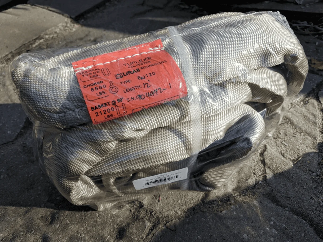

I also bought a 12' 'endless sling' but it was not worth the space/weight, at least for what I do
Jeep Wrangler JL Recovery gear for newbies 1660347756117
