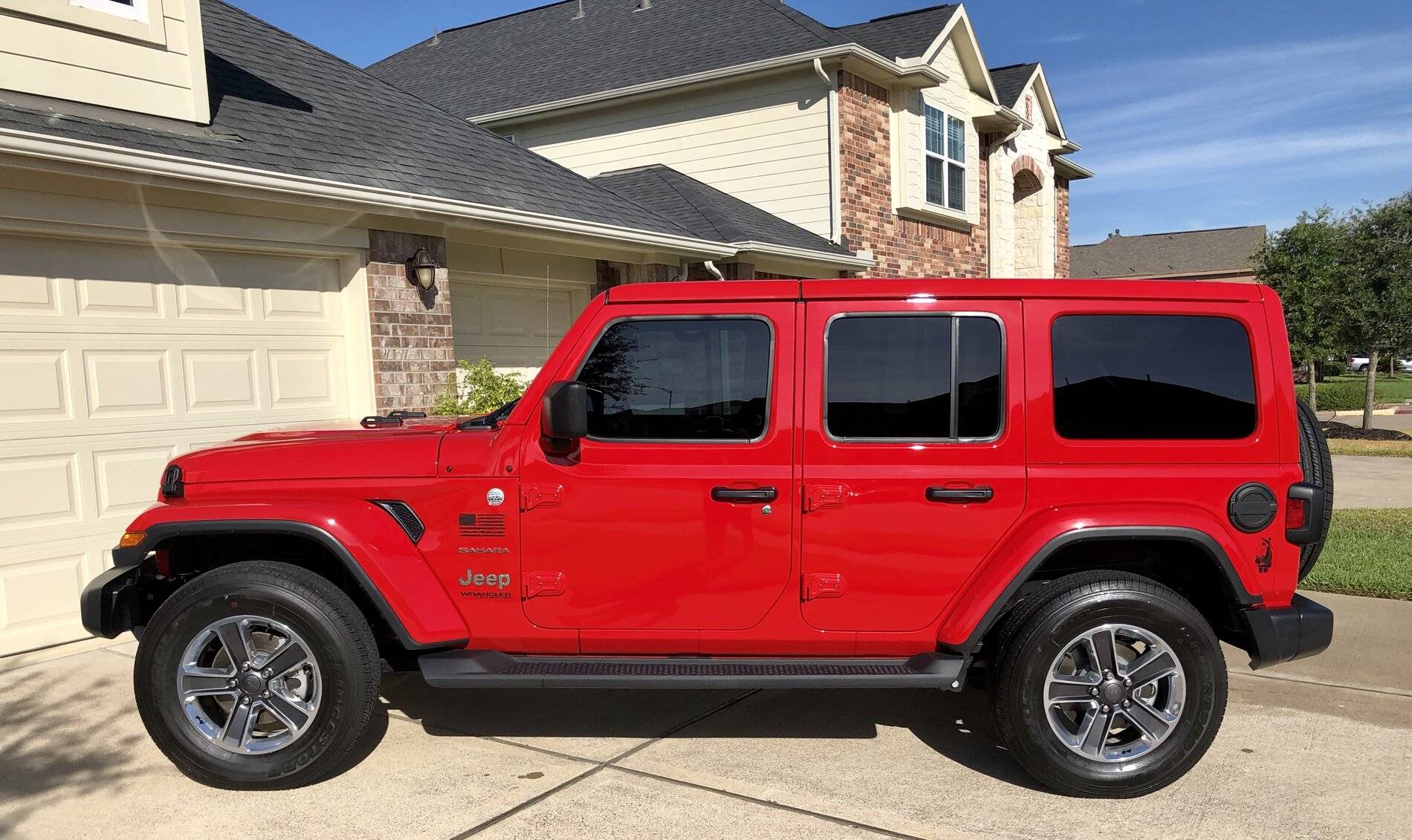

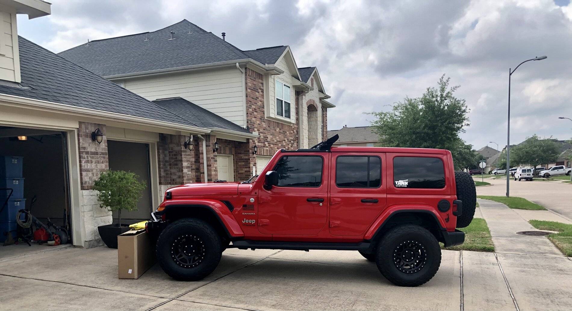

I went to him shortly after I got my 2018 JL and wanted a lift and bigger tires but instead of selling me what he could to make more $$ he sat me down and ask me what I was going to be doing with my Jeep and like you 80-90% of the time it’s my daily driver back and fourth to work and occasionally get on some back roads and in the sand at the beach and he told me to save my $$ and just do a boost and he installed an RC 2.5” boost and then put some BFG KO2 35’s with some Method wheels and couldn’t be happier.
I‘ve had it installed almost 3 years and have zero issues, I rotate every 5k miles on tires and DT said my tires are wearing perfect with total even wear and I will likely get close to if not slightly over 50k miles out of them.
You have to decide what you want to do with your Jeep and go from there and for me since I don’t rock crawl or do any hard core offroad stuff my budget friendly RC boost has worked out and having such an honest shop owner like Chris from Tank Customs really helped
Before any mods
After several mods and this is 3 years old

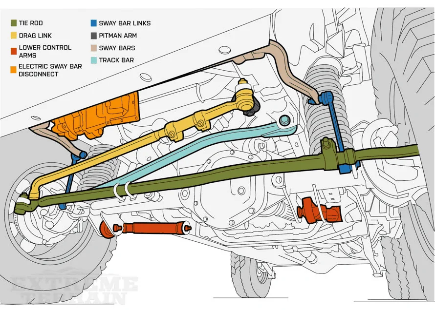

UCA Upper Control Arm
LCA Lower Control Arm
I found this diagram helpful:
