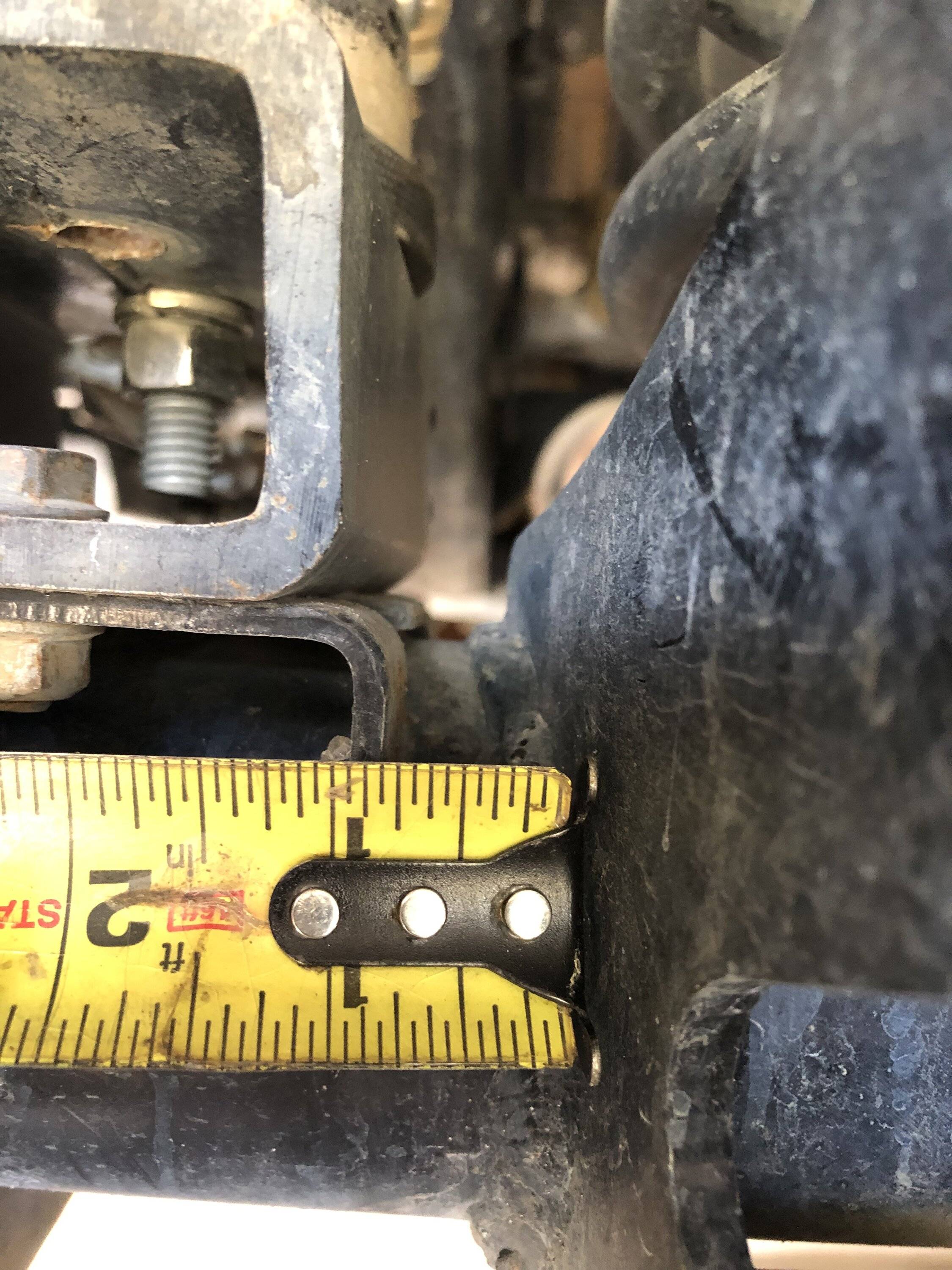

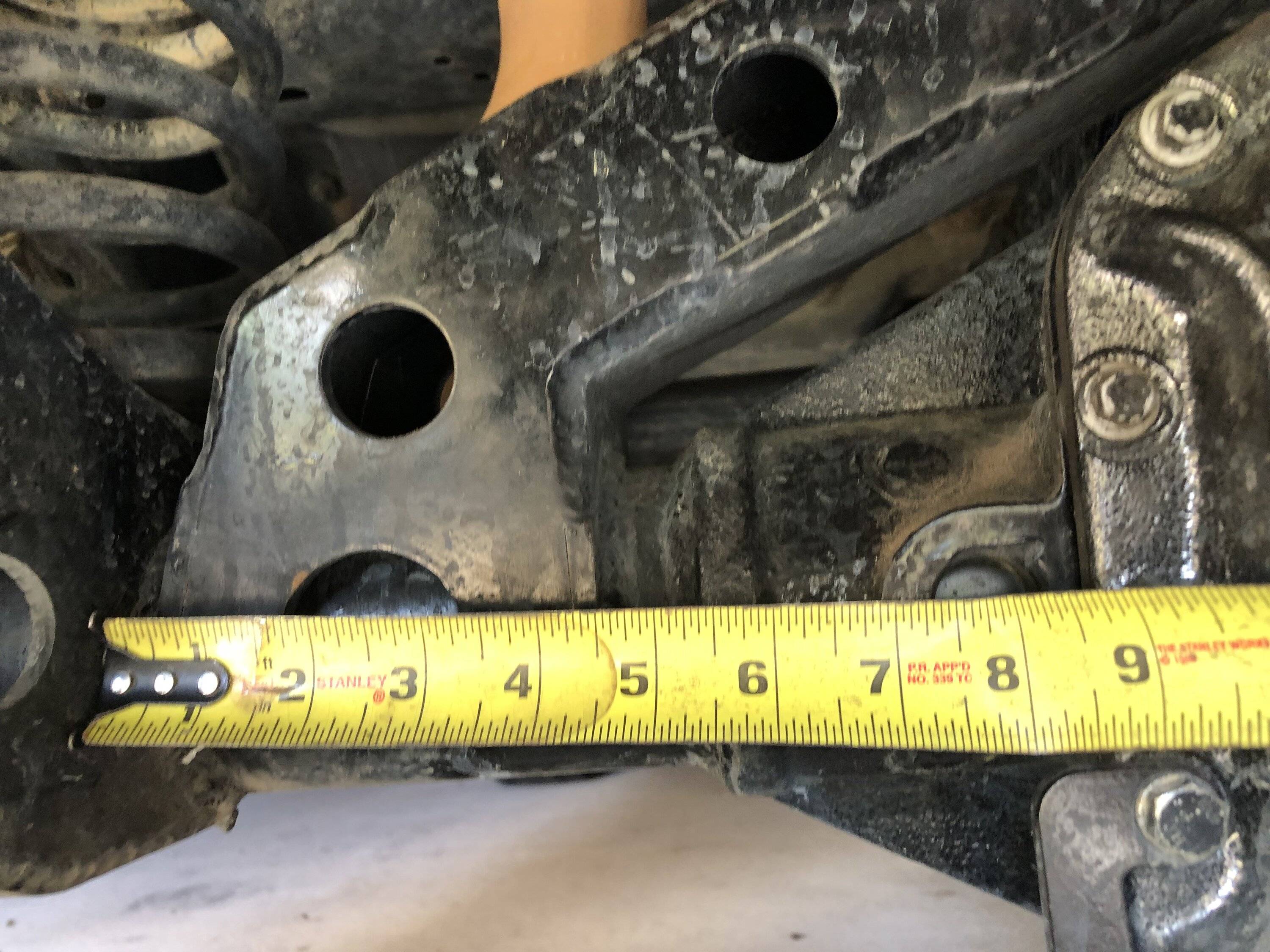

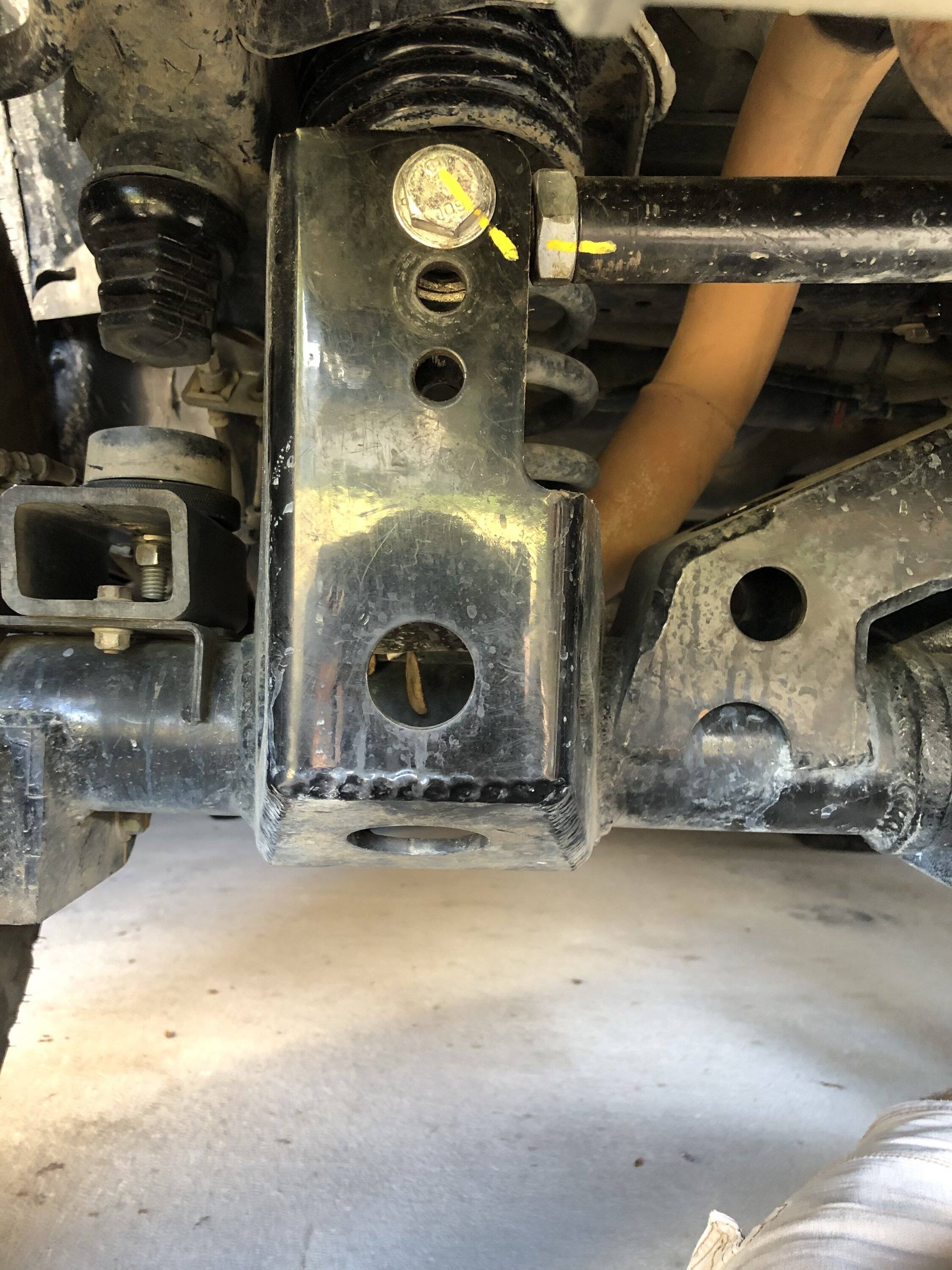

While installing a Rock Krawler long arm on my 392, I got a little ahead of myself and cut off the rear trac bar bracket without recording the placement of the mounting hole.
Could anyone with a rubicon (wide axle) take a quick measurement for me? I need the horizontal distance between something like the flange at the end of the axle where the ABS sensor mounts, to the trac bar mounting hole on the axle. Just need to know where to weld the new trac bar bracket on!

I’m running that kit, I can get you an exact measurement where to set it when I get home this afternoon……

It’s 3/4” from bump stop plate and 6-7/8” from the round edge of the flat on the diff…..with the adjustable bar, you don’t have to be perfect on this……if you have your truss on already it sits pretty close to it……

This was exactly what I needed, thank you!
now I just have to figure out the exhaust on the 392. The cats are right where the front control arm mounts need to be!
