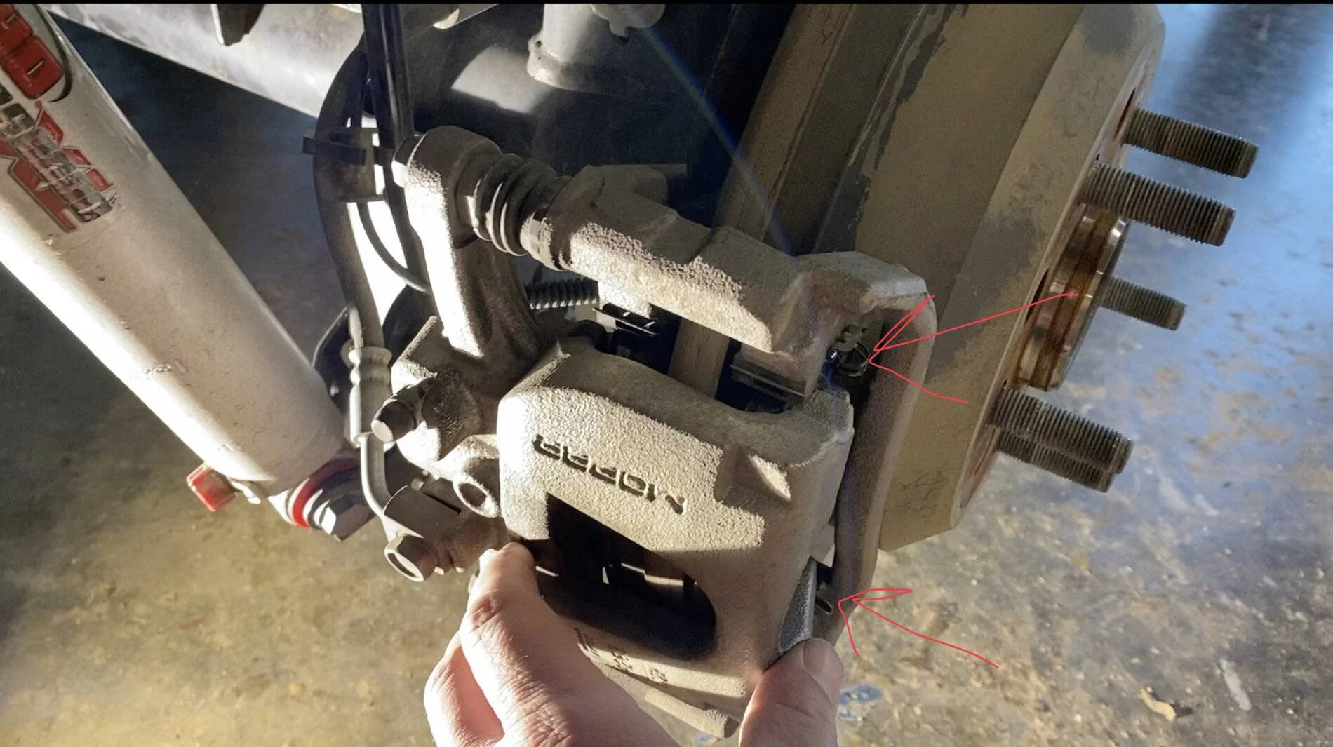

I had something like this too when mine was new. . Check your brake pad clips. They put them in with no grease, mine started squeaking especially when applying the brakes and over bumps. To test if this is the problem have someone apply break pressure and rock the Jeep back and forth. It’s pretty easy to remove the brake pads and grease the clips if this is your problem. Check YouTube for instructions there are lots of videos showing how.

I had something like this too when mine was new. . Check your brake pad clips. They put them in with no grease, mine started squeezing especially when applying the brakes and over bumps. To test if this is the problem have someone apply break pressure and rock the Jeep back and forth. It’s pretty easy to remove the brake pads and grease the clips if this is your problem. Check YouTube for instructions there are lots of videos showing how.
Thank you, will check this!
Thanks, I would not have thought to check this.
