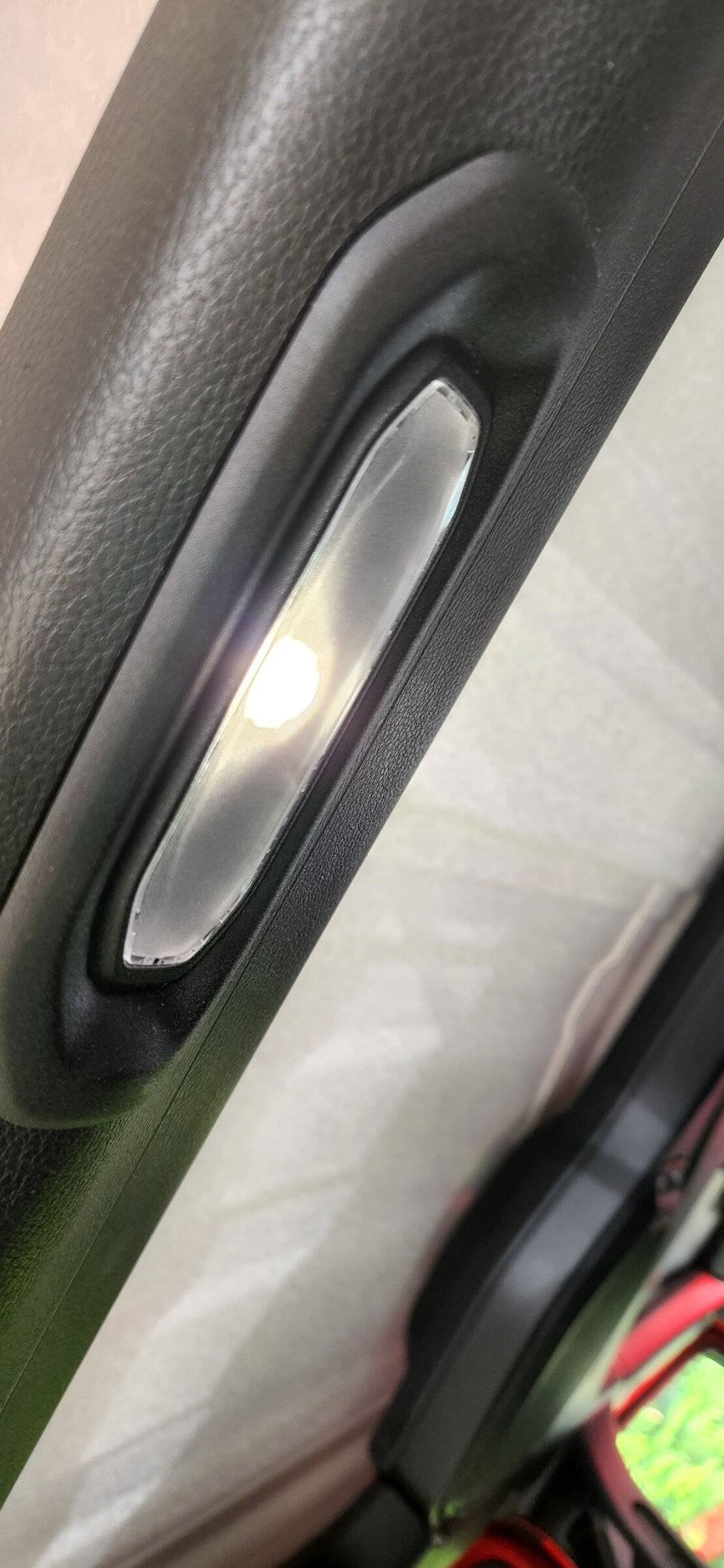

Rear cargo compartment overhead light issue found and fixed. A connector was not plugged in completly at the factory and had a bent pin. A scan of all the modules showed mic 3 and mic 4 not working which are also located in the rear roll bar with the cargo light.
The unplugged connector with the bent pin was located at the base of the passenger side rear roll bar by the seatbelt retractor just below the plastic tub surround. Hope this helps someone else.

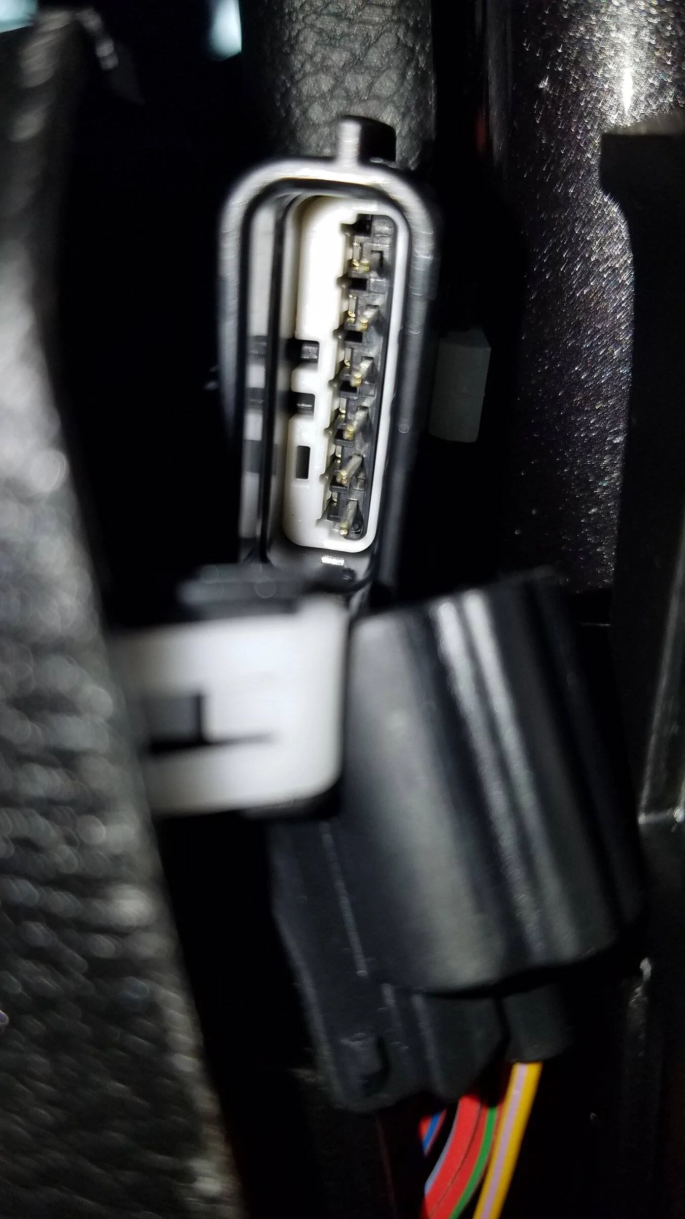

Oh wow. Thank you so much. Any pics of the bent pin?
4xe Rubicon
Jul 13, 2021
63
49
Ohio
2021 Jeep Wrangler 4xe Rubicon
?Second one up from the bottom. Just enough that it kept the connectors from seating fully.

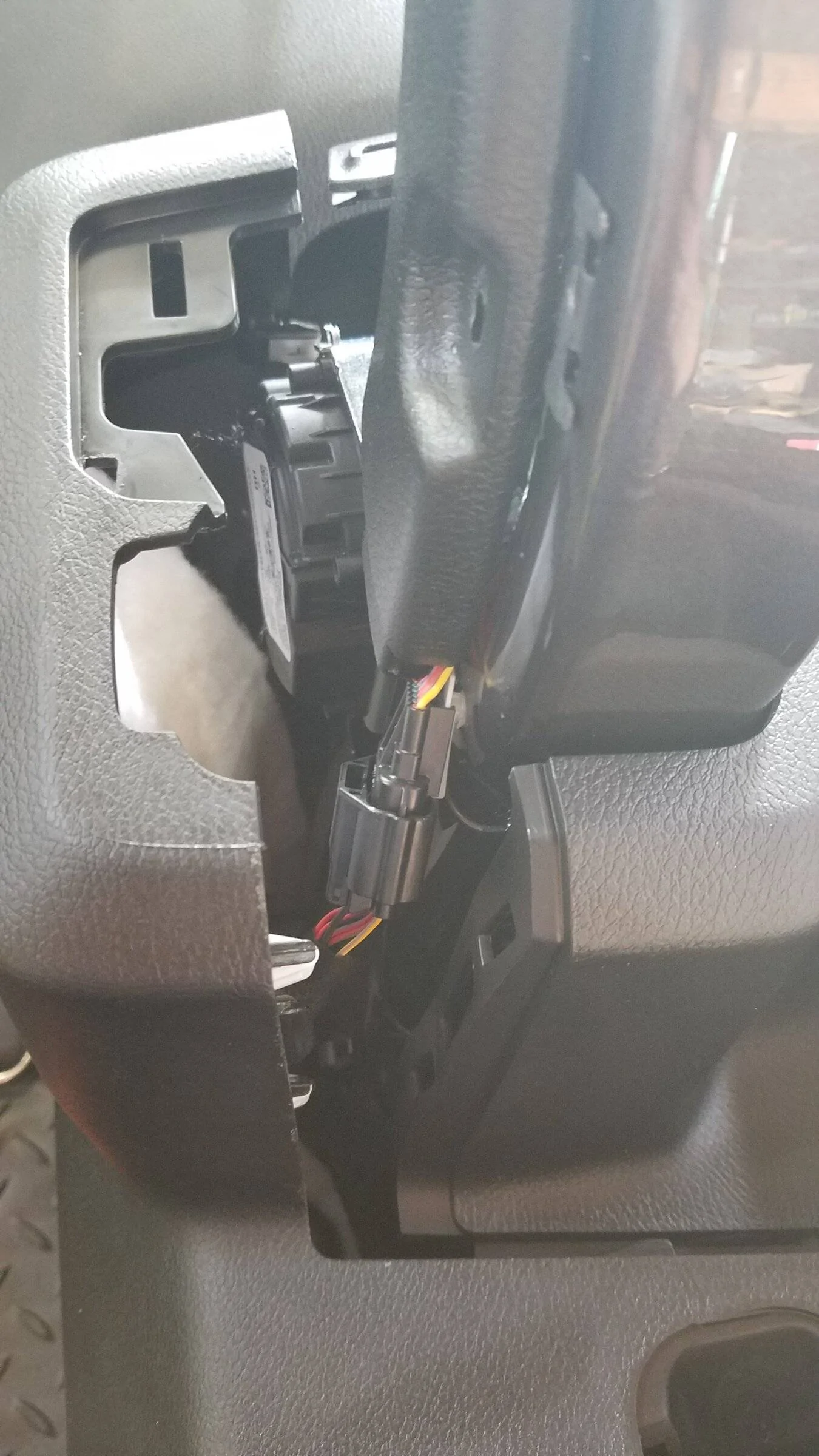

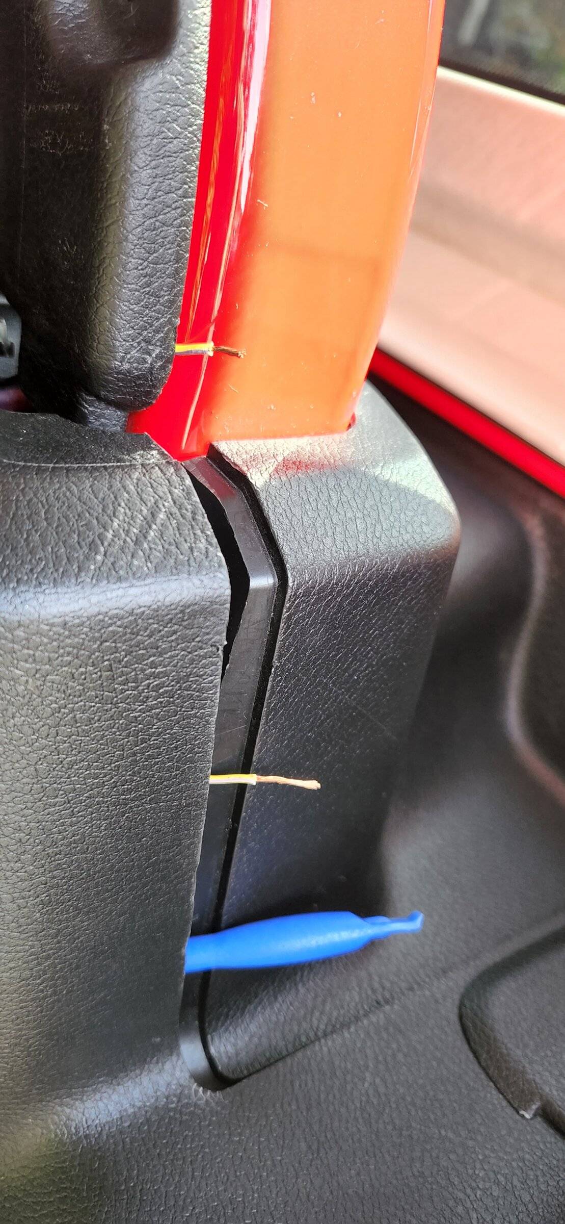

Any tutorials out there that show how to gain access to this?
Just use a non marring pry tool and start at the top. It will start 'popping' off. It's easier if you remove the little D ring plate on the cargo floor close by. You will run into it when you start prying the side panel off.
4xe Rubicon
Jul 13, 2021
63
49
Ohio
I pulled straight up on the small plate that the seatbelt runs through in order to unlock the two big plastic pieces from each other. Then pulled the two big halves apart right at the roll bar just enough to get access to the plug as seen in the photo. One of those white retainers popped off, so i did have to go fishing for it.
Dragonegg's suggestion of removing the floor tie downs first and pulling the the big half that houses the subwoofer might be a better route. There is one screw that I recall just inside the passenger door opening below the rail that might need to be removed also if you are going to pull the whole thing apart.
Not home with the Jeep at the moment otherwise I'd send some more pics. Good luck.
