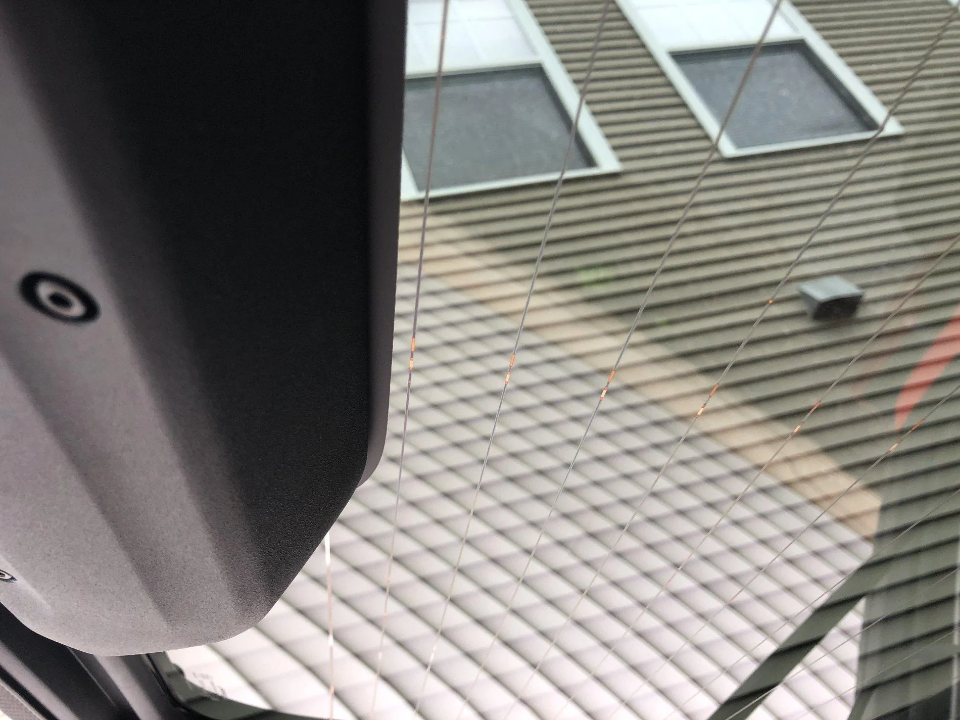

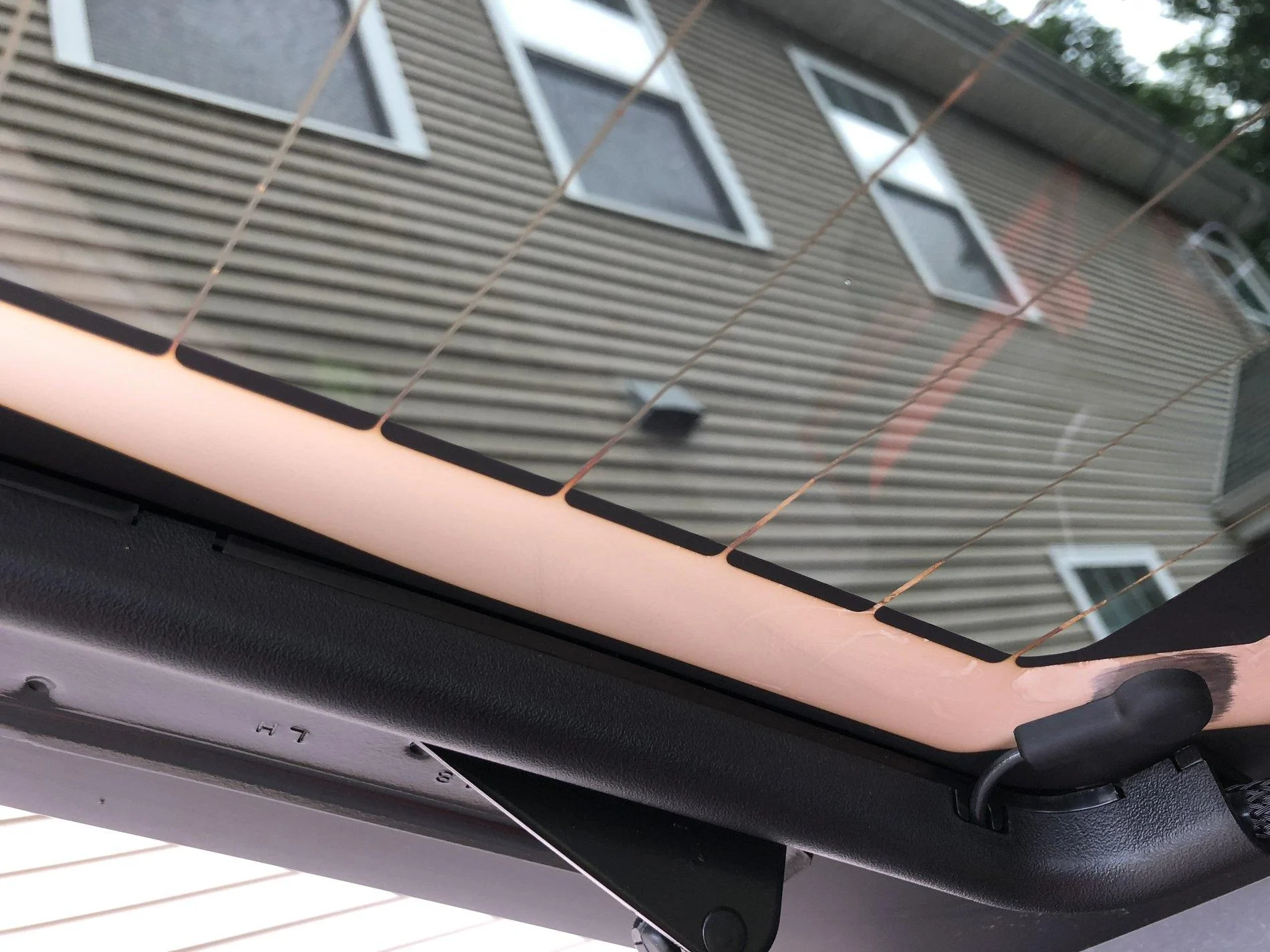

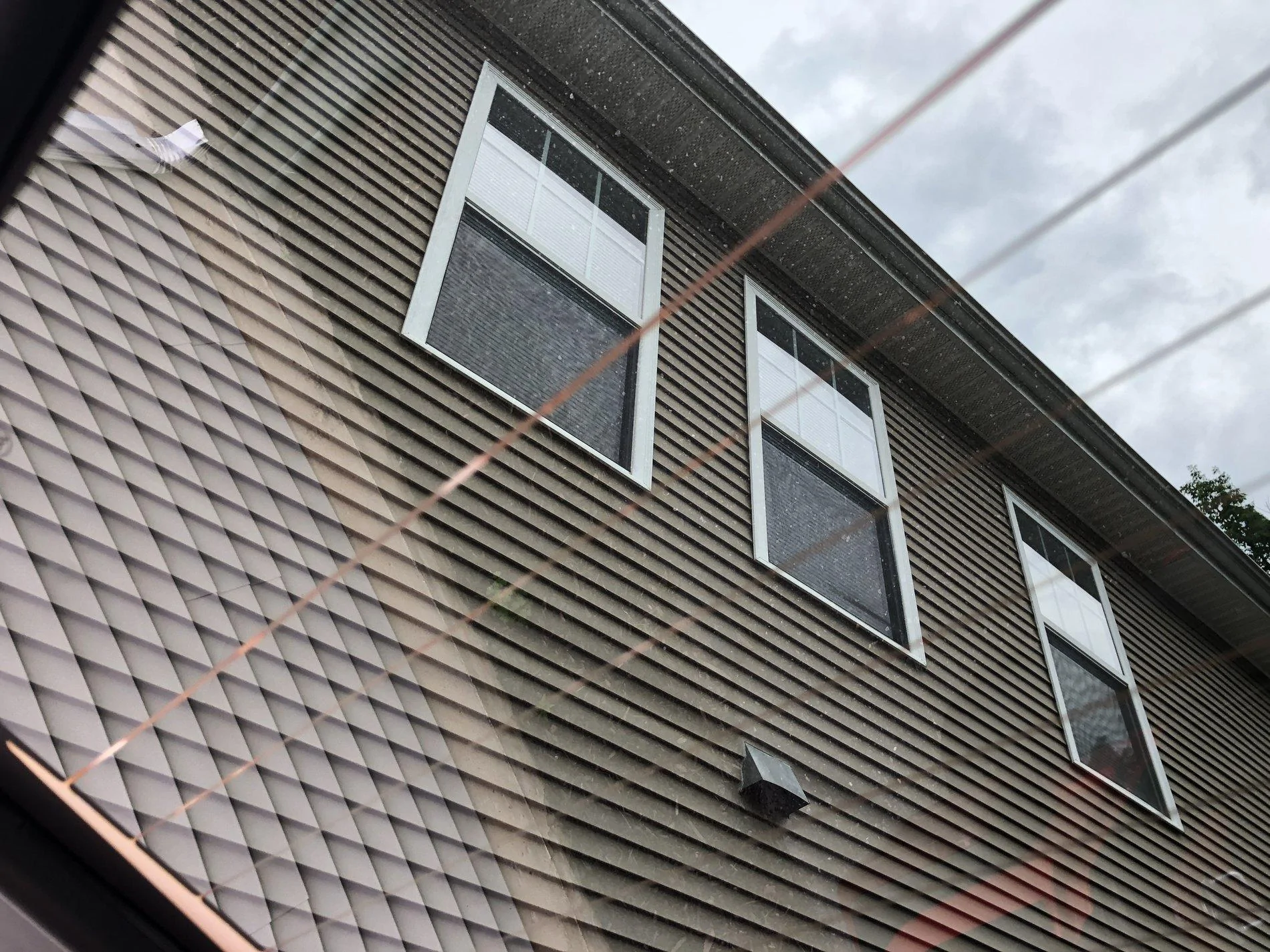

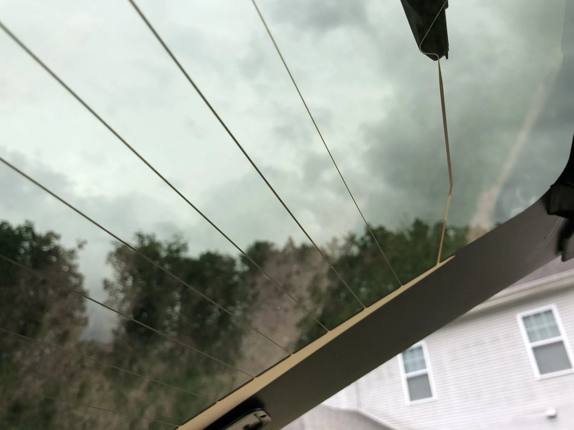

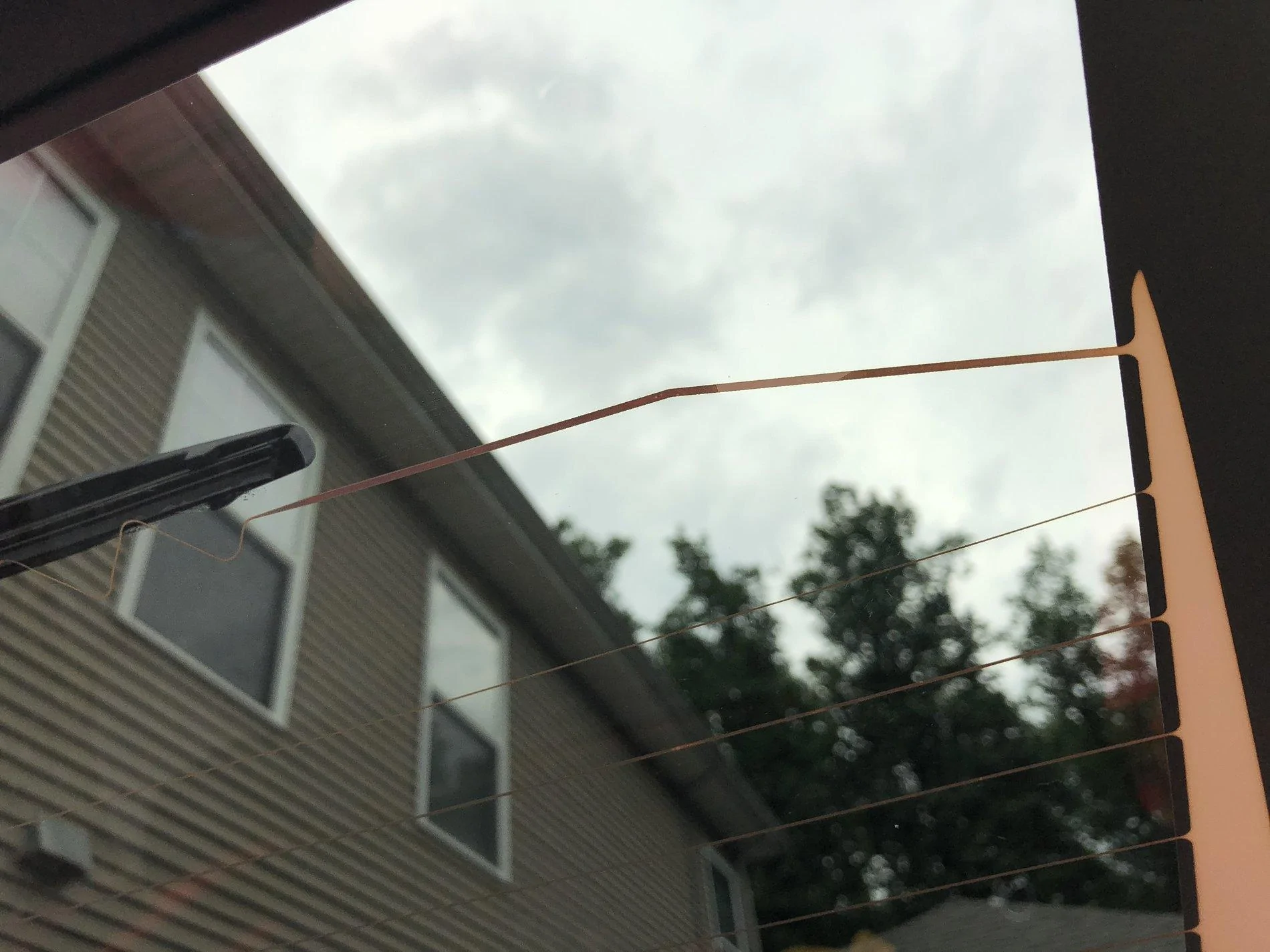

ok, not sure if this has been covered or is the cause with so many rear defrost systems not working but as I was cleaning up my Jeep I noticed the rear window where the defrost system is applied to the glass...well it’s rusting.
Winter is over, so I don’t have a way of checking to see if mine works or not. Just checking to see if others are seeing the same issues. Pics posted.

Oh yeah...I don’t have any leaks on the back window and only cleaned it once after washing the Jeep. You can’t tell from the outside there’s an issue, but once you start inspecting each individual line you can see it go from normal to rusting to normal, etc. funny thing is where they sanded away the coating to connect the power on both sides...those areas are not rusting and it’s bare metal.

Not sure. If it continues to rust and then shorts the system I would say it’s an issue. If it’s just cosmetic then I don’t care. Just wondering what long term issues may arise and if any hoping the warranty covers it.

True. If I rub it with my finger I can remove the rust/color and it’s back to normal. Not sure if it will last though.

Well it looks like it’s supposed to be all white or silver but then there are these areas where it looks like rust. When I rub those rust areas it comes off and looks white again.
