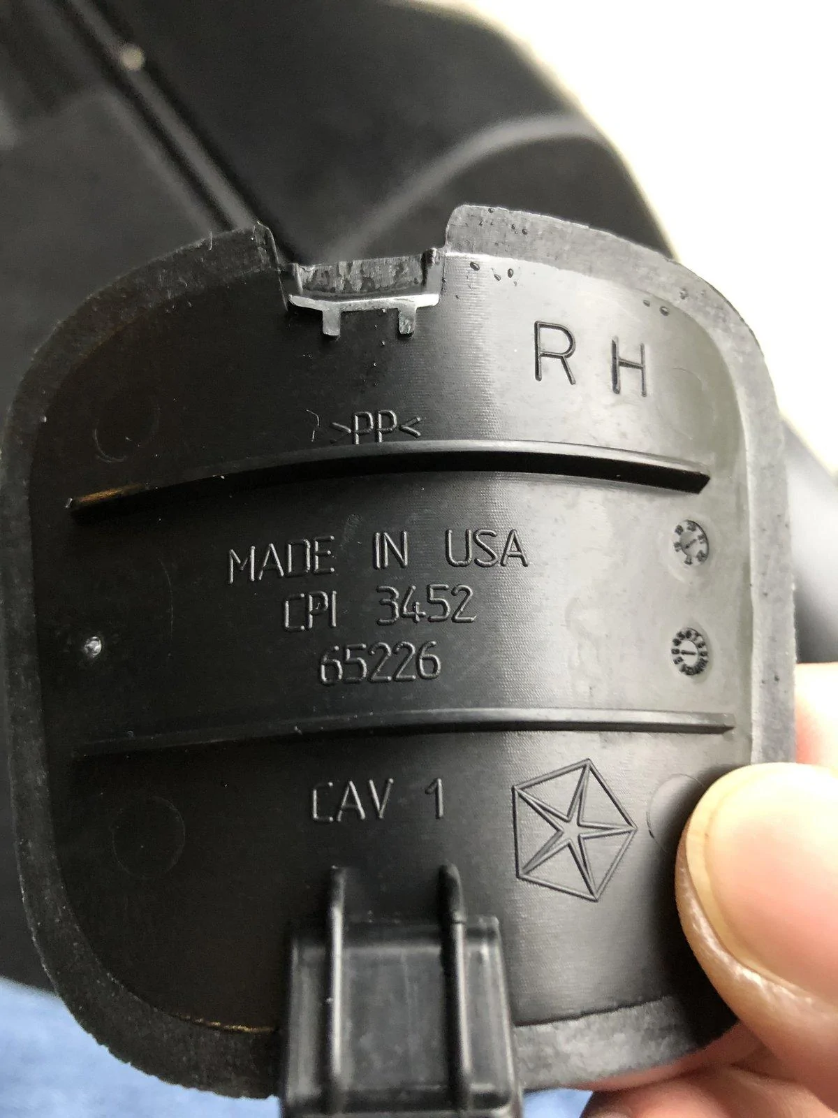

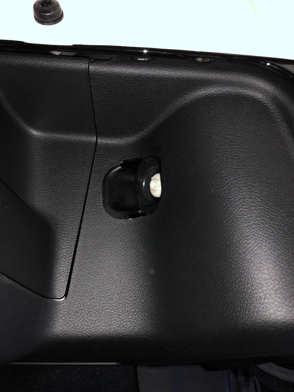

This small trim piece popped off. Looks like tab broke. I’m just going to velcro it back but was curious to what was under it. (I.e. the little white nob)
I have a 2018 JLU Sport if that makes a difference.

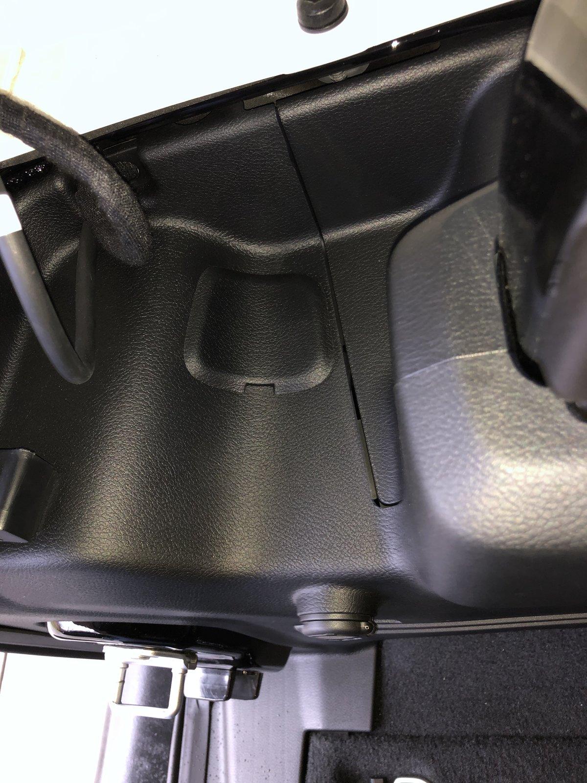

Driver Side one is ok:
Passenger side popped off:
The part in question and what does it cover?
Rhinebeck01
May 9, 2018
7,437
9,406
2018 2dr. Rubi
snipe:
@suzookus
The Left cover is, part # 6QJ14TX7AA and the Right cover, is part #, 6QJ13TX7AA dealer will sell to you for about $2.50+- each. Same covers fit either a 2018 or 2019.. any model JL/JLU.
That while plastic bolt you see under the each cover, is the bolt you remove in order to release the tail lamp.
CAREFUL, when working with that white plastic bolt, because if you over tighten it, it will break.

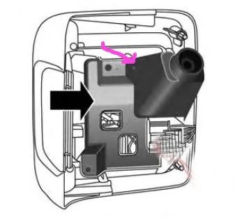

From forum posts, the nitwits stealing the JL tail lamps are prying on the tail lamp from the outside...
When they pry it tweaks the tail lamp a bit and the actual inner plastic section of the tail lamp breaks off and the tail lamp is let loose..
The white bolt/screw does not break and is actually left in place doing it's job.
So, titanium screw/bolt even would not prevent theft of the tail lamp if some nitwit wants it.
Part pointed to with pink arrow breaks off and then lamp is freed:.

I think it is the big black plastic "cone" on the back of the tail light assembly that reaches up to the white bolt that is the point of failure - it just breaks near the white bolt when enough force is applied.
Rhinebeck01
May 9, 2018
7,437
9,406
2018 2dr. Rubi
Correct..
You can see the cone in the pic I posted. Pink arrow points to the cone affair that the white plastic bolt/screw screws into.
The cone itself, is what is broken free from the main tail lamp housing.
After tail lamp is broken free, the cone is left firmly attached to the JL still.... attached by the white plastic bolt/screw.
