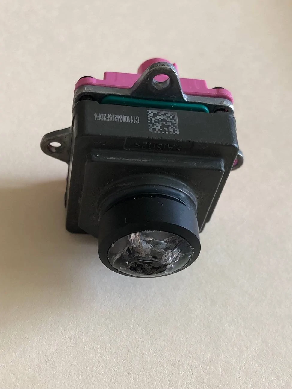

I have a 2024 Rubicon. Camera lens got hit. Bought a common knock off camera that appears identical to the original. Hooked it up and rear camera now shows blue screen.
only thing I can think of is maybe put too much strain on electric cable from tail gate, but I doubt that’s the problem
any thoughts or experiences installing a new Camera?

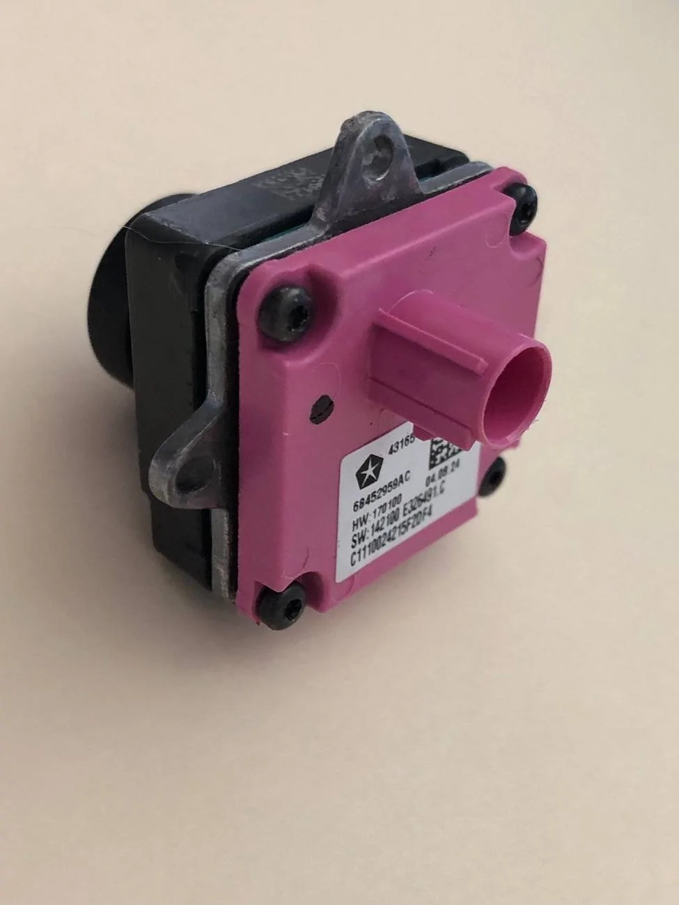

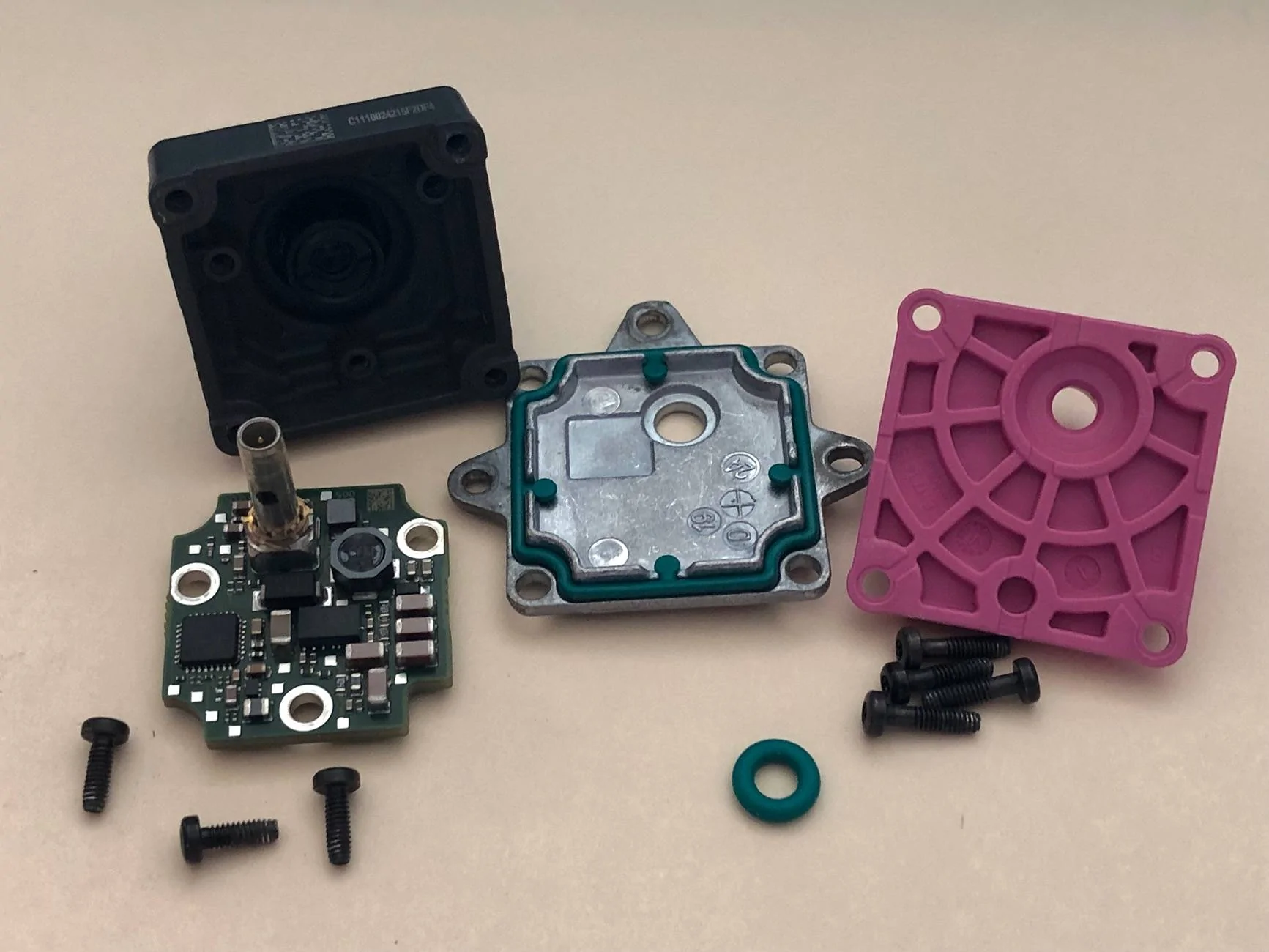

I took apart the original camera.
4 Torx#6 screws hold on back cover. 3 shorter ones hold inside cover.
I am almost 100% sure that the ones on eBay and Amazon are made by the same OEM in China. Pretty solidly built including the waterproof seals. They should sell just the outside black metal cover with attached lens cuz that’s all I need here.
If the camera doesn’t get magically activated in 48 hours by the camera Fairy I will put the lens cover from eBay camera onto these parts and try again

So did you end up just swapping the lens?
Guzziman
Guzziman
Bruce
Sep 21, 2023
Michigan
2005 Dakota 6 spd V8, Fiat Abarth. 2003 Boxster
Camera fixed.
the Replacement camera was never activated on its own. It is absolutely the same camera, but probably needs to have the chip activated by the dealership.
I switched out the lens and the camera was working right away.
