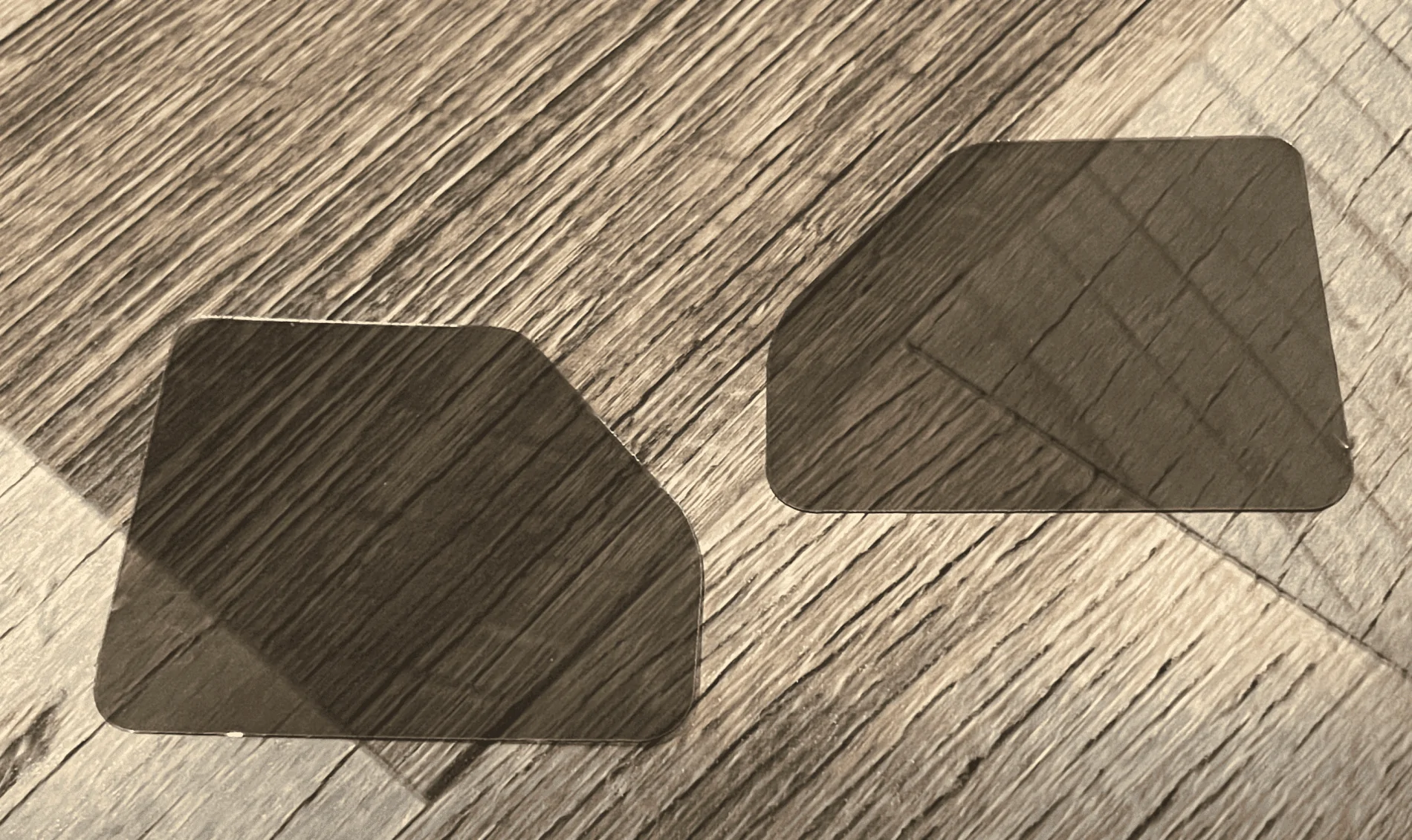

@tatarin I copied you and put the same tint film on, created a design on my plotter and cut them to shape to make the install easier
It every so slightly reduces the light output, but not noticeable in the backup camera and hardly noticeable if you really look when putting the tint on/off the light from the back of the Jeep
If anyone needs a set of pre-cut tint films shoot me a PM if you need a set cut! It definitely makes the lights more stealth and removes any of the yellowish look the LEDs they have to them when off/in the daytime.
