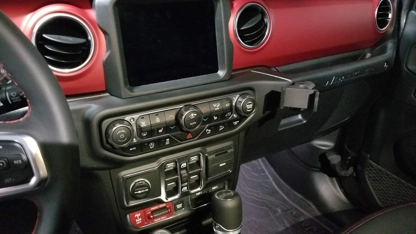

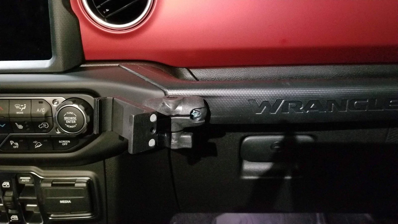

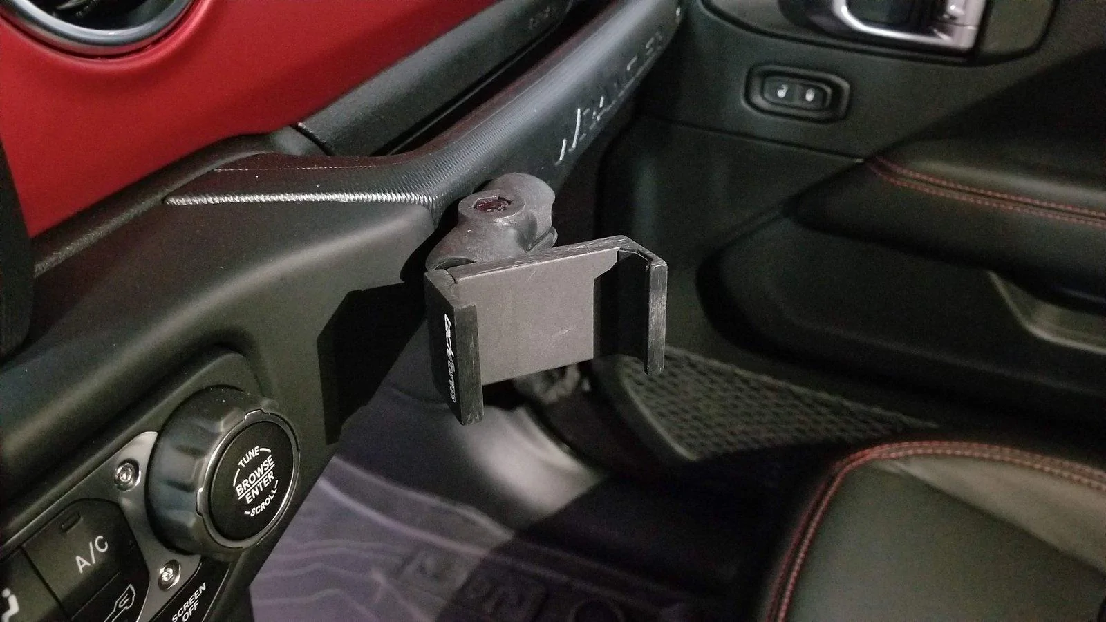

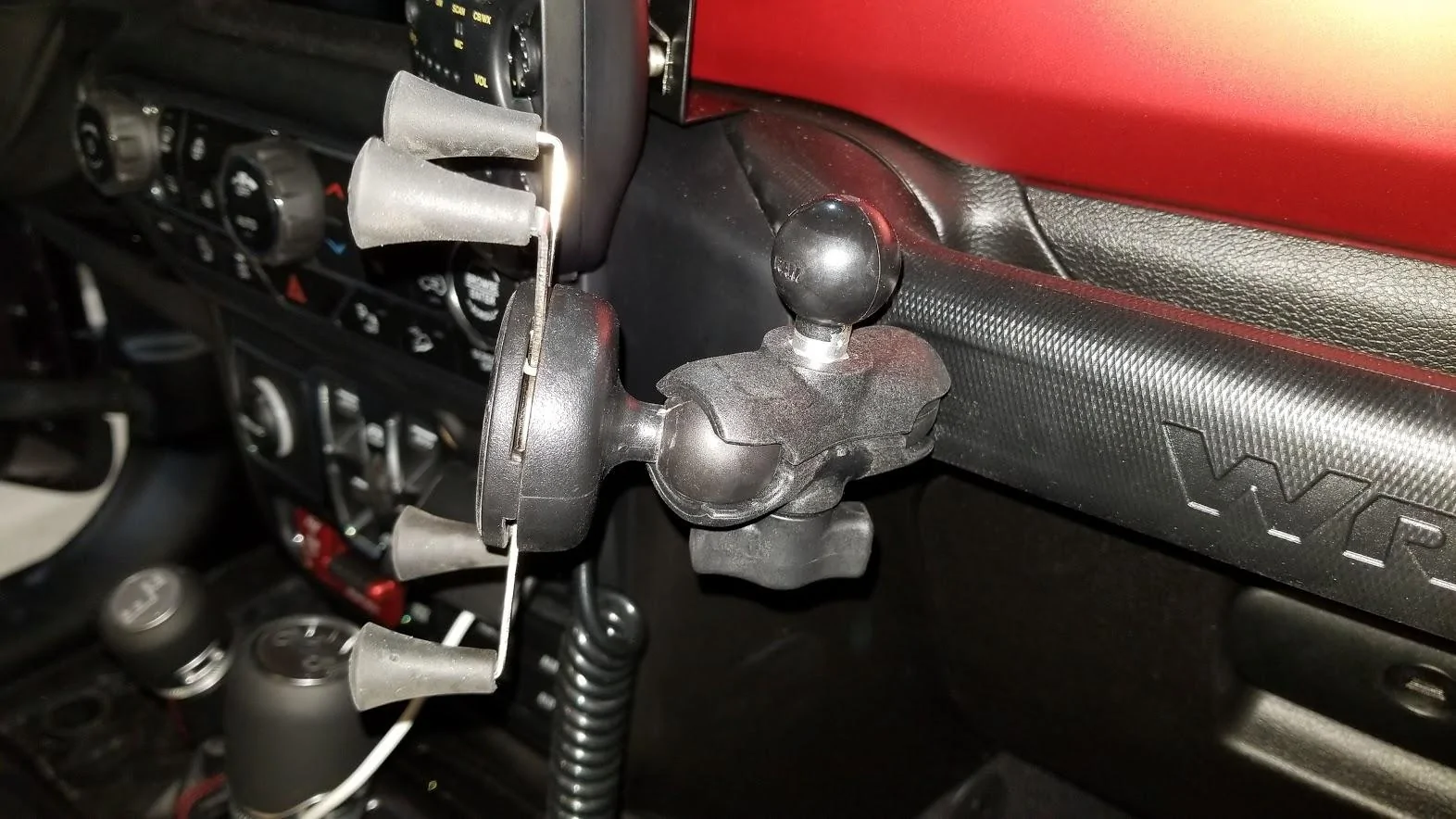

So i wanted to throw this out there
I did this for a cell phone mount for me but somehow my wife has taken this cell phone mount from me
Parts
Sheet Metal Screw 14x2
1/4" spacer that will fit in the ram mount (Not necessary if you can find a 14x1.75 Length Sheet metal screw)
Ram-B-367-UN7U Motorcycle mount with cell phone holder
OPTIONAL
If you just want the ball without the holder or extension this would be what you would need to run RAM-B-367-U
Installation
Unscrew the stock Hex screw and install the ball with the spacer inside.
