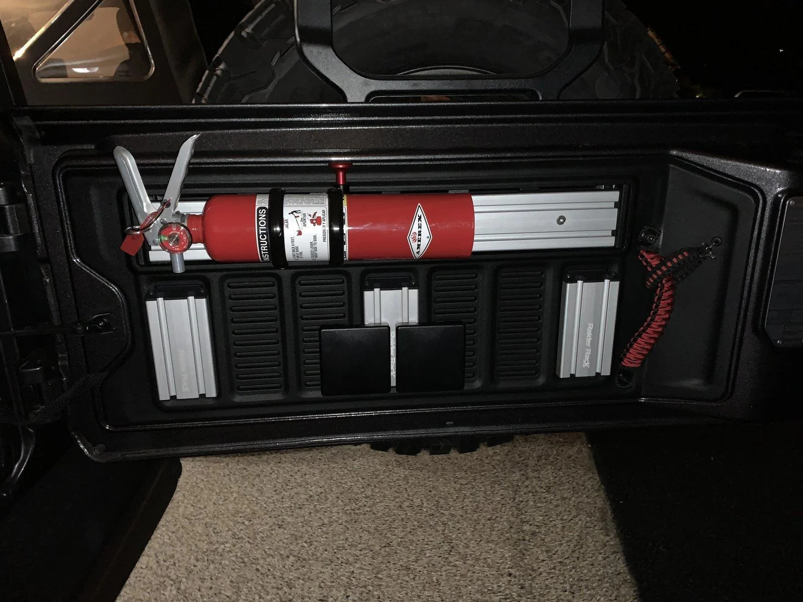

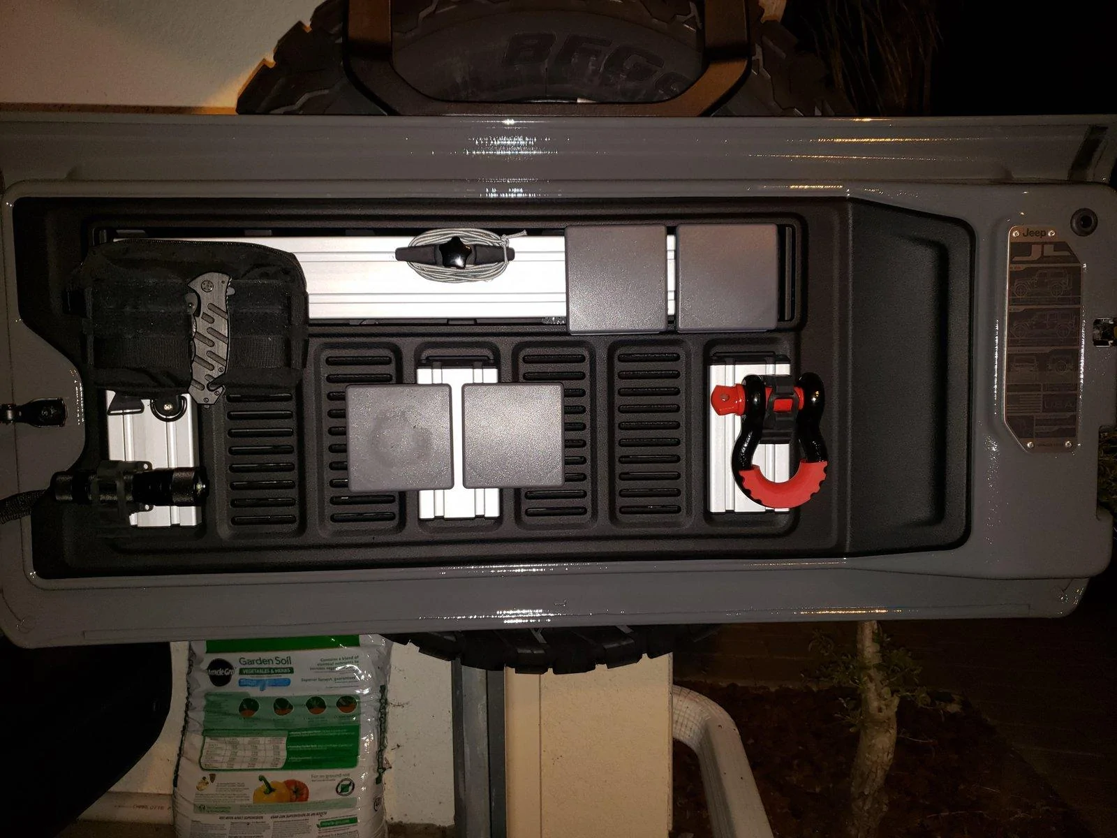

I posted about this elsewhere, but thought this deserved its own thread. I just installed this rack system (from RaiderRack.com) on the inside of my JLUR tailgate. This system includes a horizontal rack (similar to the TRMS rail) and up to 7 vertical mini racks that snap-fit into the lower louvers. Each rack has two t-slots, which provides some spacing flexibility when arranging mounting accessories. They also have some mounting accessories available, including just the t-slot hardware if you want to mount your own stuff (which I also did). I bought several pieces & some hardware, and grabbed some additional accessories online (cup holders & quick-fist clamps off amazon). That "indentation" on the top of the gate is a party-foul waiting to happen!
These racks are very solid, and the fit & finish are perfect. For the top rack, I popped off the tailgate's horizontal plastic cover and bolted the rack into the factory holes (There were some included spacers.) The vertical racks just snapped-in: insert the top at an angle, rotate the rack flat against the louvers, then push to snap it in. I couldn't remove them by hand, I needed a putty knife to pop them off from the bottom.
I'm very impressed. I'm still figuring out how to arrange everything, but I'm getting close. :)

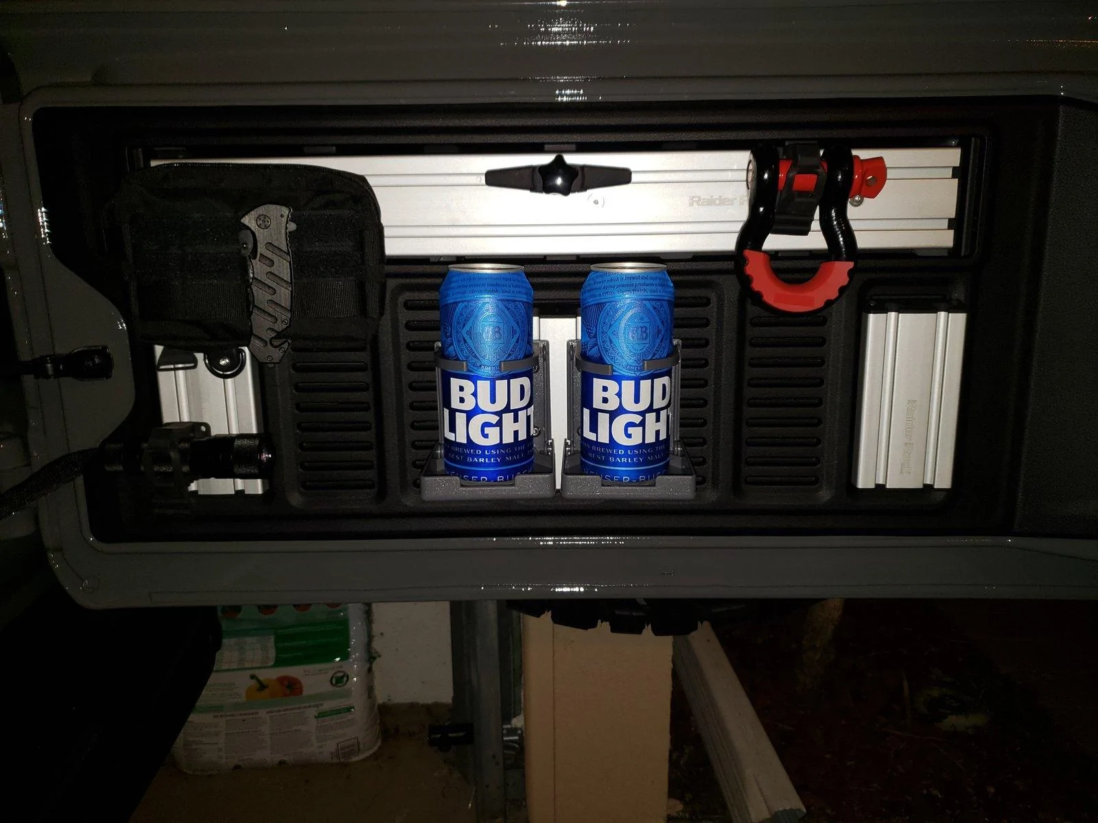

Thanks! I got the cup holders from Amazon here. The gray were $3.41 three days ago, but now they're $9/each. There are other colors for less, including black for ~$6. These might be had for less elsewhere.
