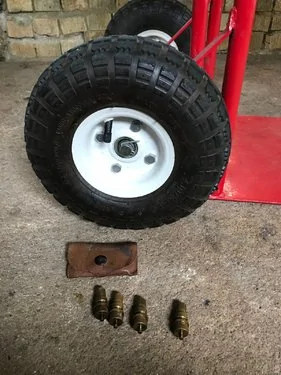

I have a set of STAUN Automatic Tire Deflators. It's time consuming to set or check tire deflators using the spare tire, so today I decided to use the small tire on my hand trucks and it took about 10% of the time it takes using the spare tire. I aired up the small tire to 40 lbs in about 2 seconds (make sure the tire you use can take the pressure you need) and aired down in just seconds to check the deflators. Worked perfectly
