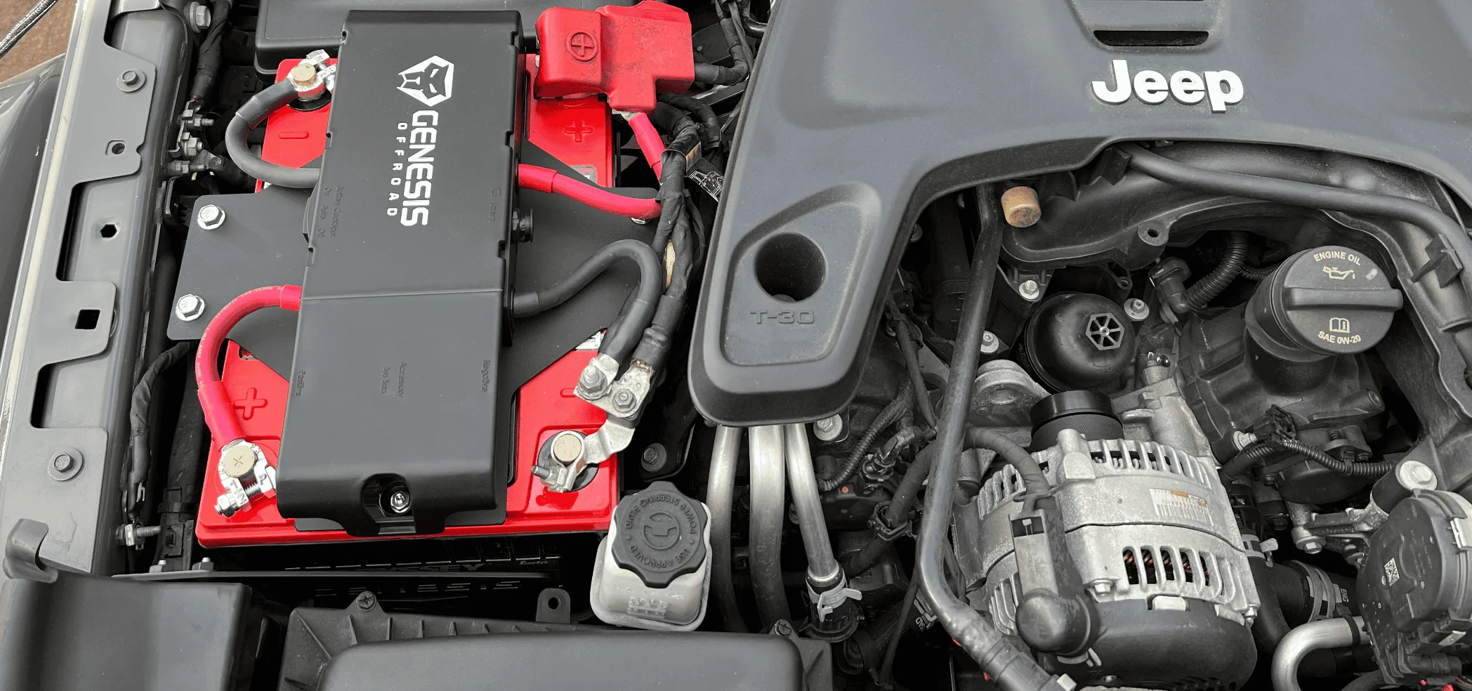

Not a day goes by where I regretted getting the Genesis system.
I know it may be overkill for some folk but the perfect set up for others.
Genesis did a tremendous job fabricating the set up: clean and functional

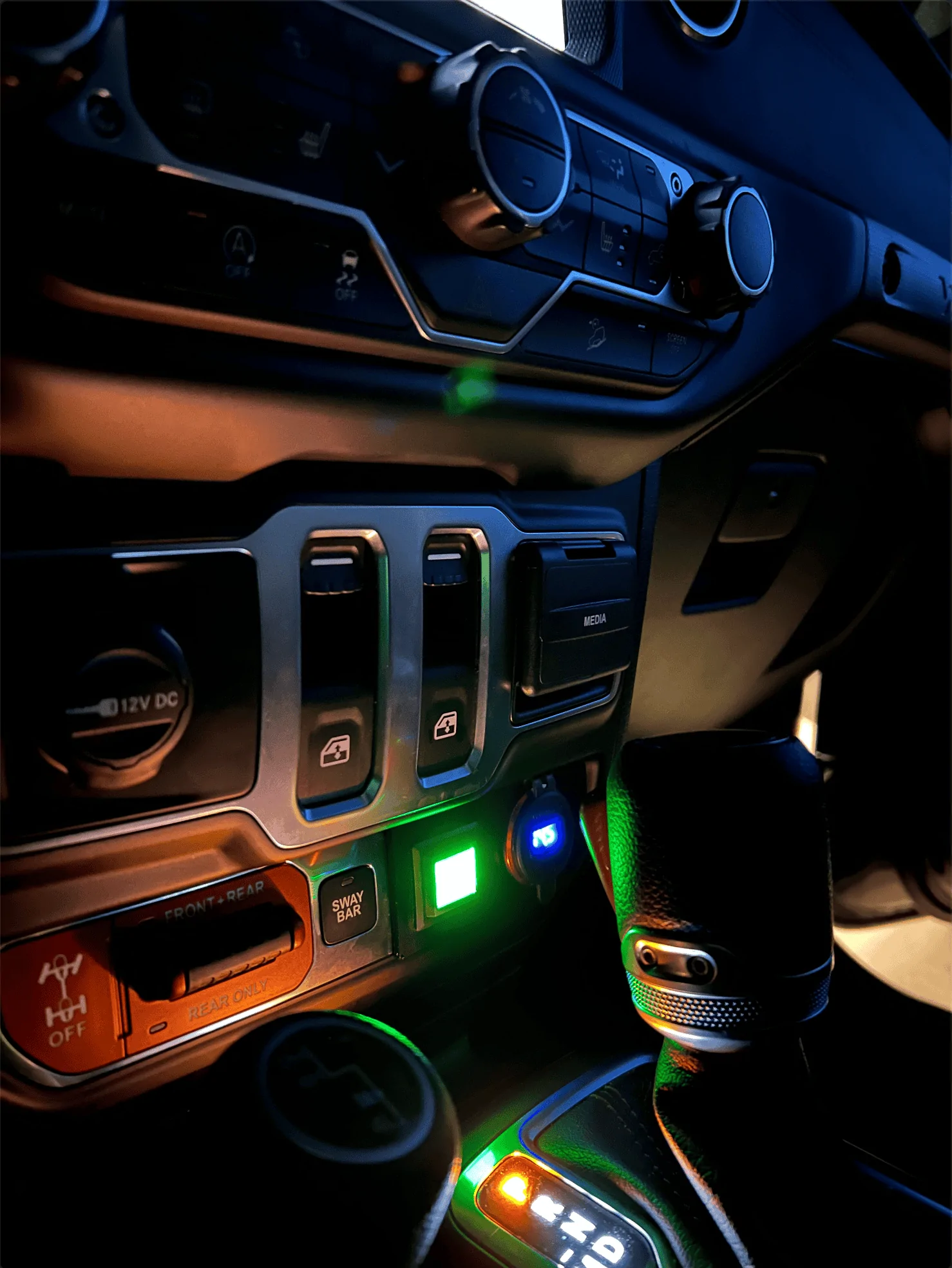

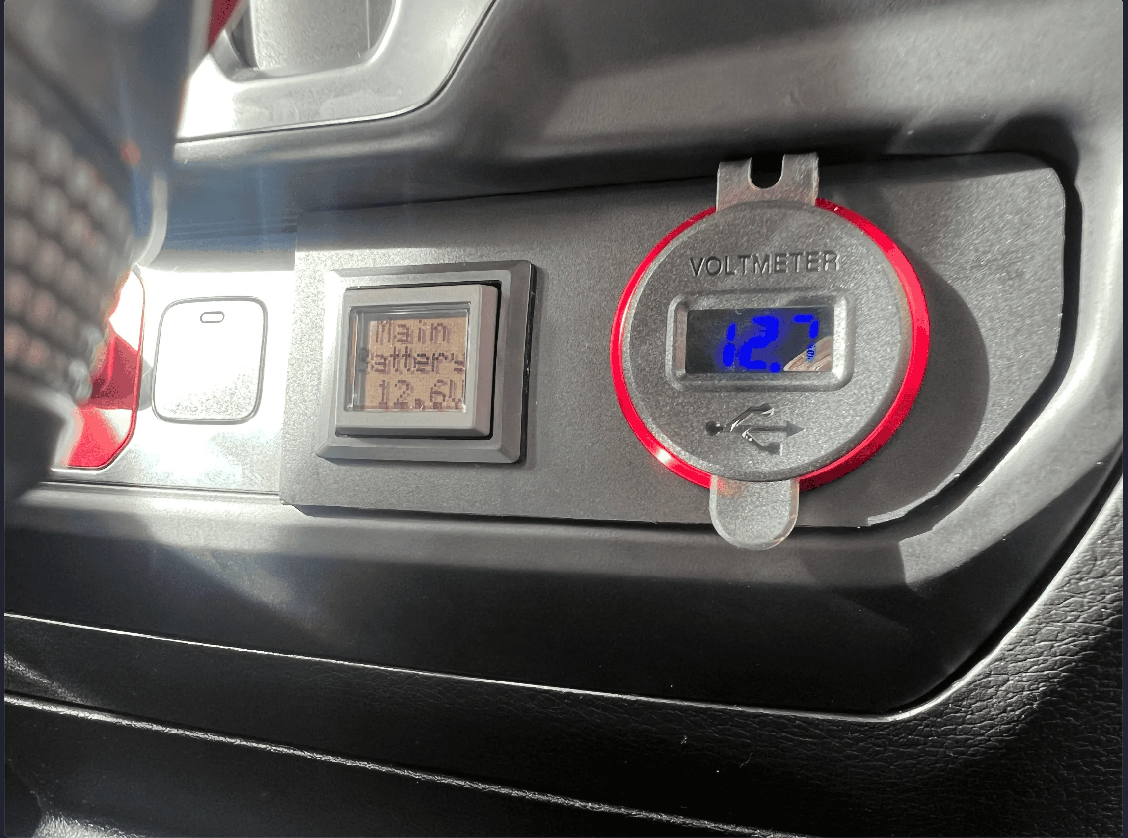

Also, highly recommend getting the G screen to monitor battery levels and be able to 'jump start' yourself from inside the cabin.
I mounted my g screen to the right of the locker switch since I ordererd my Rubi without the AUX switches ?

That definitely looks like a nice setup!
I like the fact that I can connect my direct battery connections underneath that battery cover they have (would be worth it just to clean up the mess of wires I have ?).
That G screen is a nice feature, but sure is bright! Is there a way to dim that? I’m half blind (for real…lost the vision in one eye) and don’t need any more bright distractions in the cab. I like how you can jump yourself from inside.
What about the voltmeter? It appears you can still flip that up and use the USB connections still?

You can dim it ? But also the light doesn't stay on forever. It stays on for 45 seconds everytime you press on the screen and then it will look like the 2nd screen I posted.
And yes, i added an additional volt meter/more usb ports. I only added it because there was still plenty of space on the panel when I added the g screen and I didn't want to center it. Now I dont have to flip through the screen and can see both the AUX(g screen) and the MAIN(usb volt meter) voltage levels. Plus volt meter is red so it matches the locker switches nicely ?
