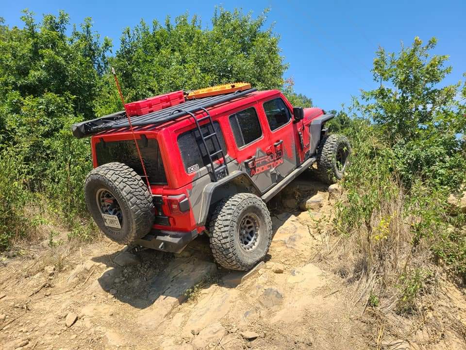

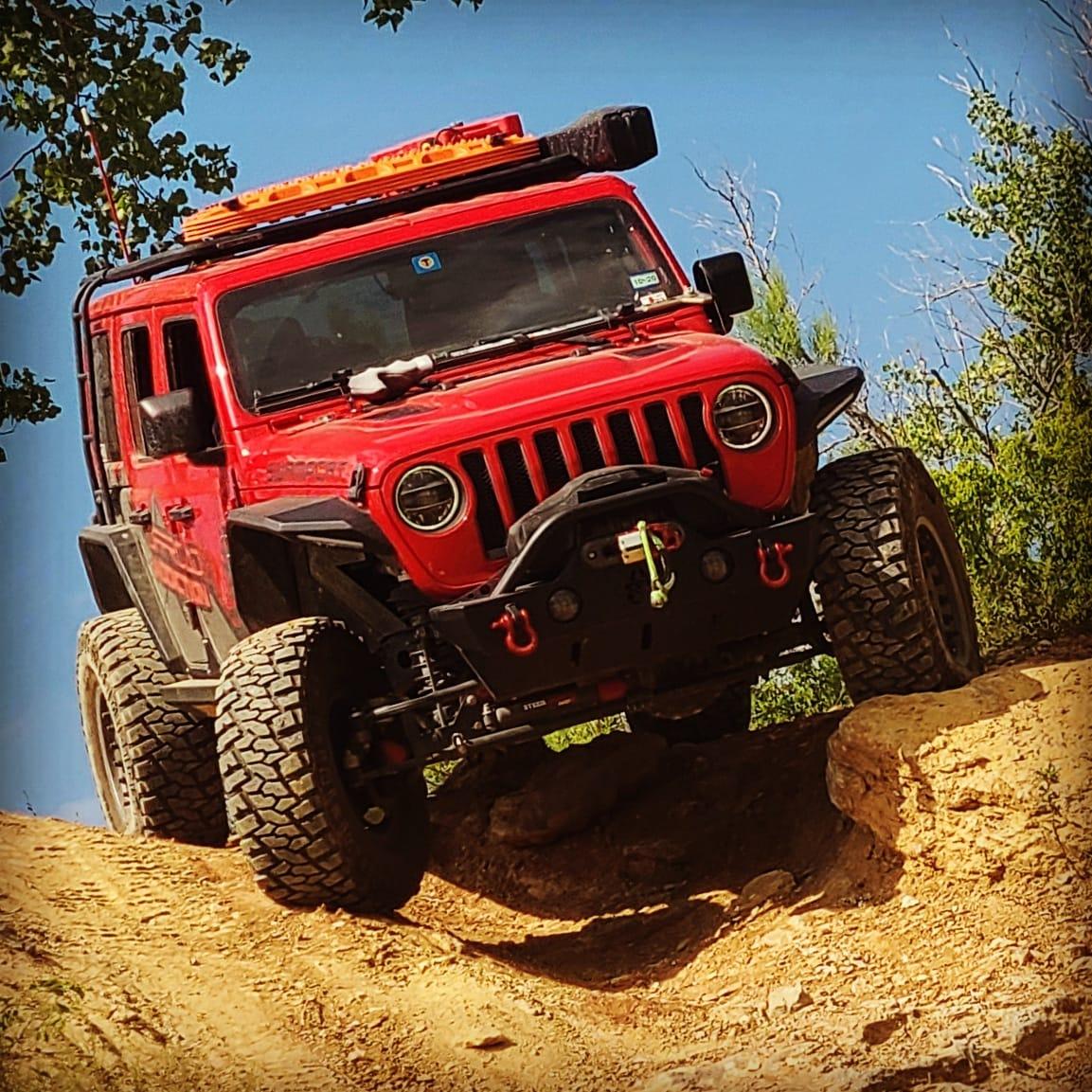

Spent some time playing at Northwest OHV in Bridgeport, TX yesterday. I'm ashamed to admit it's been over a year since I've hit any trails. It was great to get out again. Didn't get many pics cuz this trip was mainly for me, but here's a few.
Jeep Wrangler JL Project SWAMPCAT swampcat at northwest OHV
Jeep Wrangler JL Project SWAMPCAT IMG_20200802_112806
Jeep Wrangler JL Project SWAMPCAT FB_IMG_1596457067411

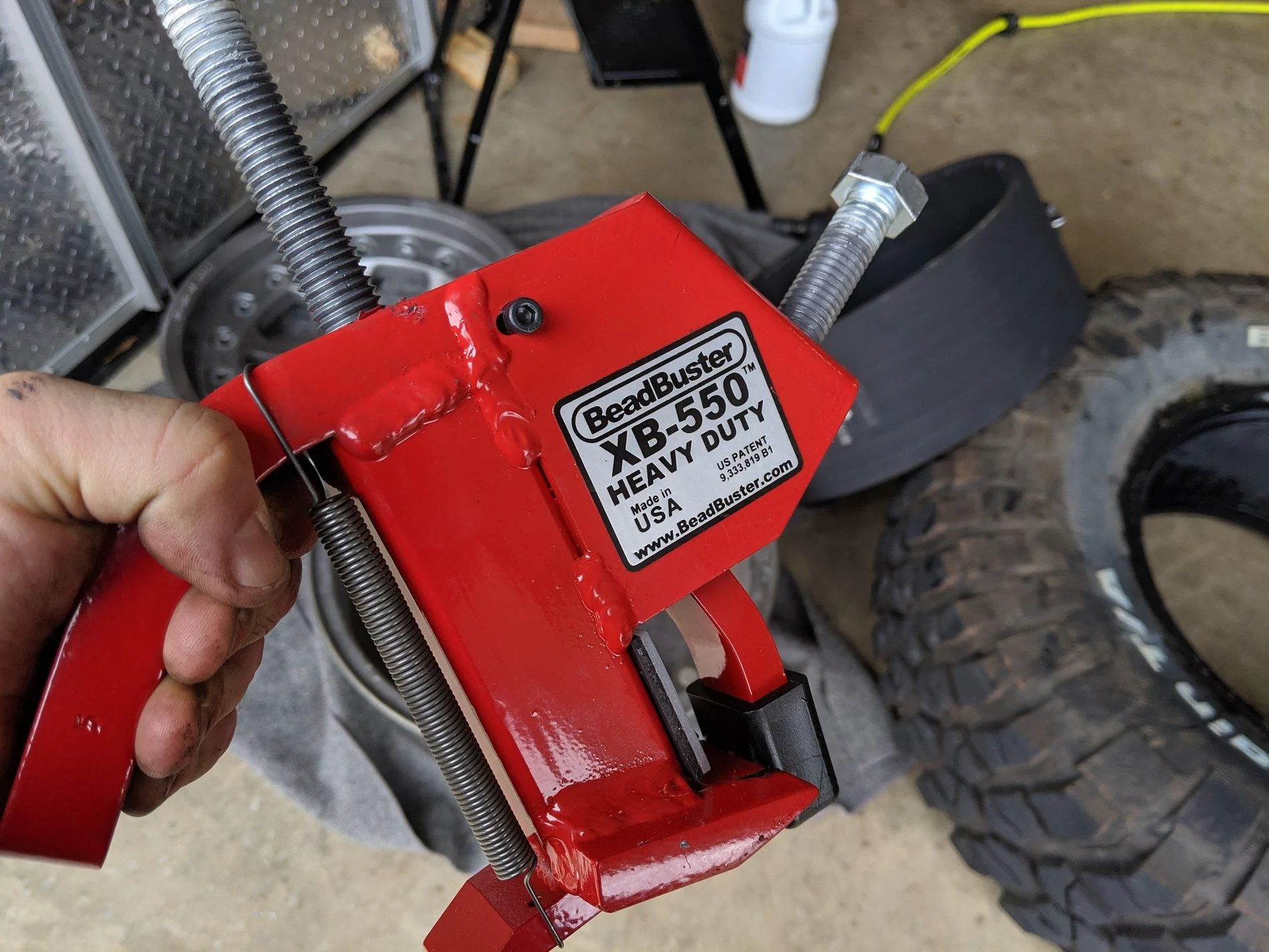

So, I started looking for a new option. That's when I found the BeadBuster XB-550. This thing is awesome! Here's a quick video of it in action. It can bust ANY tire, can be operated by electric, pneumatic, or hand tools, and is small enough to carry with you on the trail!
Jeep Wrangler JL Project SWAMPCAT IMG_20190509_135609
After finding the XB-550, swapping out these tires was a piece of cake. I had all 5 done in about 1.5 hours. Then, after a quick trip to the dealership to get them balanced, and we were all set!

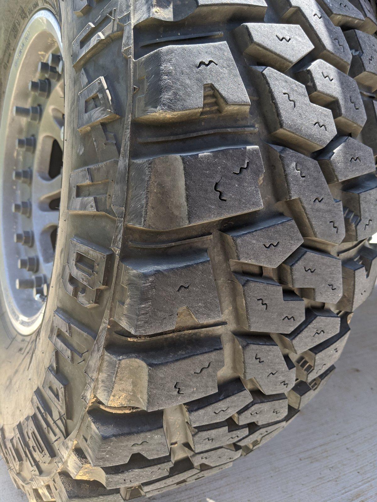

Since then, I've put 20,000 miles on these tires over varied terrain. Mountain passes, water crossings, sharp rock, a little sand, mud, and of course plenty of highway miles. I must admit that I was a bit apprehensive about their 2 Ply sidewall, even though DC says it has "Next Generation High Tensile (HT) Body Ply Cord", but I'm happy to report that, despite a fair amount of trail scars, I've had no issues with them whatsoever. These tires are solid. I didn't measure the tread depth when they were new, but they currently have 3/8" of tread left, which I think is pretty good for M/Ts over that many miles. They do make a bit of noise (as all M/Ts do), but even on the highway I can't hear them from in the cab with the windows up and the radio off.

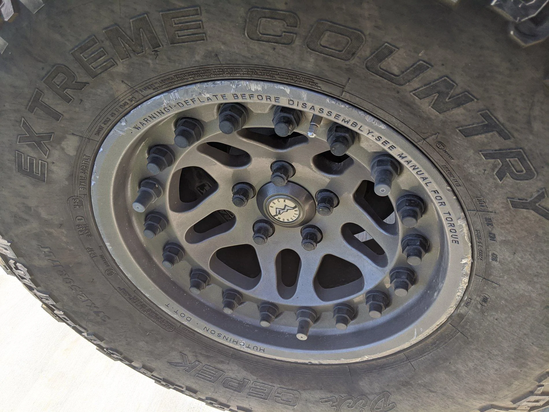

As for the wheels, I mean, they're Hutchinson Rock Monsters... what else do you need to know? Haha. Seriously these wheels are fantastic. DOT approved, two-piece, true beadlock, easy to assemble/disassemble (especially with the XB-550), compatible with TPMS, and they look awesome! They are heavier than some other options out there, so your gas mileage will suffer a bit, but that's an acceptable compromise for me, personally. AS for trail damage, sure they've suffered a bit, but they just take a lickin' and keep on tickin'. Scratches just add character, am I right?

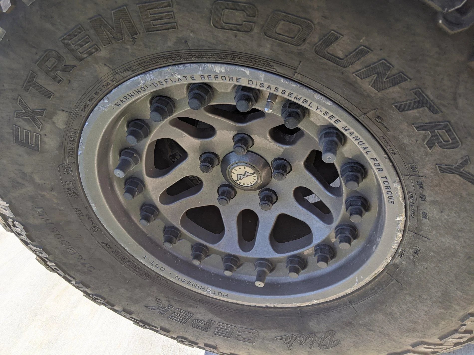

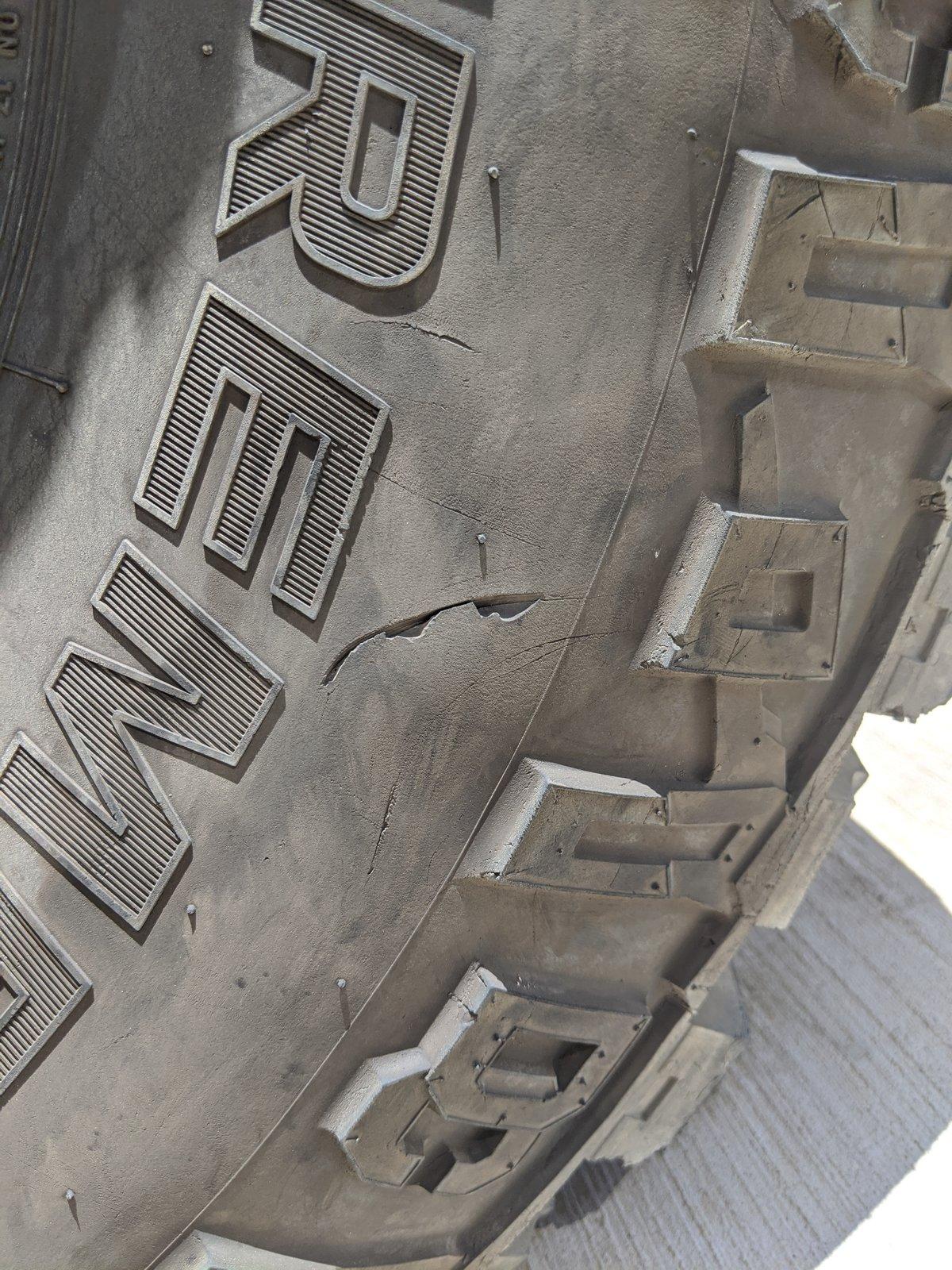

A few more images of the beating my wheels/tires have taken...
Jeep Wrangler JL Project SWAMPCAT IMG_20200812_130431
Jeep Wrangler JL Project SWAMPCAT IMG_20200812_130702
Jeep Wrangler JL Project SWAMPCAT IMG_20200812_130527_1
