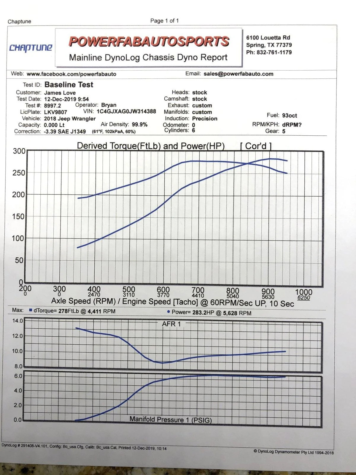

Here are the results of my Dyno tune with Prodigy’s tune. Judge for yourselves. Would you pay$10,000 for this?

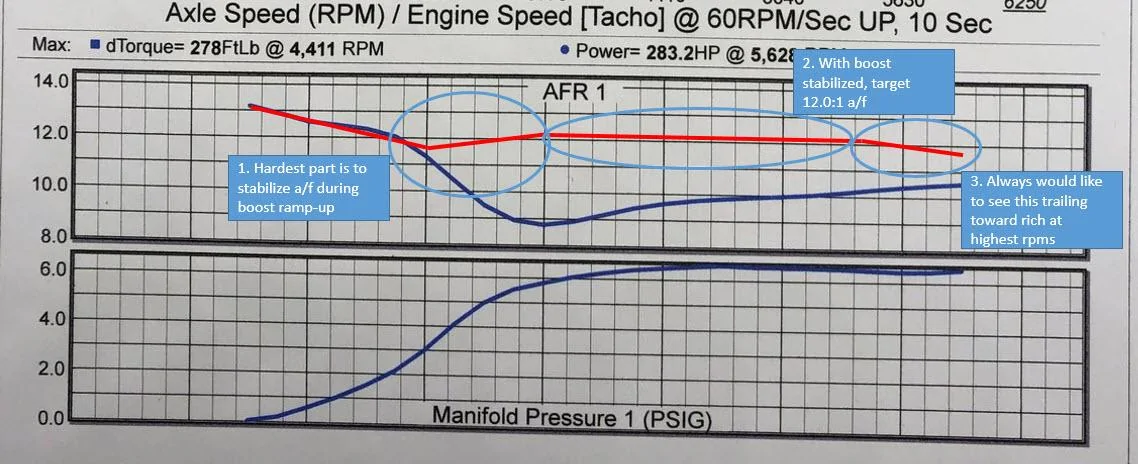

OP - thanks for sharing - and thanks for including both A/F and boost tables as it it impossible to make a judgement without those. The good news compared to previous posts from other users is that it appears that boost pressures are now completely under control. That boost curve looks very nice and flat and almost at 6psi at 3800rpm is reasonable. All of that very good. (It is much tougher to start dialing in a/f's when boost is not stabilized.)
Your AFR's while safe (better than the alternative!) are too rich. Ideally, you ever want to be richer than 11:1. The ideal A/F graph would be a flat line at 12:1. You'd probably pick up quite a bit of power.... but recognize that you are playing with fire. I think this is a further illustration of what I was mentioning in the previous post. Because the tuner doesn't have detailed control, they have resorted in providing something quite conservative (rich) and probably overly so. As a tuner, you would ideally like the slope to be trending toward rich, not trending toward lean (although you are no where near lean!)
I've drawn what I believe would be an ideal (conservative) curve in the pic below. Your tuner knows this... no doubt. Knowing what they want and getting there is two different things.

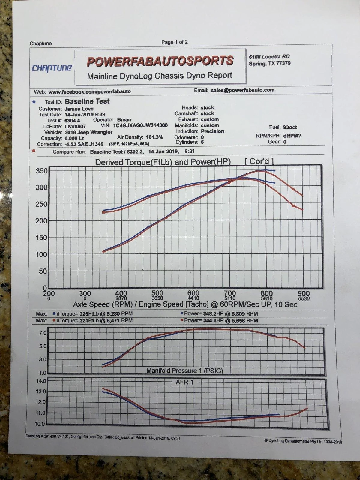

Now I understand why my gas mileage has dropped so dramatically. I am currently only getting 14.5 mpg. I don’t know if you saw my previous Dyno but I have included it below. I am considering writing the ECM portion of this tune while keeping the TCM portion of the tune. What do you think? This Dyno was done under the exact same conditions as the current one. However you may notice somewhat of a shift in the rpms. This is due to the differential ratio having been changed from stock 3.45 to 5.13.

Under most "normal" driving scenarios - say roughly less that 50% throttle, your ECU is in "closed loop" state. It is pulsing the injectors, and checking the O2 sensors and keeping AF's right at 14.7:1. It is doing this several times per second. 14.7:1 is ideal for best (most environmentally "clean" burn.) So, turbo or no turbo if you are driving very conservatively or at a steady state cruise - you remain in closed-loop and your tuner has no way to change that. Your mpg for all of this driving should remain unaffected. (Note that if at any time the ECU cannot attain 14.7:1, it will immediately throw a Check Engine Light.)
When you place more demand on the engine, it is important (for engine longevity) that the a/f becomes richer. Historically, traditional narrow-band O2 sensors can only report on under or over 14.7:1... so closed-loop mode will not work for higher demand loads. As such, the OEMs have pre-programmed tables (developed by static bench testing of the engines) and this mode is called open-loop. It is only these open-loop tables that a tuner can change.

Am I reading Jim's current dyno graph correctly and he's not even getting 300HP at the wheels? I really wish Prodigy would give us their side of the story here...

You are reading right. In fact I am only getting abut 275 RWHP. I was getting 350 from an independent tuner. But it was recommended to me that I should let Prodigy take over the tune completely because they designed the kit and they offered auto trans tuning as well. So I went for it. This cost me an additional $600 for which I lost power and gas mileage. I confronted them quite angrily and they responded also angrily. We now hate each other but I am stuck with a $10,000 turbo system which essentially adds somewhere between 30 and 50 RWHP. They vehemently argue that their turbo adds 20 RWHP per psi boost. They also advertise ~8 psi boost ut as you can see I only get 6. As measured every claim they make is at the least exaggerated and at most pure and simple false advertising.
