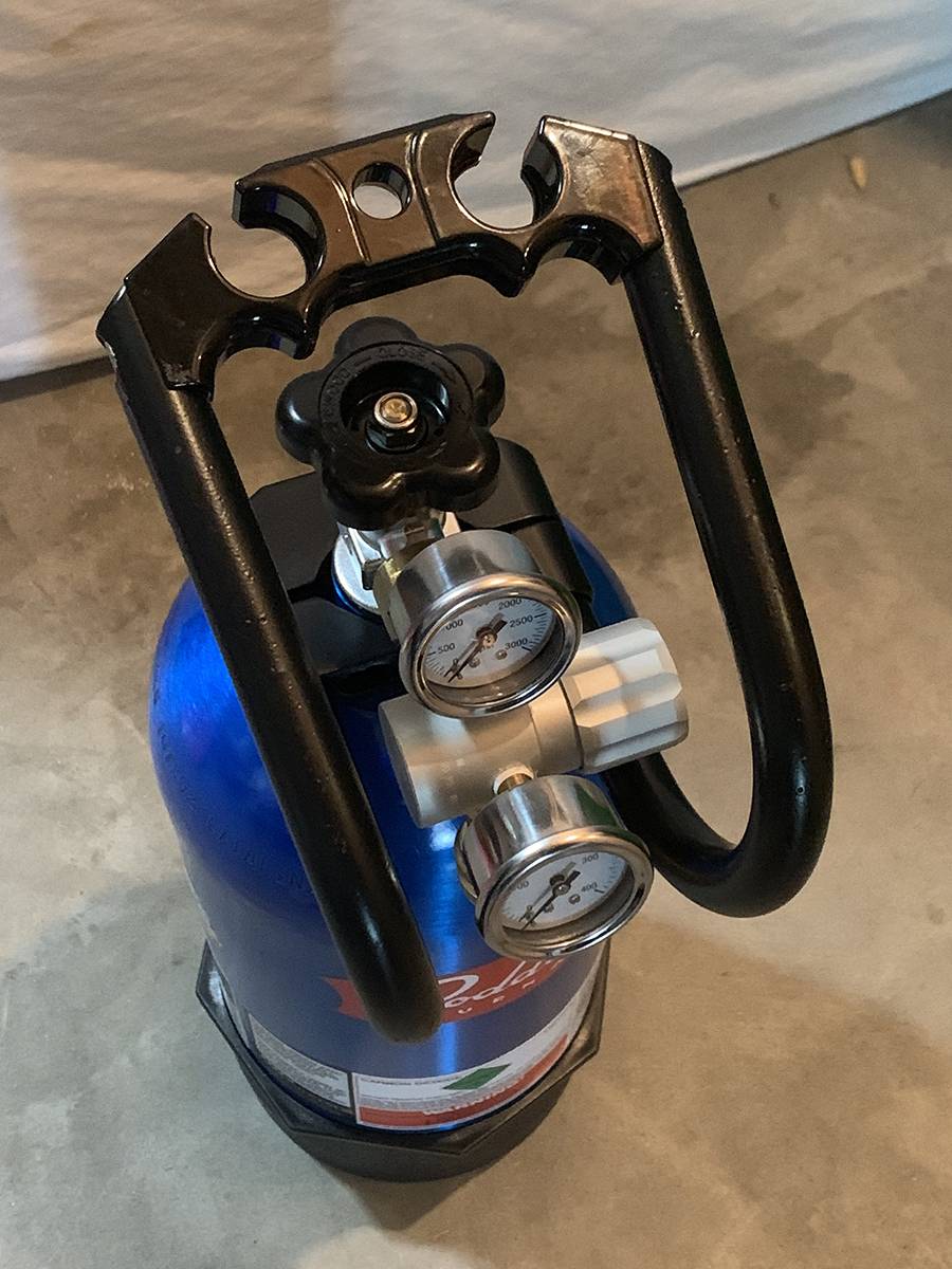

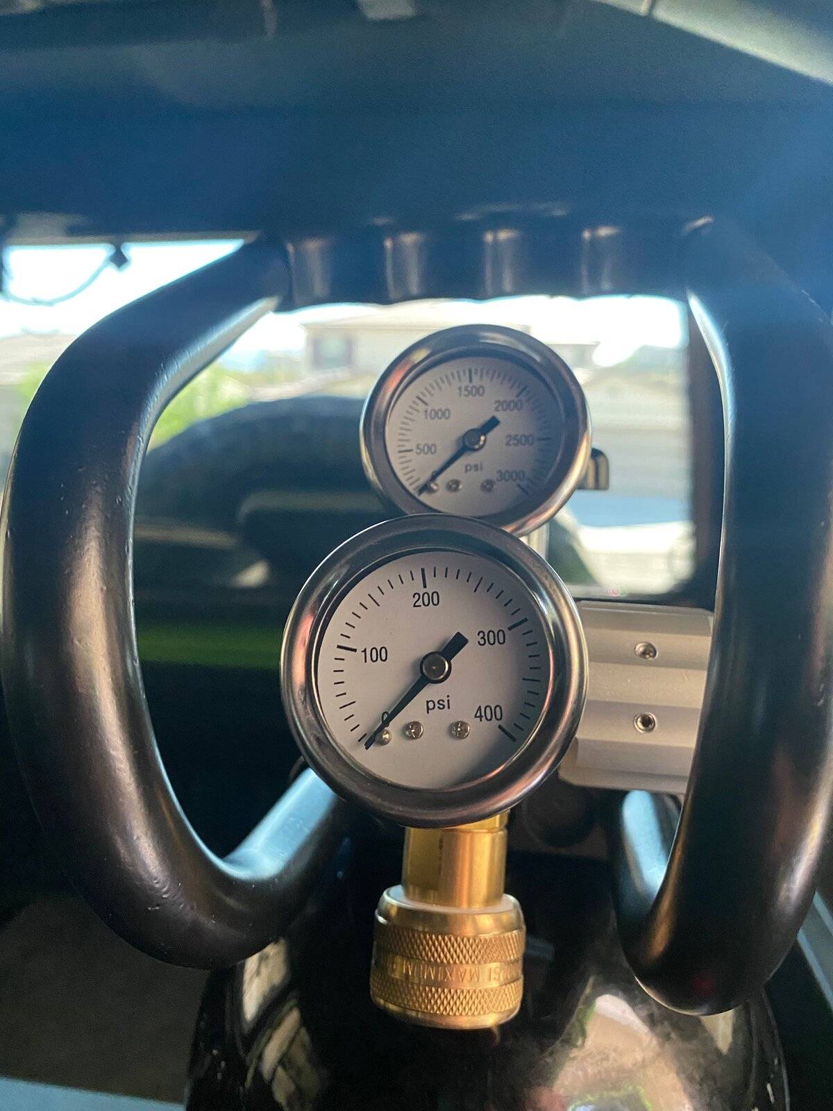

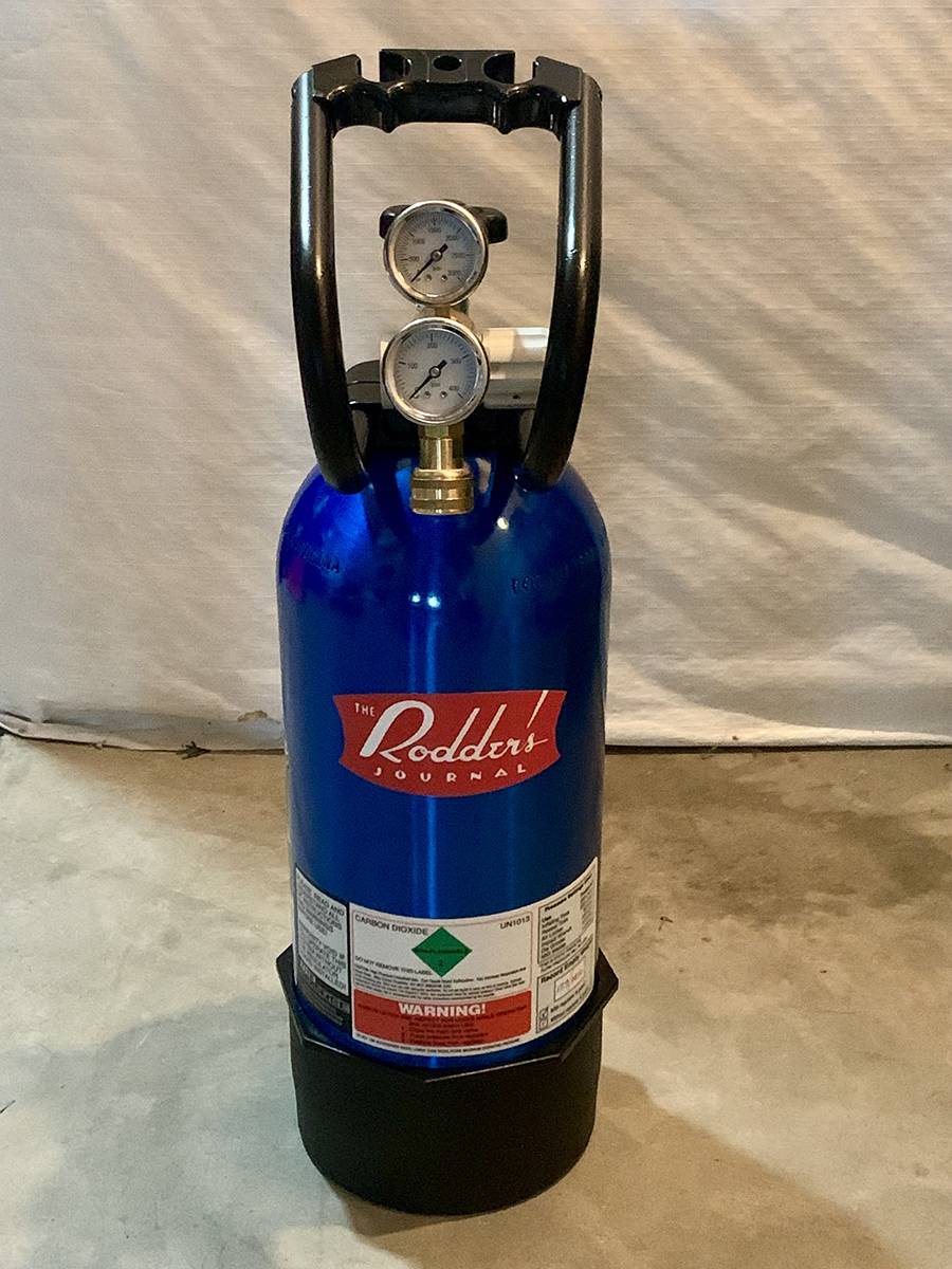

I ordered a 15lb CO2 system (with black powder coated aluminum tank), which included a 0-250psi adjustable regulator, 300psi digital tire inflator, 20' coil hose, handle, and mount for $453 shipped. Preece claims their regulators are non-freezing.

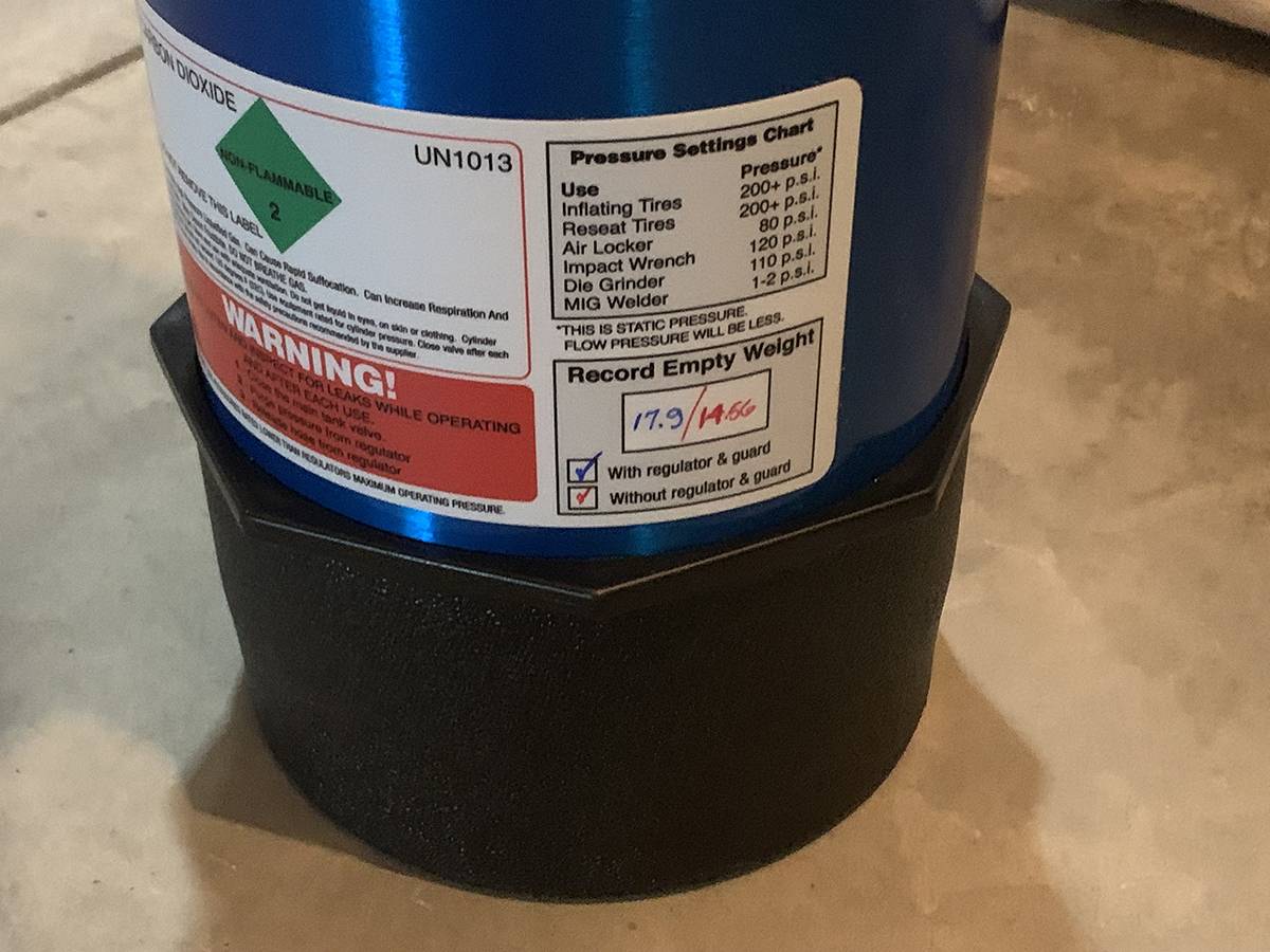

I received the order within 2 days and had it filled for $21. Initial impressions are very good. The powder coating is excellent, they include a nice selection of air chucks for filling various types of valves, and the hose and digital tire gauge seems to be a quality unit. The regulator has brass connections and a lightweight aluminum body.

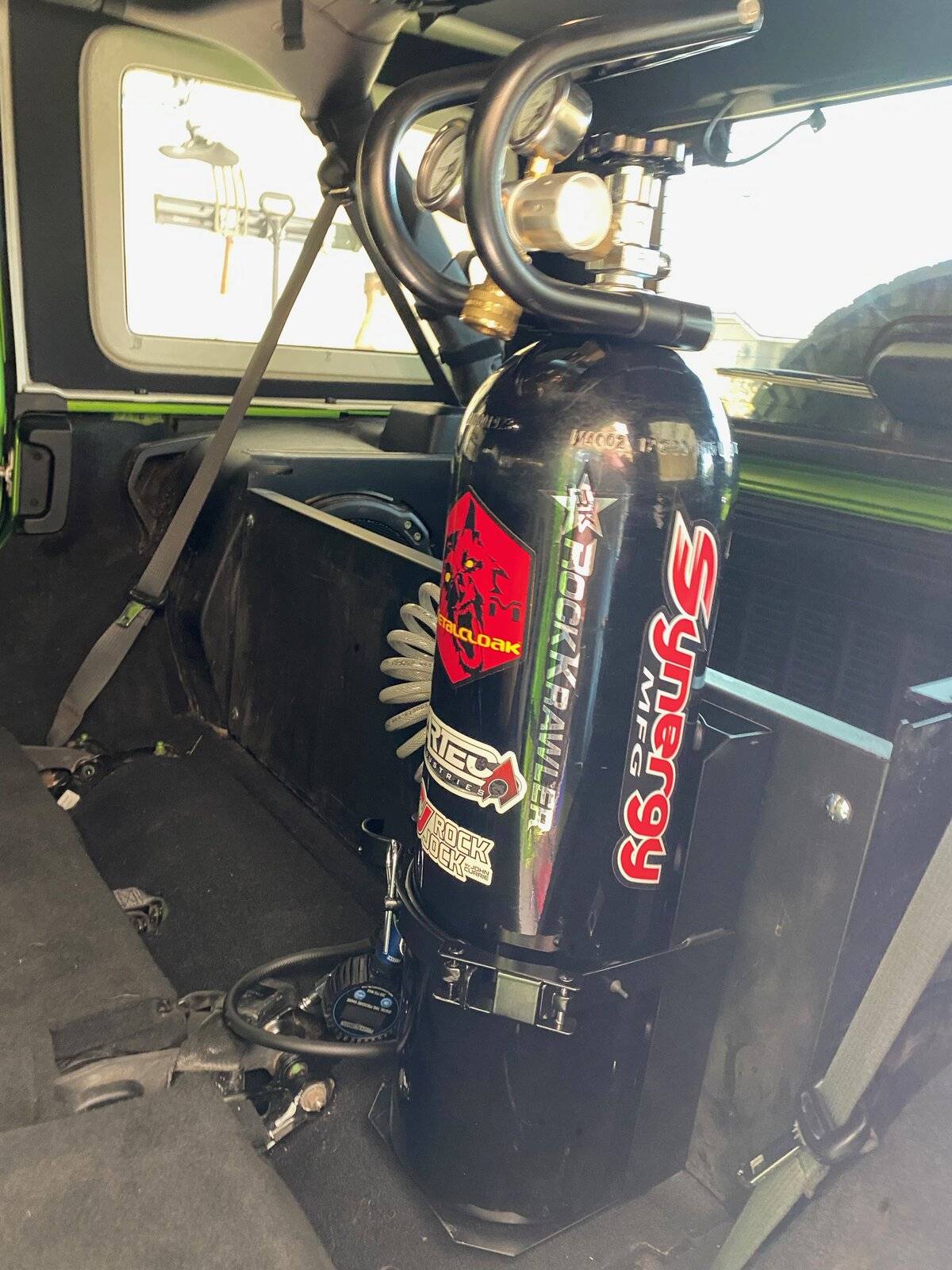

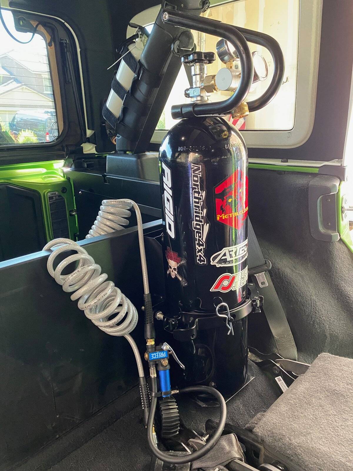

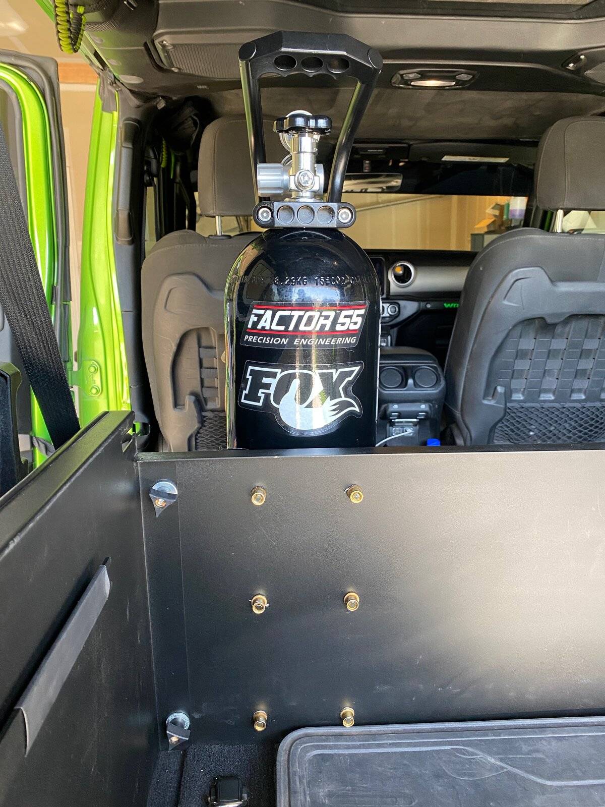

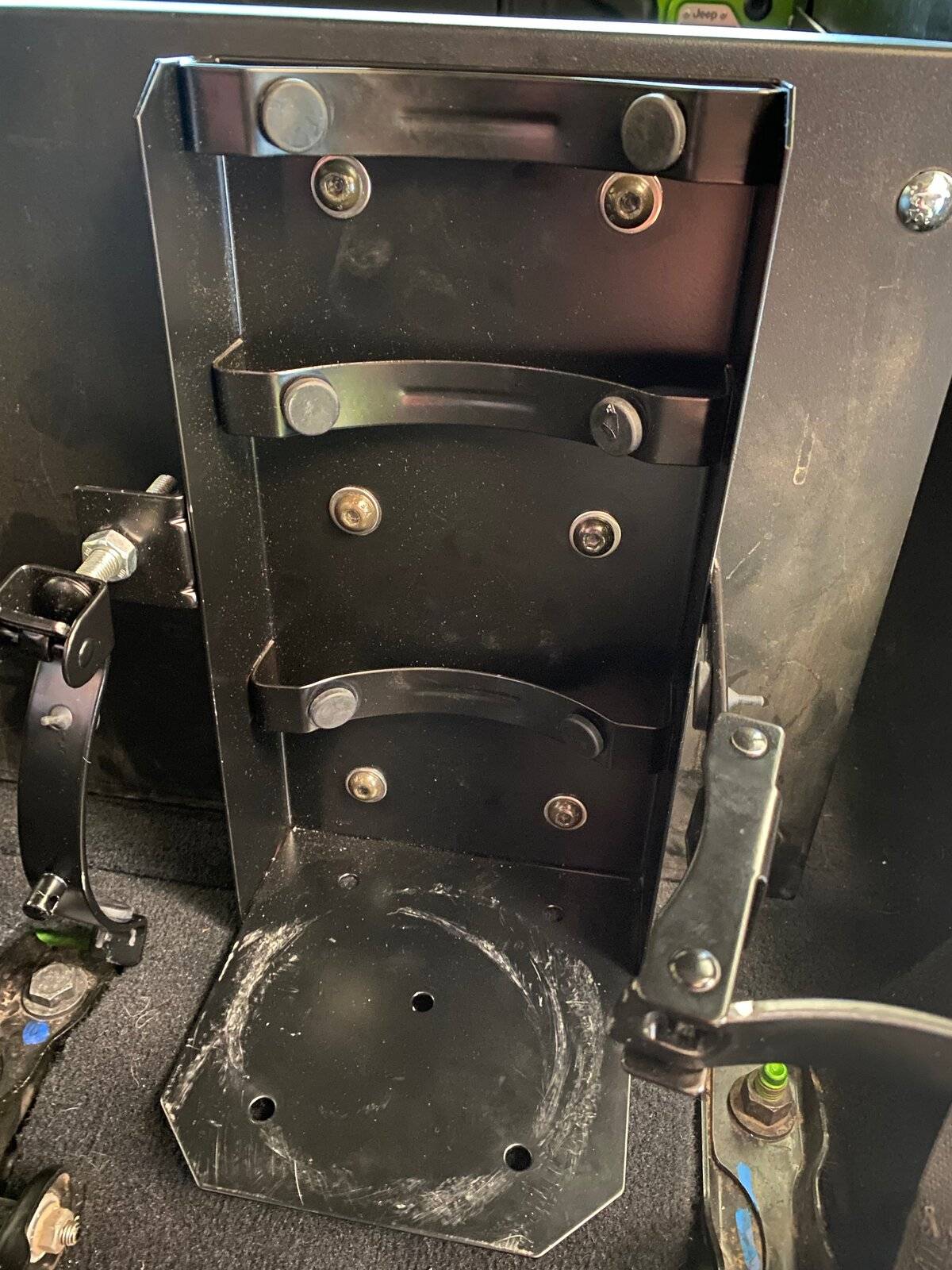

I installed the mount (which is a universal mount, not JL specific like the PowerTank BTS Bracket) on the backside of my Tuffy Security Deck. I used 3/8" rivet-nuts and bolts to secure the mount to the security deck (rivet-nuts and bolts were left overs/extras from my MC fender and fender liner install). I was worried the Tuffy deck would flex or rattle too much with the tank attached to it, but so far it isn't an issue. The bottom of the tank mount sits on cargo floor, so this also helps support it. The biggest drawback to where it's mounted is the inability to raise the back seat into the normal seat position. Since the tank will only be taken on off road trips, I'll remove the mount for normal daily driver usage.
