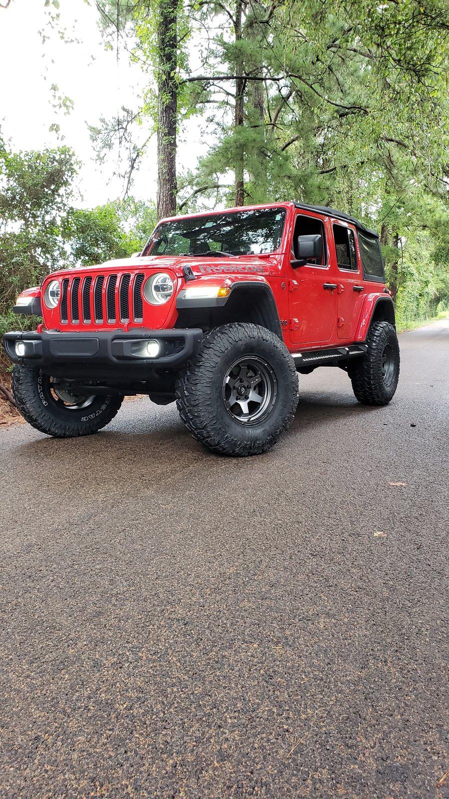

For all that own a powertank where did you purchase and what accessories(setup)did you get? I'm running 37x12.5x17

Nice milestars. What psi u running?
