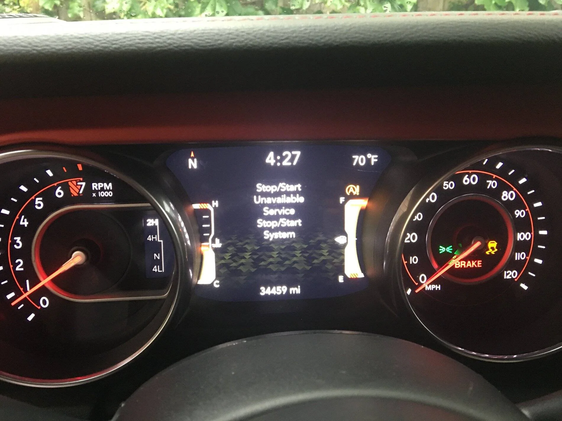

I don't have a tazer but I was searching this morning and found this thread. I had some weirdness happen over the last week...
- I used JSCAN to update tire size and TPMS settings about 4 weeks ago
- Did not leave OBD scanner/bypass plugged in - after I was done I plugged everything back in as stock
- this past Saturday I was driving down a narrow road and as an oncoming vehicle approached I got way over to the right in the snow where the passenger wheels were off the crown of the road and I had to turn the wheels significantly to the left to keep going straight. I had traction control off (do this all the time so I can have some fun in the snow :) ) - and all of a sudden I got the "Service stability control" warning on the dash - and the stability warning light came on.
- after 5 mins of driving on dry road the light turned off and I haven't seen it since.
- yesterday my wife sent me a pic of the jeep and the auto start/stop light was on - on the dash. She had not disabled it herself (she had no idea what the light was and was worried!)
- after turning off, getting gas, turning back on - the start/stop was back to normal with no lights
Anyways - just thought I would share as this may not be related to the Tazer at all...
